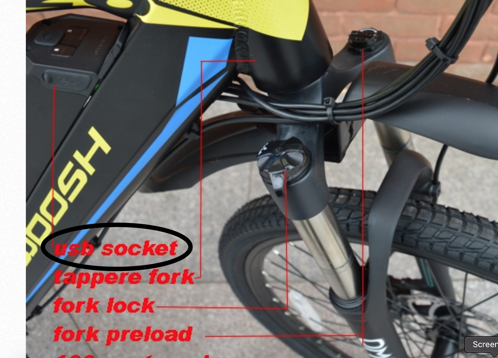

I am very sorry about this, the USB port on the battery is not connected.
The online manual has been updated accordingly.
Just bought a Rio and expecting delivery tomorrow , is the usb socket still not connected ?? if not that is very disappointing ..
I am on holiday at the moment - will ask Andy to check it for you.
ok, thanks.. will soon find out, will be delivered today, but it seems odd that Woosh advertise a feature that doesn't work, it's clearly pointed out in the Rio pictures with a big arrow. It's. like saying it has a nice bell but it doesn't ring or lights that don't work.. I've read all the Rio manual and can find no reference to it.
I can now confirm that there is definitely no output from the USB socket, which is rather disappointing ..
I don't understand why it is shown on the Rio pictures on your website saying that there is.. it's not a big deal but it would have been great if it was working.

Andy confirmed that the USB port is not connected.
thanks for reply,
I'm puzzled why this feature is clearly pointed out on photo of the bike, also puzzled why the battery manufacturer fits a usb socket but doesn't connect it..
thanks for reply,
BMW has a similar problem with its cars - they have indicators fitted but never seem to be used by the drivers...allegedly.:)
I don't want to disappoint you, but I'd take ant bet that the forks aren't tapered too.
not asking about the forks.. so you are not disappointing me.
the Dorado battery case has provision for a USB socket but the battery factory did not use a BMS with USB output.
it's only a detail but the RST Omega fork is tapered.
You can see the shape change at the base of the head tube. It's much wider at the base than at the top.
fair enough, but should this should not be pointed out in the bike description .. it's misleading to say it has a usb outlet without saying it's not connected .. reading the thread, Woosh have known about this for some time .. Not doing so also affects the reputation on the company and leads seeds of doubt being sown.
