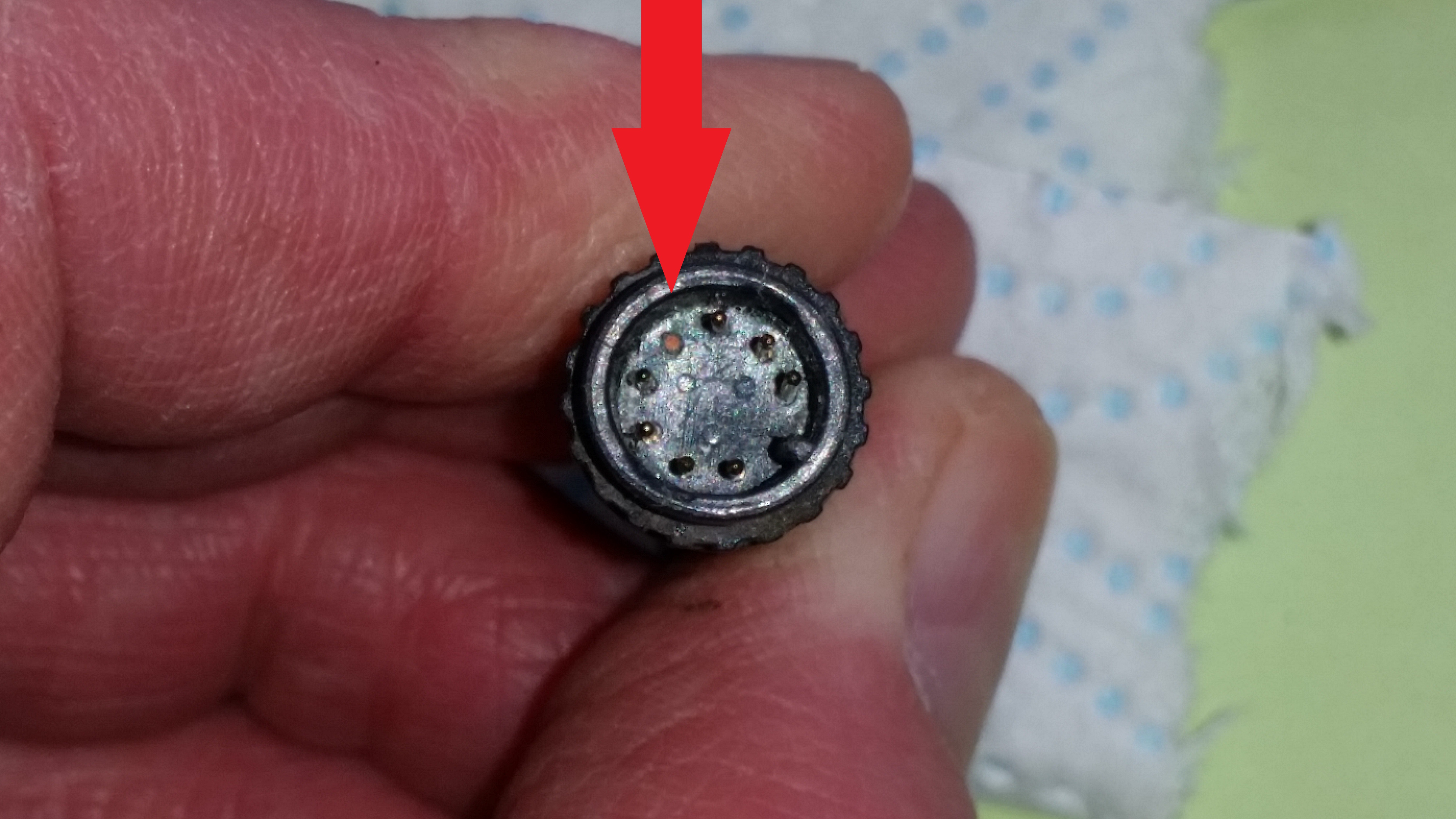

April 11, 20188 yr In the process of packing the cables away into the little Yose controller bag I then discovered I had bent two pins in the LCD-controller wiring loom. I fixed those with a delicate technical bend, and opened up the socket holes a bit with a safety pin, plugged together and tested again : lo and behold the motor comes to life! Hi Petebike - broken pins - this happened to me on my YOSE 4to1 cable - get in touch with YOSE or the supplier you got it from and hopefully they will send you another, YOSE did send me one after a few emails and pictures I did have to jump through hoops but I think that was mainly the language barrier- I really think the cables are sub par my original kit is dilleneger and their 4 to 1 cable was much better, I can vouch that the dilleneger PAS should work with your kit, I do believe they have not upgraded it yet, mine did and I did not change any settings. Dillenger brake sensors will not work with the YOSE only because of the 4 to 1 cable however the Dilleneger 4 to 1 will work with the YOSE apart from the brakes but then you could buy the dilleneger brakes sensors I have used this set up and it worked well! If that make sense! Oh just don't tell them you broke the pins because maybe just maybe it was not your fault lol, just tell them the pins have fallen out! I got this PAS from banggood and it works with the dillenger kit I have yet to test it on the YOSE however I did notice it was an nightmare to fit even using a 12 magnet disk (dilleneger) and it also activated when pedalling backwards but this was a quick test, oh and I had to wire up a julet connector as it comes with a JST SM 3pin easy to do I just wired up a julet to a JST and connected via the JST https://www.banggood.com/E-bike-Scooter-Pedal-Assist-Power-Sensor-5-magnet-Disk-Type-PAS-System-p-1032853.html?rmmds=search&cur_warehouse=CN Edited April 11, 20188 yr by PC2017
