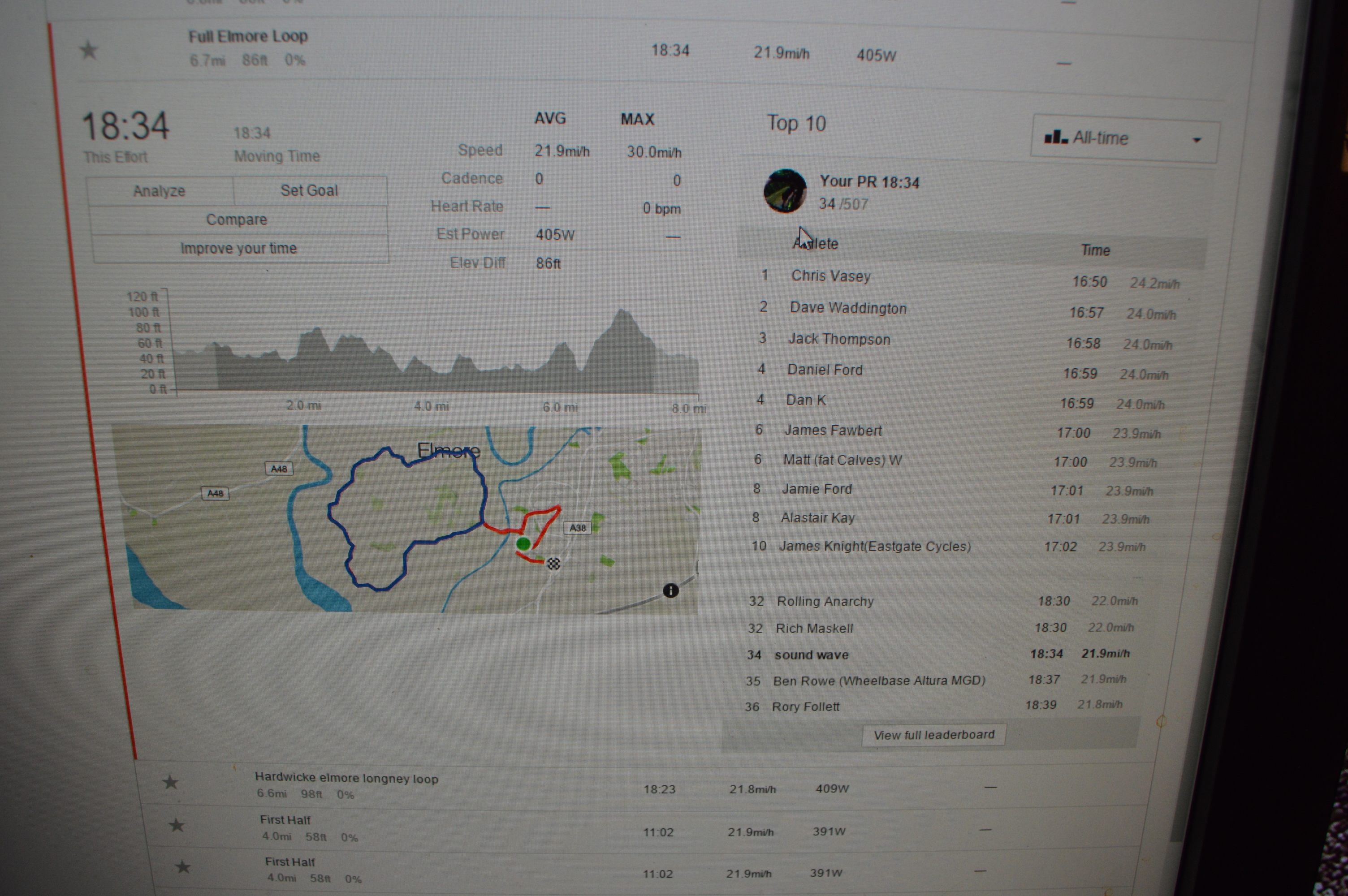

As a comparison, on my CX powered MTB, in turbo and on a dongle, I would cruise at 27mph. The motor seems to give significant assistance if I push harder. I only have 1 bar left on my battery indicator after 17mls however. I suppose the variables are the wind resistance of the bike and the amount of energy I am inputting into the system. I am not sure of my cadence however, I suspect I prefer high cadence. I have changed to an 18t front crank with a. 11-36t rear cassette on 29" wheels and I predominantly use the 3 smallest cogs.

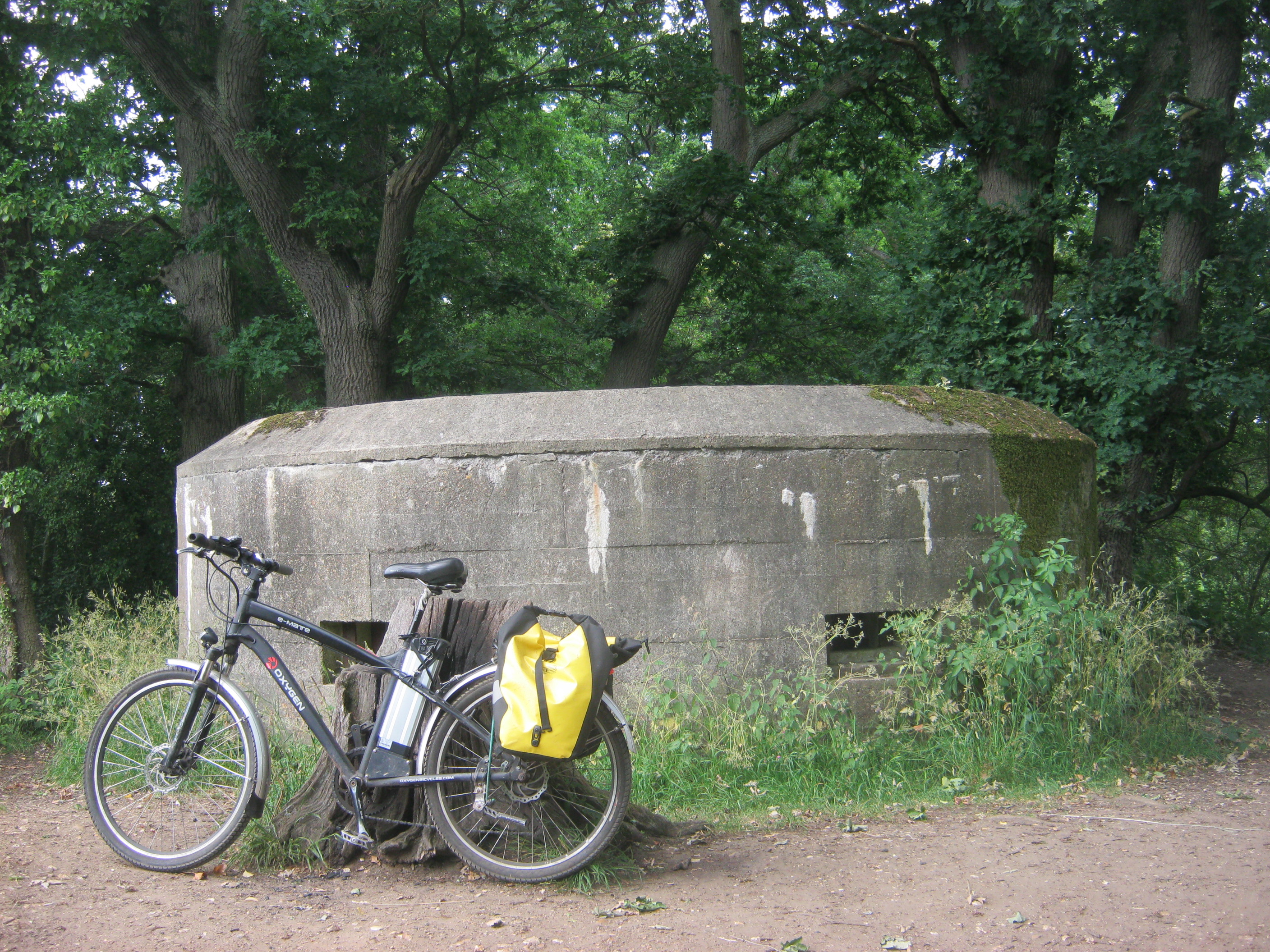

Almost by accident (quite literally) I have a Yamaha PU crank drive hardtail mountain bike and an old Oxygen hub powered Emate city.
To explain I was knocked off the Oxygen and the money I got from a personal injury claim against the driver bought my Haibike as well as a NASSA sized super gaming computer for my son (thanks dad, is this a good way of getting money? Could you do it again? No, not really son!) and most of a seaside holiday, bing money gone! easy come easy go although not that easy, smashing into the side of an Audi (made a very satisfactory sized dent in it, but mostly with my body!) then sliding down the road in shorts and a T shirt.
At 27 miles one way your commute is near the limit of what is regularly possible with current battery range travelling around 20mph average.
As your commute is on mostly level roads this is the perfect environment for a good quality de restricted hub drive like The Oxygen. You will get many fewer maintenance issues with the drive train and as discussed a cadence system is more relaxing and easier to access the power with as much or importantly as little effort as you feel inclined to provide.
However crank drives feel more natural by making you work the pedals to access the power and are better hill climbers. They really excel off road where they can tackle challenging terrain.
I have now started using my old Oxygen again for my 20 mile round trip to work when I know I am going to be road riding there and back, and my Haibike when I am using a longer off road route to work (14miles) and then returning on the 10 mile road trip. The Haibike really only gets used for commuting to work and The Oxygen is used a lot at home for shopping and errand trips into town and back.
I appreciate I did not have to buy my second e-bike with saved up money but I now really appreciate having two different types of bike to use, and it is always good to have a back up bike for my commute to work if something happens to either one of them.
I actually love them both and have been commuting by e-bike to work 98%+ of the time (I check the weather and occasionally dip out if it is forecast to cane it down), a minimum of 20 miles a day for my 4 day working week since 2011 and really love it and at over 56 now doing a sedentary sitting down job really benefit from the exercise, though it is the off road ride to work that I enjoy the most.
Biketoworkpostbatteryconnectorreplacement001.thumb.JPG.5b5eb888d61a1a763abff304ef719051.JPG
I used to love mountain biking before getting an e-bike so mountain biking to work on a 14 mile almost completely off road route including some challenging single track is manor from haven.
Although both my bikes have been in my opinion really reliable on the whole they have both had issues that needed to be resolved and certainly the crank drive, drive train needs more attention and earlier replacement than the hub.
I bought the Haibike in March 2015 and it has covered 9668 miles so far and I have not kept count of the milage on the Oxygen but it has to be quite a bit more. What is not to like?
