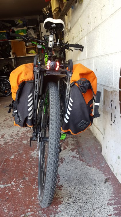

I have used both HT and FS for road riding..
HT .. Generally a bit lighter, may have mounting points for guards, rack and kickstand but I have jarred my back a few times when hitting a pothole I hadn't seen.
FS.. Generally a bit heavier, wont have any mounting points for guards etc but oh so much more comfortable and relaxing to ride on bumpy roads.
In my case I now have an FS bike and have been able to fit rudimentary guards, a rear rack and panniers and auto lights that come on when it gets dark but a kickstand hasn't been added as yet..
2018-07-2510_00_37.thumb.jpg.d098c60618baca37e351c0a6009cc249.jpg 2018-07-2510_07_42.thumb.jpg.daa775fbefdb8f04338fb6f0501304f4.jpg 2018-07-2510_07_58.thumb.jpg.01980346f4ad1e5991c94a7cf3498ab2.jpg 2018-07-2510_08_26.thumb.jpg.21adc65d7403ad624a64dc14b08f787b.jpg
[ATTACH=full]25957[/ATTACH] [ATTACH=full]25958[/ATTACH] [ATTACH=full]25959[/ATTACH] [ATTACH=full]25960[/ATTACH]
thanks for youR reply and photos, very helpful. What rack and mud guard are you using on the FS, that's thumbs up for the FS then!
Definately a thumbs up from me for FS over HT.
Unfortunately good stuff isn't cheap and to fit both need a bit of modification because they both needed the same area on the stay to mount to. Got around this by using the rack mounting bars the wrong way around and permanently removing the rear reflector which i must say I didn't like doing on an expensive item, especially as my diy skills are not to A level std. End result is sturdy enough to carry 4kg in one bag without issue.

The Thule is about €75 from bike.discount, don't forget to order 2 sides for panniers. I also bought pair of quality Vaude panniers(2x24L) for €75. Thule rack is weight limited to 11kg compared to 25kg racks on most HT racks. Shouldn't issue for commuting.
See my Powerfly 7 HT review(review section) for full mudguards, SKS do 27.5 set. Front will work FS, might be able to make rear work, at €10 cheap enough to try.
Head light that runs off bosch system should be straight forward. Both Bike.discount and bike24 do bosch cables and good range of lights (€20-€300).
I'd fit quality usb chargeable tail light to rack instead of Bosch powered one, no cables to disconnect if removing rack.
Ask shop to enable lights and walk mode (trek disable it) on Bosch system.
