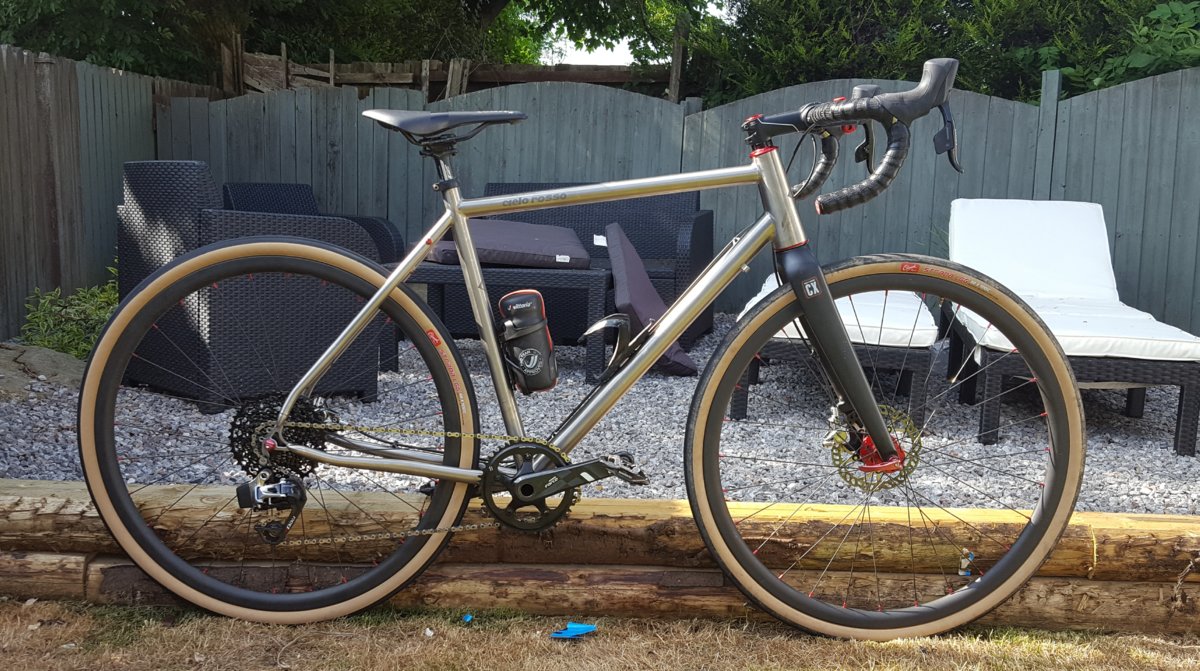

August 15, 20187 yr What conversion kit would you put on this frame and groupset its running sram etap in a 1x11 configuration and hydraulic brakes.................... so just want motor, battery and controller, not interested in brake sensors or throttle control Thanks
August 15, 20187 yr Yes, I would agree Woosh, nice lightweight torque sensing mid drive should work well. Shame to lose that nice rear rim with a hub motor.
August 15, 20187 yr Author Yes, I would agree Woosh, nice lightweight torque sensing mid drive should work well. Shame to lose that nice rear rim with a hub motor. dont worry about the carbon rims....already blew them out, so had to replace them
August 15, 20187 yr I would suggest a small rear hub like a Q100, but they only come in 36 spoke, I think it's a nice touch to keep the rims matching for the cost of a set of spokes, but no good if you are running 28/32 hole rims.
August 15, 20187 yr Author I would suggest a small rear hub like a Q100, but they only come in 36 spoke, I think it's a nice touch to keep the rims matching for the cost of a set of spokes, but no good if you are running 28/32 hole rims. would prefer mid drive system, to hub drive if only bosch would sell their systems as kits
August 15, 20187 yr if only bosch would sell their systems as kits Even if they did I'm sure the kit would be at least £1000+ and your frame would need major modification to fit the motor. Have you considered the Bafang BBS01 or GSM drives?
August 15, 20187 yr Author Even if they did I'm sure the kit would be at least £1000+ and your frame would need major modification to fit the motor. Have you considered the Bafang BBS01 or GSM drives? i dont know any kits, i'm new to this ebike thing thats why asked for advice..............at the moment i'm riding a cube acid pro 500, which i'm loving every minute of riding
