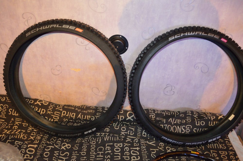

What tyres Soundwave ? loving the discs too, go nice on my Canyon :);)
mary front ultra soft,hans rear soft snakeskin addix super gravity and there going to be a right pita to fit as the side walls are so thick ;)
Must admit I'm enjoying the minions, but a magic mary may also be on the cards up front.
well that was a fkn nightmare took 2 ppl pulling the tyre and me also levering it on the rim so be warned these are not easy to fit at all.
total cost is £948 :eek:
there is an easier way, we nosed at youtube, but yep it's a wee bit tough.
