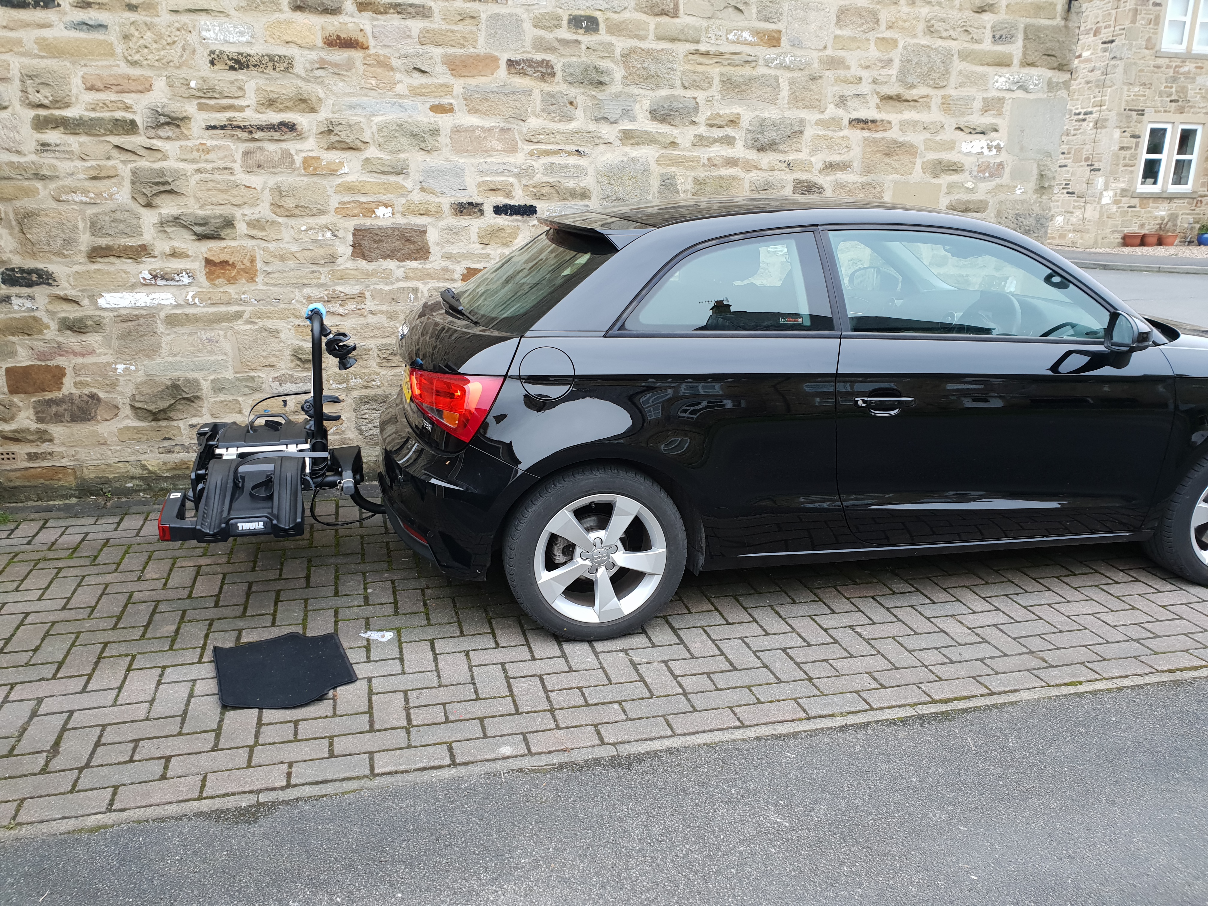

I bought a Thule folding carrier because I dont have much garage space, but my mate has a cheaper non folding one and they are both well up to the job and can carry my 30KG, and his 22KB bikes with ease.
Yes, the total cost was around £1000, but my car is an Audi so OEM parts tend to be more expensive and the folding carrier was also dearer than most.
My view is that carrying two heavy e-bikes on a car needs to be done safely..
2018-12-2819_14_36.thumb.jpg.d0d34f7d7383dfebc4d8644ba92fa7a0.jpg2019-01-0410_47_01.thumb.jpg.8136699228ad7118ca3b980a990d32ee.jpg
