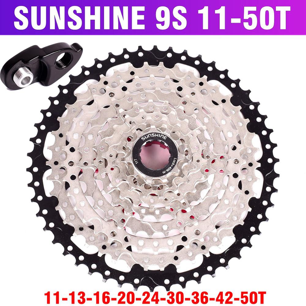

September 27, 20196 yr I’d rather have hubs on all my bikes but I recently parted with my only hub geared wheel in favour of a 9 speed cassette. purely for convenience mind, I now have two 9 speed bikes and 3 pairs of wheels and tyres that fit either and can be swapped in the blink of an eye (discs and cassettes fitted on all 3)
