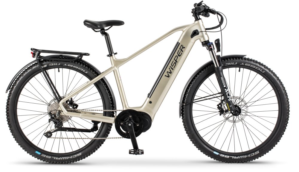

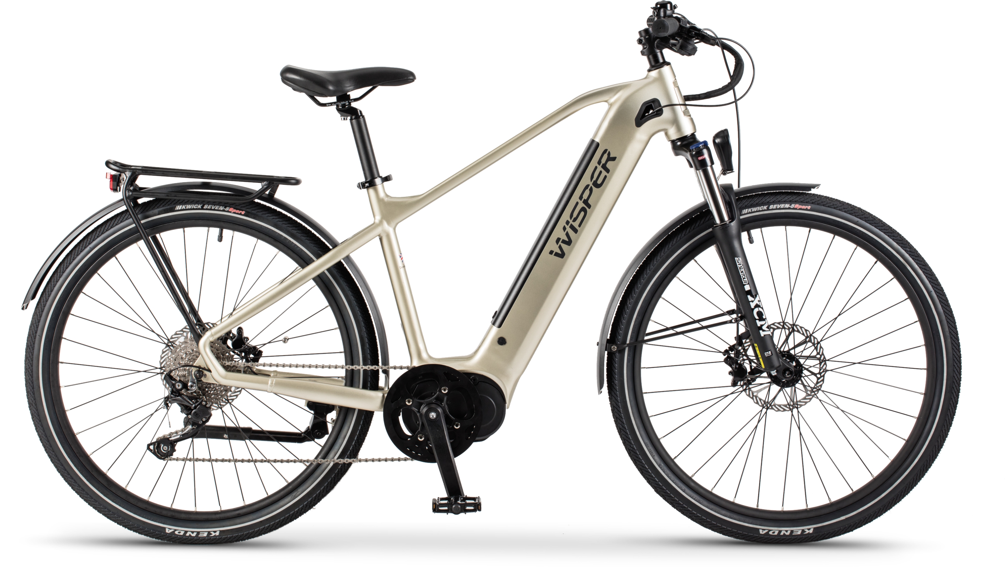

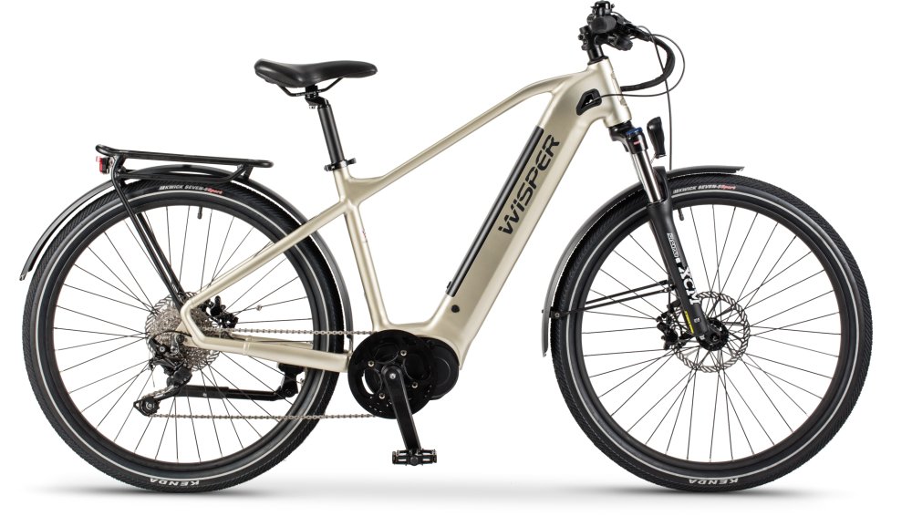

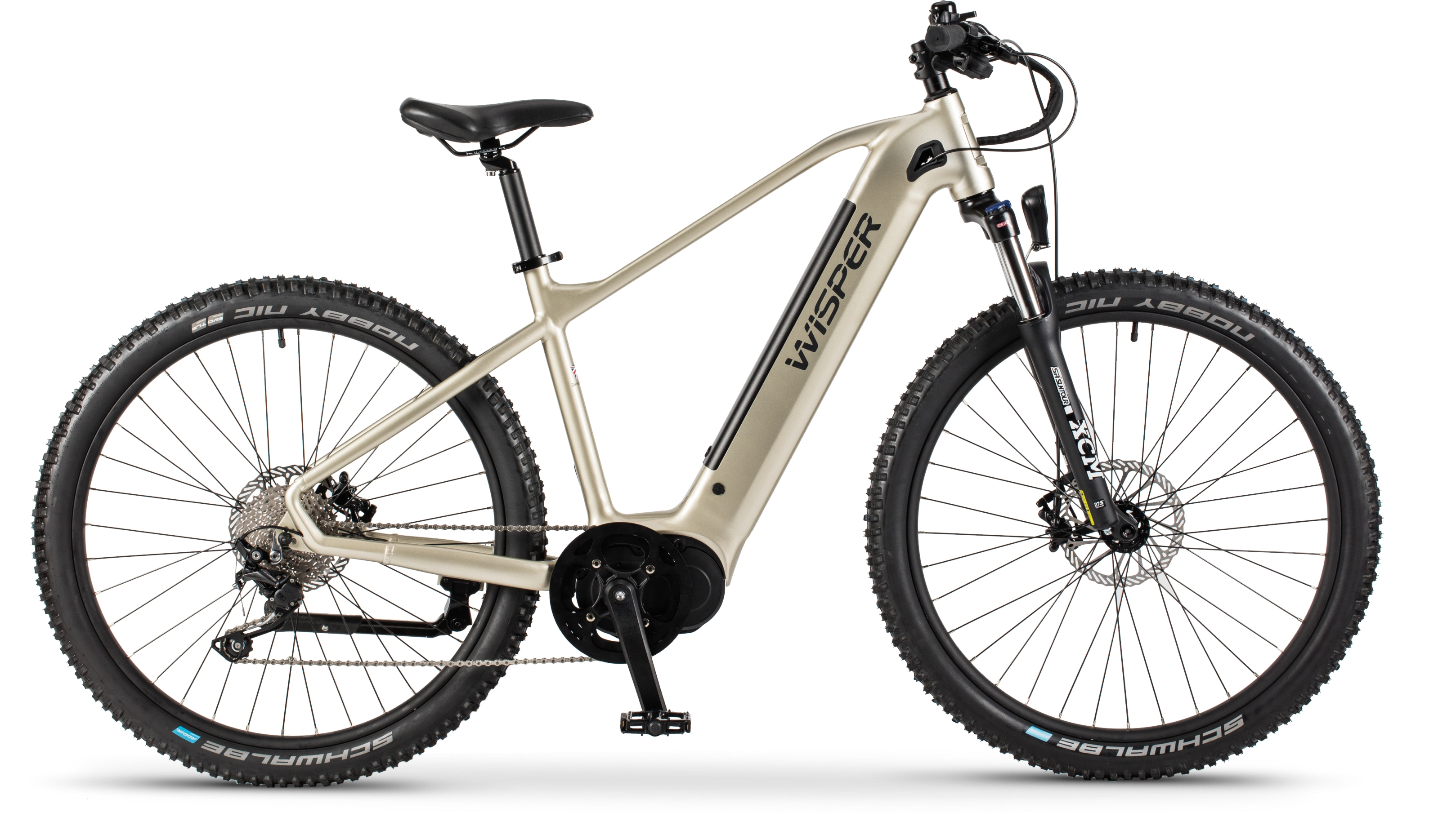

Here are the three styles available in each model.
Wayfarer Mid Motor, Cross Bar, City
Wayfarer Mid Motor, Cross Bar, Adventure
Wayfarer Mid Motor, Cross Bar, Mountain

Like the sporty rake on crossbar but +1 for clean lined stepthru as above. I do see the present rack's aesthetic attraction, so if 25kg, +2. Longer mudguards with flaps keeps it clean, +3, and a double leg stand means steering damper not needed maybe? Suspension seatpost always a nice option.
A 10kg limit on front rack as it's cantilevered out I'm guessing? I've never weighed my shopping ;-). And a parking brake means it doesn't roll away.
