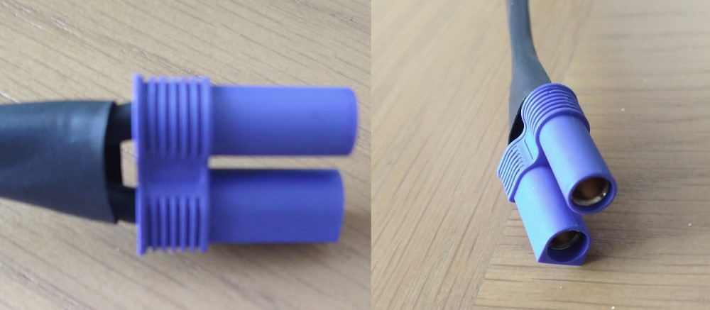

Also what is this fitting called please?
Edited by aardvark5
Connector is called EC5/Euro connector.
Unless your controller is dual voltage or has 63v main inlet capacitor then it will blow.
Your motor will run 33% faster and may heat up more esp on inclines , the rpm will increase by 33% as well. Generally a 36 v hub run at 48v will be less efficient then a dedicated 48v hub,
