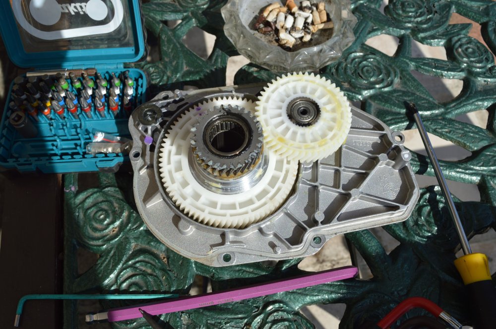

February 6, 20206 yr Whatever.. There was and is very considerable drag with the Urban Mover . I have no such drag with the Bosch . It is as easy to cycle with zero power as any conventional heavy bike. that's why I said you have to try a modern hub bike like my 16kg Faro. It's nothing like your urban mover. I like it so much that it's been my bike for a year now. Here is a typical gearbox inside a Bafang motor. The ballbearing in the centre is a one way needle bearing, acting as a clutch. CD motors have two, hub motors need only one.
February 6, 20206 yr The ballbearing in the centre is a one way needle bearing, acting as a clutch. CD motors have two CD motors have two what?
February 6, 20206 yr CD motors have two what? two clutches, one for the motor (so called the primary reduction gear on the BBS01 and blue gear on the TSDZ2, same as the clutch on the hub motor), and one for the bottom bracket / cranks which is found in the middle of the main gear cog.
