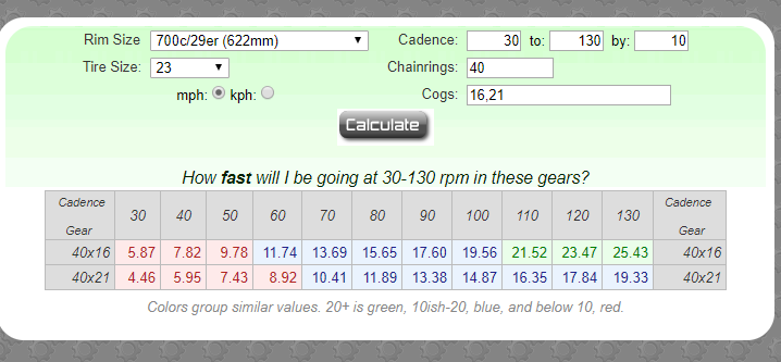

My bike is currently a 2014 Kalkhoff Agattu i8HS which has Nesus 8 gears. I can go up the steepest of hills in Gear 4 (with max boost) which seems a waste of gear range. I can purchase a range of sprokets for Nexus 8 ranging from 24 to 16 my bike is factory fitted with a 21 sproket. I have not counted the chainwheel teeth.

Change to a 16 tooth rear sprocket and you will be sorted.

21 sprocket on Alfine/Nexus is a kin to using a 13/40t cassette.
The ratio's relate approx. to 40, 33, 28, 25, 21, 17, 15 & 13t sprocket sizes.
Have ordered a 16 tooth sproket, looking forward to trying out!
16t sprocket is a kin to a 10/30 cassette.
The aprrox teeth ratio's are a bit closer.
30, 25, 21, 19, 16, 13, 11, 10.

in the meantime I will fit the 16 sprocket and see how it goes!
