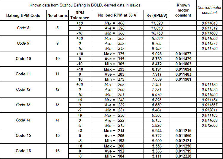

in my experience, the only reason for overvolting is because of this formula: RPM = Kv * Voltage.
You want to shift your hub motor's RPM up by 30% when you put a 48V battery in a 36V kit.
