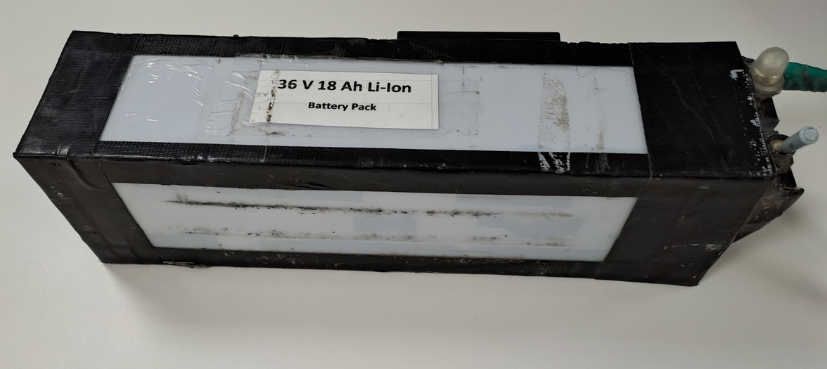

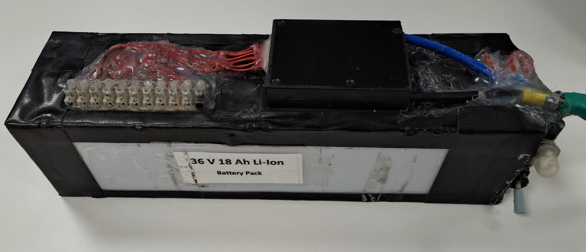

So after a year I finally got the pack back after lending it to someone with a charger set to 41V. It looks a little worse for wear now as it was attached with cable ties and gaffer tape to their bike! But it is still functioning fine.
It's been 3 years now of charging to 41V and hundreds of cycles.
In terms of the state of balance:
Pack voltage 40.882 V
Bank no. ) Voltage
1) 4.0856
2) 4.0872
3) 4.0830
4) 4.0883
5) 4.0835
6) 4.0957
7) 4.0872
8) 4.0920
9) 4.0861
10) 4.0939
So even after 3 years, the biggest variation between cells is still only 12.7 mV.
