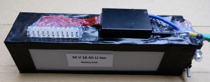

So I have this pack I built from what are quite likely to be fake HG2 cells:
As I thought the cells may be fake, I added connections to the balance wires so that the voltages of the individual banks can be checked at any time, which makes the pack ideal for this experiment. I have used it for a few cycles so far, but always charged to 41.7V of the SANS charger from Yose Power. I last used it a few weeks ago and it has been in storage at 38.1V
I modified the SANS charger as advised by Nealh to provide an output of 41V

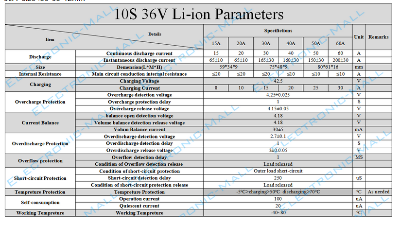

For reference, here are the BMS specs, it is for the 40A version:

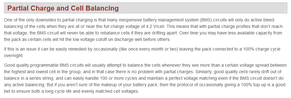

Well done for giving it a go, although the BMS balance function won't be used you still get the useful lvc to help protect against discharge, as long as cells don't wander to much then balancing shouldn't be needed 0.01v is acceptable and probably 0.02v as well any more then that then balance.
My pair of 29E's are hard case so I can't keep opening and checking so am relying on intuition and judgement/knowledge of the pack characteristics on keeping an eye out for issues. So far over the year I haven't felt the need to balance yet as the range and discharge voltage is good with no issues occurring not bad as these are well in to year 6.
The guy's on ES are pretty adamant that lowering top charge ekes out the cycle life and capacity, some only charge to 4.0v per cell and claim that cycle life is double and 4.1v about 50% more cycles.
I'm all for trying but monitoring has to be carried out, so is not practical for most users as they don't simply understand li batteries. From my monitoring of voltage the use between 4.2v - 4.1v is paltry and I find that top 0.1v or 1v in the case of a 10s battery is depleted within about 1.5 - 2km of use so holds very little capacity.

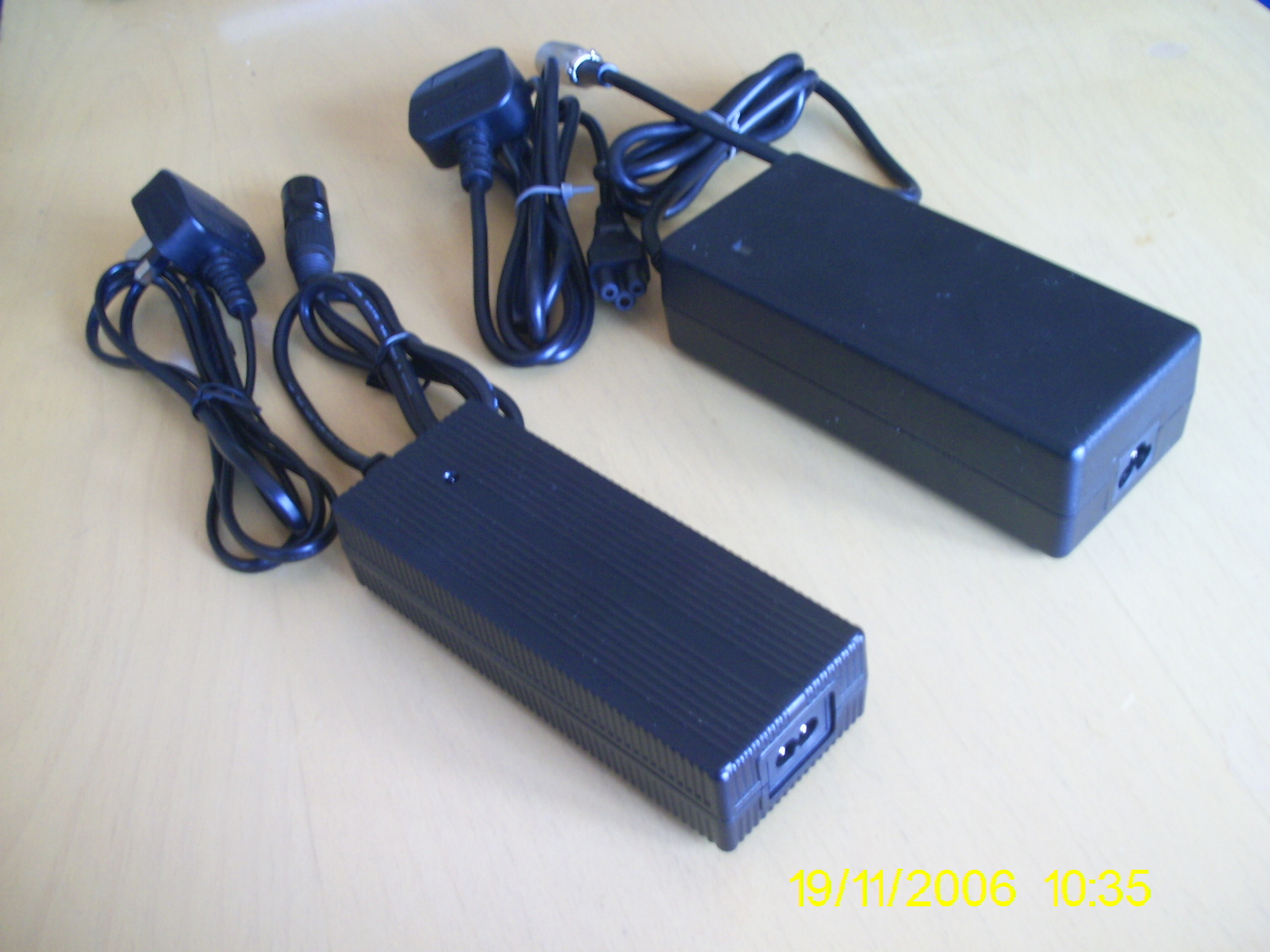

What is the efficiency of a Sans charger? Do you have a data sheet?
There isn't a huge size difference. The Sans is about 12mm wider and about 17 mm longer. The Sans weighs about 345g (not inc. mains cable). What is the weight of the Fuyuang charger?
I have cut the cable from my Sans quite close the box and soldered on an XT60 connector, so the cable isn't an issue for me.
The Sans does still use significant power when it is not connected to the battery which is not ideal. Is the Fuyuang better in that respect?
For now I'll stick with the Sans, a 3A charger would be nice, and if it's more efficient great, but hard to justify the extra expense at the moment when the Sans does the job and I've got 2 of them already.
You need to measure power factor to determine efficiency. You can do that easily/cheaply with a power meter (ebay). The last time I did, my Sans measured >68%, a Bosch measured better at >80%, and the Fuyuang measured at >89%. There are quite a few different 2A Sans models internally though that all look the same externally (same casing). Yours may measure differently.
My 3A Fuyuang weighs 500gms and my 2A Sans weighs 700gms (very roughly) with all leads and plugs needed (metal 5-pin XLR's). But you may be comparing apples with pears for size: This pic shows a 3A Fuyuang against a 2A Sans. The 2A Fuyuang is smaller still. It's not a huge size difference, but the thinner/ more flexible cables make it easier/less wieldy and the more robust casing helps for stuffing in my back-pack.
I have three 2A Sans chargers, which I've uprated the caps on, and which all work fine. The Fuyuang I bought specifically for day trips: It's quicker for free power in pubs and when working off the inverter in the van. My three e-bike batteries are only 11A, so extra top-ups are sometimes needed on all-day rides. The specs say the batteries will take up to 4A charge current which Fuyuang also do, but I thought that might be pushing my luck.

Just a quick update.
I'm up to 6 cycles now and this evening when I got home, all banks were 3.66V before I put the pack on charge. I had hoped to do more cycling last week and get more charge/discharge cycles in, but circumstances conspired against me. Should be able to get a decent amount of cycling in this week.

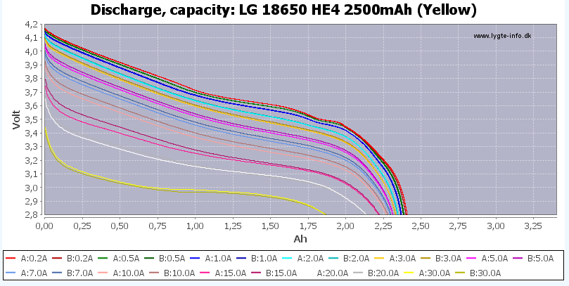

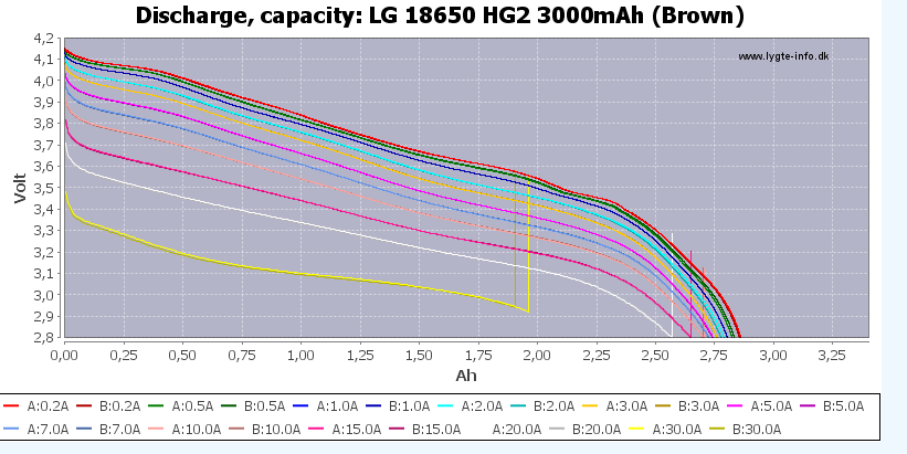

Yes, I'm really surprised. These have got to be fake cells, they can't be genuine HG2s, they certainly don't have the 3000mAh capacity of HG2 cells. However, crappy as they are, they seem to be equally crap! :D
This morning after recharging they were all at 4.1 V except bank 6 which was at 4.11. Then I ran the pack down to 37 V on my way to work. All banks were at 3.7V. It's charging again now.
0.01v isn't too much to worry about and to be that good they must still be a good faked cell.

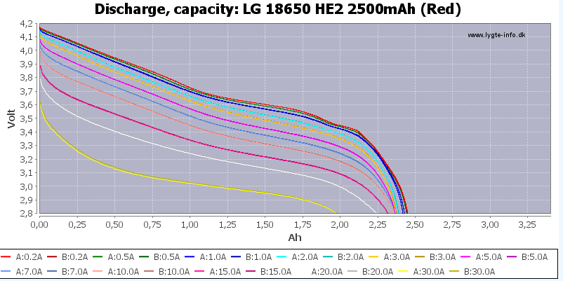

Although you think they are fake wrapped HG2's they may still be genuine real McCoy LG's, some rewraps have been known to be LG HE4's or HE2's 2500mah cells although the easiest cheapest way to clone a HG2 they are still 20a rated cells but at half the cost.
I think you are probably right, re-wrapped HE4s or HE2s. The capacity of this pack isn't much different it seems to my two Yose Power 15Ah packs with Chinese cells, maybe even slightly less. No way are these 3000 mAh. But at least they seem consistent. I have been hammering the pack quite hard, up to 28 Amps or more at times, but the cells still seem to be balanced so far.
Ok at more than 10 cycles now.
After overnight charge, all banks this morning at 4.1V, except banks 6 and 10 at 4.11V

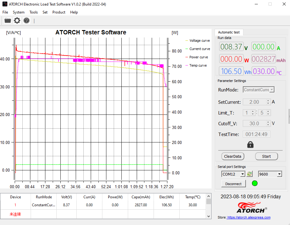

Got to work this morning, took 6.4 Ah out, thrashing at up to 28A peak, all banks at 3.67V.
Getting boring, I was hoping to see more happening by now...
Be pleased you haven't a total lemon, as I mentioned before you have probably v.g HE2/4 cells rewrapped/faked as the HG2. 0.01v with no balance is excellent imho.

Just taken the pack off charge. All banks 4.1V, except Banks 6 and 10 at 4.11V

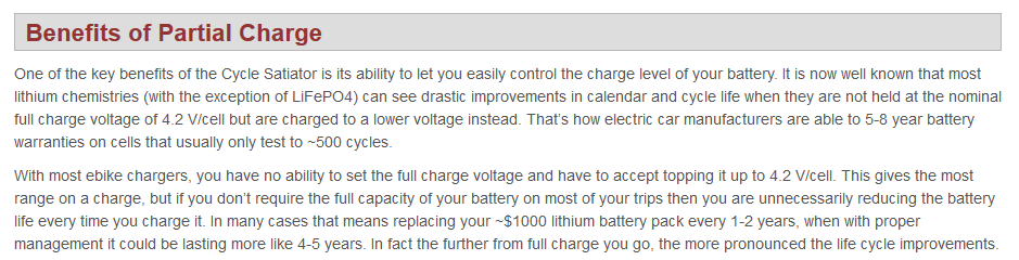

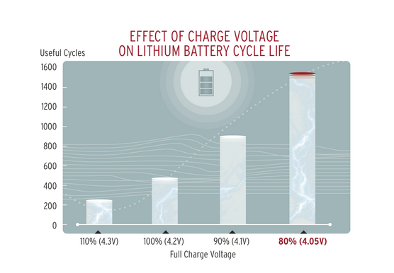

However, I found some interesting info on the Grin web page. They claim that only charging to 4.05 V can extend the life of lithium batteries to approx 1500 cycles. Also they claim that good quality cells normally stay balanced for > 100 cycles.
What I wonder though with these cycle life plots is the extent of depth of discharge. How damaging is this in comparison with charging to >4.1V? Would you really get 1500 cycles discharging down to LVC, or even 20% of capacity? This is something they don't go into.
(from: https://www.ebikes.ca/product-info/cycle-satiator.html )
(from: https://www.ebikes.ca/tools/charge-simulator.html )
