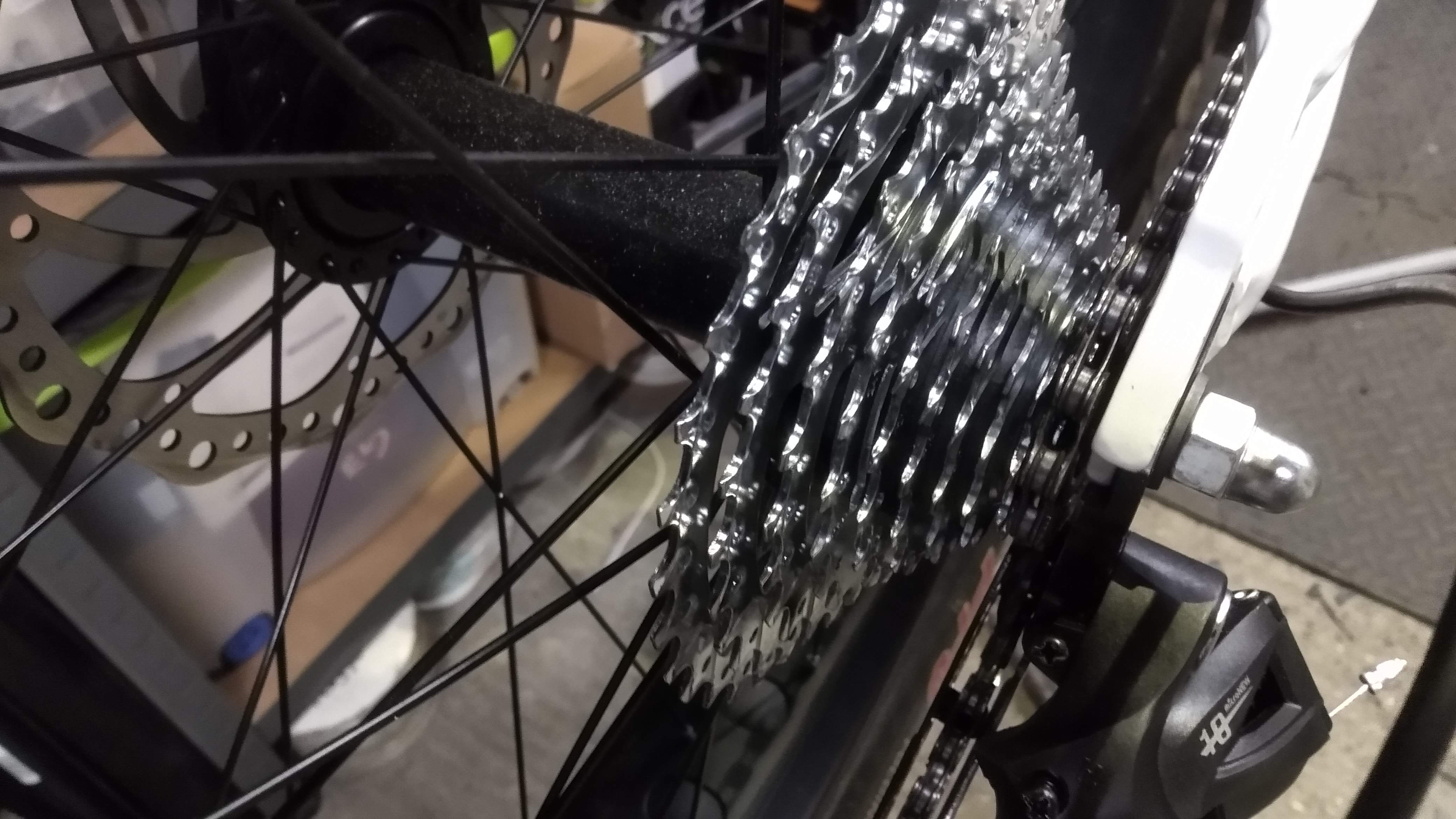

This is a screw on 10 speed which replaced a 7 speed redished the wheel to re-centre it had to add washer to clear the frameIMG_20201201_173611796.thumb.jpg.ebe83436caf3e96da2aacd8904ee03d3.jpg

The 10 speed freewheel was 1mm wider than the 7 so while the freewheel was off , removed the axle had a tube spacer and a locknut , unscrewed the nut removed the spacer tube added the washer first then tube last then the lock nut [ saves time if removal of wheel required just slots back ]
The rim/tyre was not in the centre so tyre off then re-dished pulled over in this case just loosen one set of spokes and tighten the other side
PS fitting the freewheel was easy ;) the fat bike rim will not fit in the wheel jig so alignment had to be done in the frame with cable ties as guides :oops:
This is a screw on 10 speed which replaced a 7 speed redished the wheel to re-centre it had to add washer to clear the frame[ATTACH type=full" alt="IMG_20201201_173611796.jpg]39879[/ATTACH]
it looks like you have a wide hub and rim, so you can dish it a lot further tha a typical 18mm or 19mm bicycle rim. Is it a fatbike? What's the width between the drop-outs?
Yes it is a fat bike with 155mm between the dropouts drop outs all my non fat bikes take a cassette

Yes, but OP is having a problem with his width, then you show him a 10 speed freewheel on your bike as if he can fit one on his. Supposing OP didn't realise that you had a fatbike, and spent his hard earned money on the same freewheel only to find that it didn't solve his problem.
