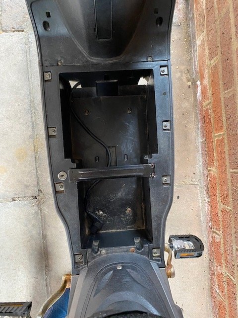

Hi all I purchased a 2nd hand ERider Electric Moped, I'm not sure if this is the right place to post but apologies if its not
Ok I got done down on the moped I paid man £350 for it, rode from his home to near mine, which is about 5 miles maybe less, then when I went to go to my brothers to show him moped battery was flat. I tried ringing the seller. all I kept getting was messaging service, he did text just once saying do I mean battery is flat or Tyre, I replied in a text battery, that was it never heard back no more, and now if I ring his number it says unavailable. I know where he lives and went to his today, but no one answered door.
had to push bike all way home to mine, from about 3 miles to mine, bloody heavy too bike is. so I opened battery case last night when got in doors and no way is this the right battery for the moped no wonder it went flat. I have attached some screenshots of battery. But would anyone here know what battery I would need for this ERider Moped. I can see the battery inside case is Lithium, But Have a funny feeling there was probably 2 lead acid batteries before. I would prefer Lithium battery for it but don't know what one to get. I don't even know model number of moped all it says on side is ERider. also on the pictures i have uploaded what is that suppose to be in green circle I thought maybe a fuse, But it looks like a bike tube connecter
Hope someone can tell me what battery I require for this ERider Moped

Depends which sort of their mopeds it is. If it's their bicycle class model 18 or model 21, they are 250 watt rated and normally use 48 volt circa 20 A/hr lithium batteries.
They are on this web page: https://eriderbikes.com/electric-bikes/
If yours is different, email them on their Contact link and attach a photo of your bike, asking what battery it should use.

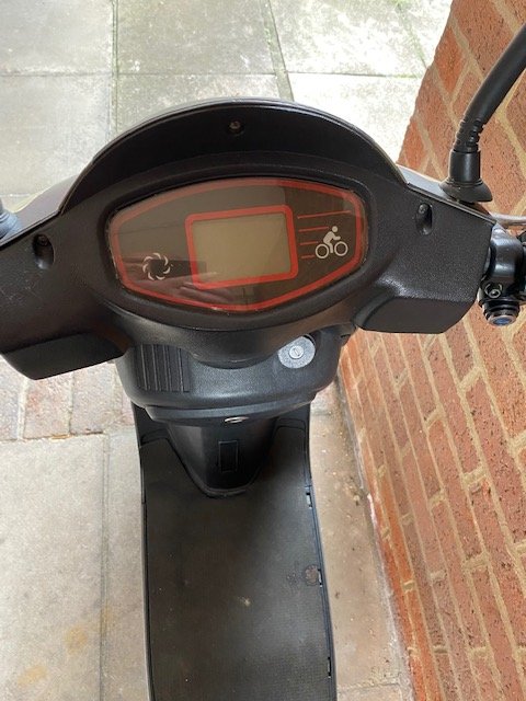

Hi many thanks flecc your your help, Im not sure what model bike is as I don't know where it shows model on the moped, But I will take a photo of moped and mail ERider
Im a bit confused really if it is the battery fault. Well obviously its not the correct battery on bike now as when I left the sellers home, it went about 5 miles, then was flat. but when I managed to push bike to brothers house, he put battery on a charge for 3 hours and rang me to say its charged up as light went green. but after leaving his house, the battery went flat only after about. 1/2 mile. so would this be another fault or still the battery. also how do you test the battery charge with a multimeter this is the meter I have where do you switch dial to and I know red wire on batt is + and black is - I have also decided to show you all the ERider bike i have there is a lot of images

First question is where do you live? If you're anywhere near me, I might be able to help you.
Those mopeds normally have higher current controllers than ebikes, so you probably need a battery that can provide 25 amps continuous. Without pedaling, 10Ah will get you something like 5 to 10 miles, so you need about 20Ah to get a decent range, depending on how fast you go. The original battery was probably 4 x 12Ah SLAs, which would be about £100 to replace with new ones. If you go that route, make sure that you get ones for elctric vehicles.
If you can, have a look at the controller to see what current is written on it. That will give a big clue to what you need, batterywise.

No, it doesn't charge when you pedal. Other bikes like that that I've seen had a normal pedal sensor. When you turn the pedals, they give power. You can set them to have an independent throttle or throttle that only works when you pedal.

The controller will prob. be under the seat, around that area. You don't need to pedal when you ride, but they are there to make the bike legal.
You'll probably have to remove panels to get at the controller. You might be able to see it if you look from underneath the bike. It's attached both to the battery wires and the motor cable, so just look where they go and you'll come to it.
If you're throttle is set to work on its own, you don't need to worry about the pedal sensor.

Get a friend/neighbour/grandson or anybody like that to do it for you. DO NOT buy any battery until you know what current is written on the controller. I can guarantee that a £110 one won't work on your bike unless it's SLAs which would give yo a range of less than 10 miles and are very heavy. Lithium will be around £300 to £400.

I maybe able to lay moped on its side then see underneath, it look then I am going to have to buy a battery for £325. the bloody sod who sold it me wont reply back to me no more now. I have his address. I have been round once popped a letter in his door, but heard nothing back, also am going round again tomorrow same thing will drop a letter in his door. but not expecting him to open door. it just bloody annoys me people who do that. I've now got to pay double price for moped. But Like flecc said bike don't look too bad at least I will have a good bike then after getting a battery. it would help if the bloody seller gave me at least £150 back towards a new battery. But I don't get luck that way.

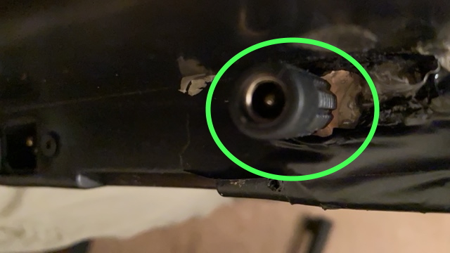

if you look at old box there is a black wire what seems to go to what looks like a bike air inlet line. but surely that's a fuse isn't it.
That's the charging connector.
