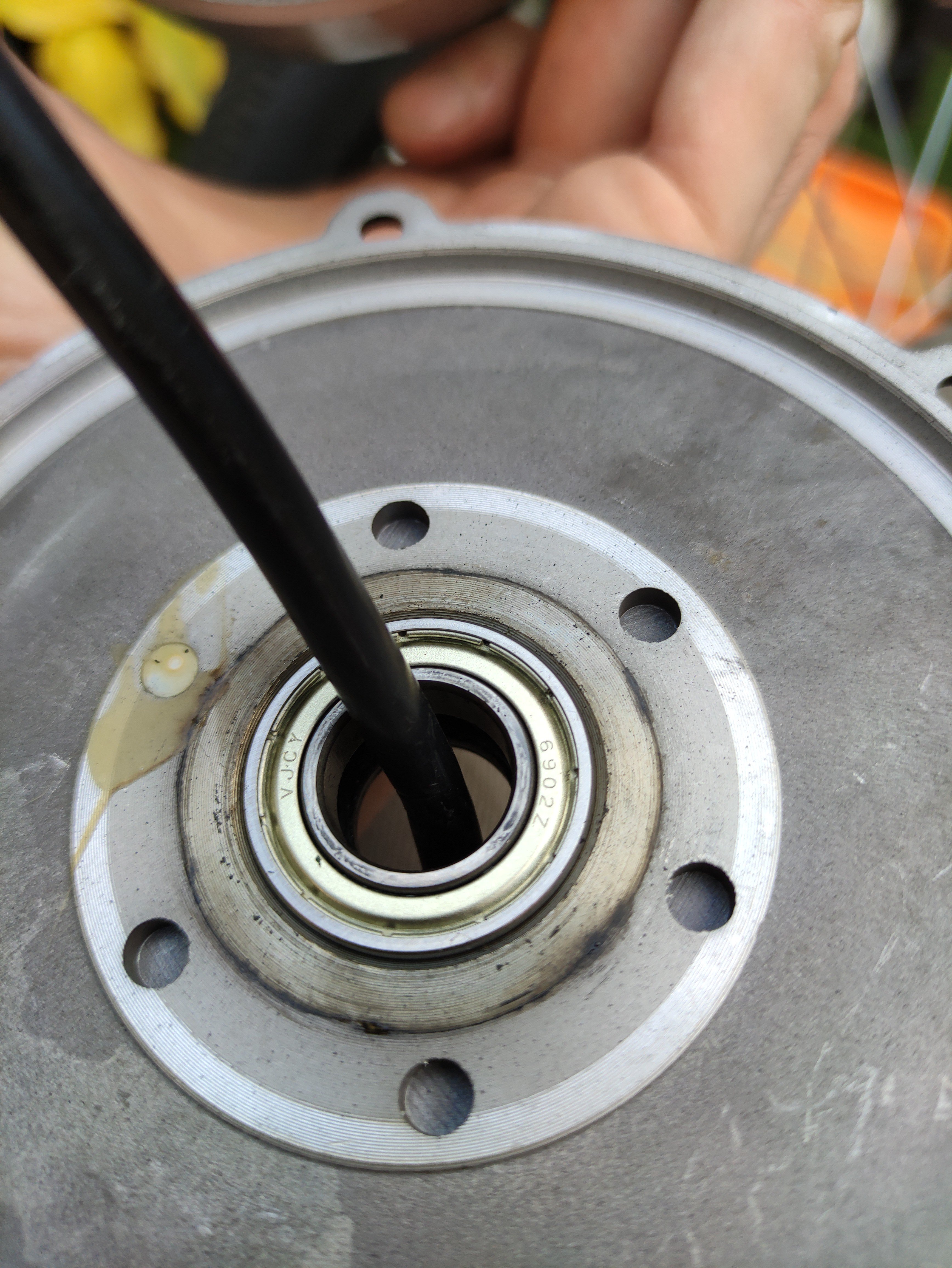

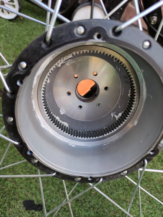

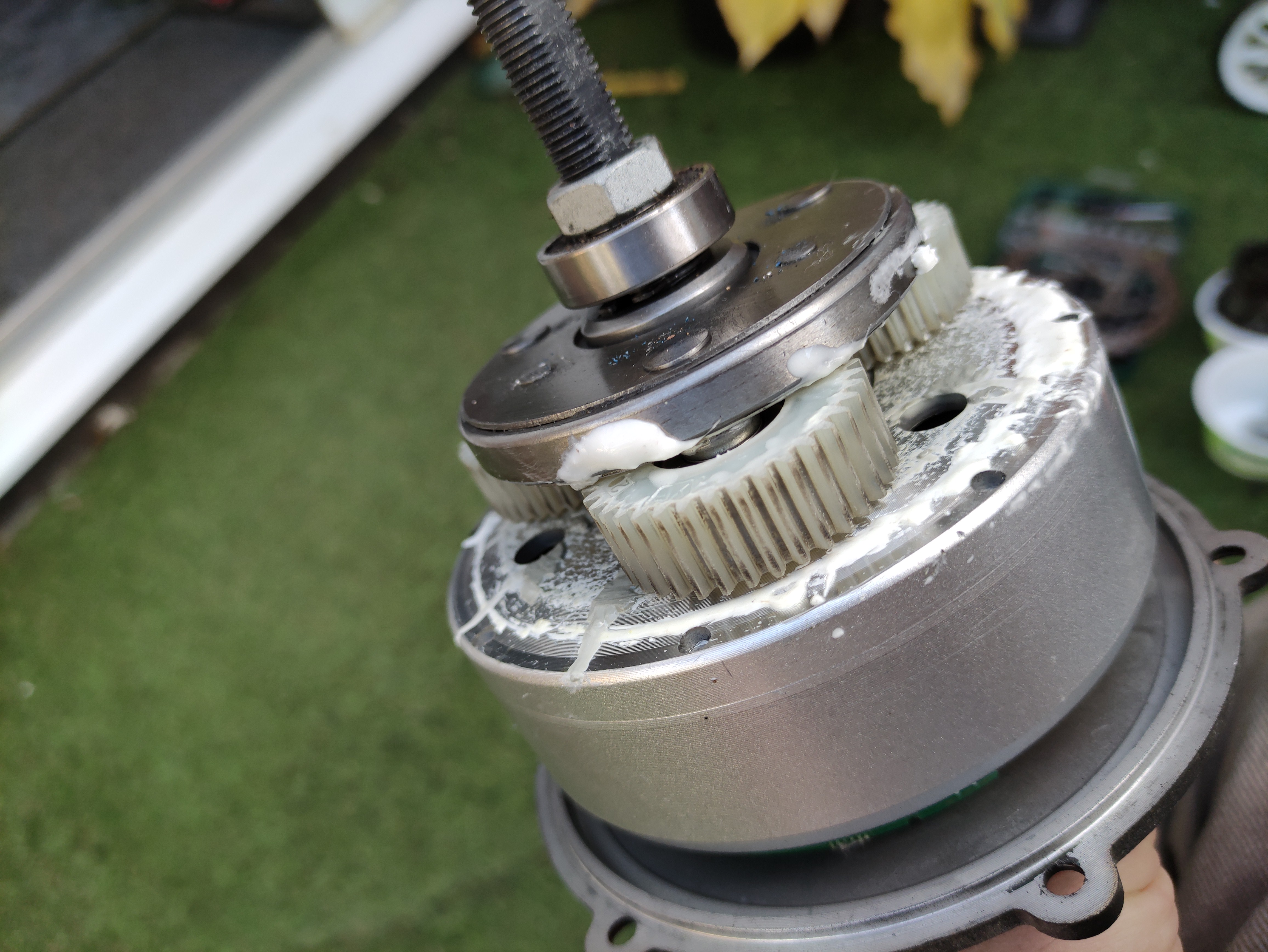

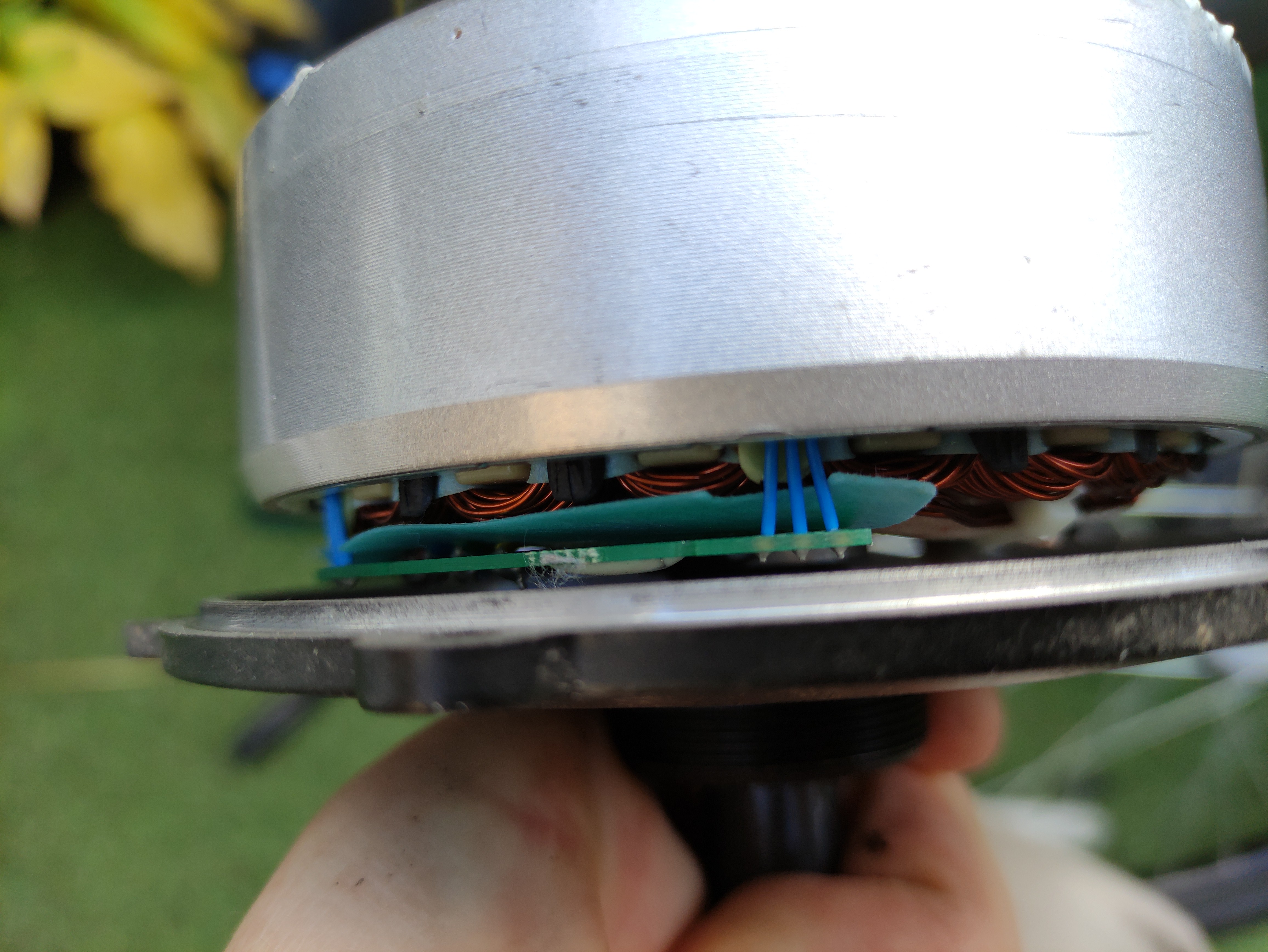

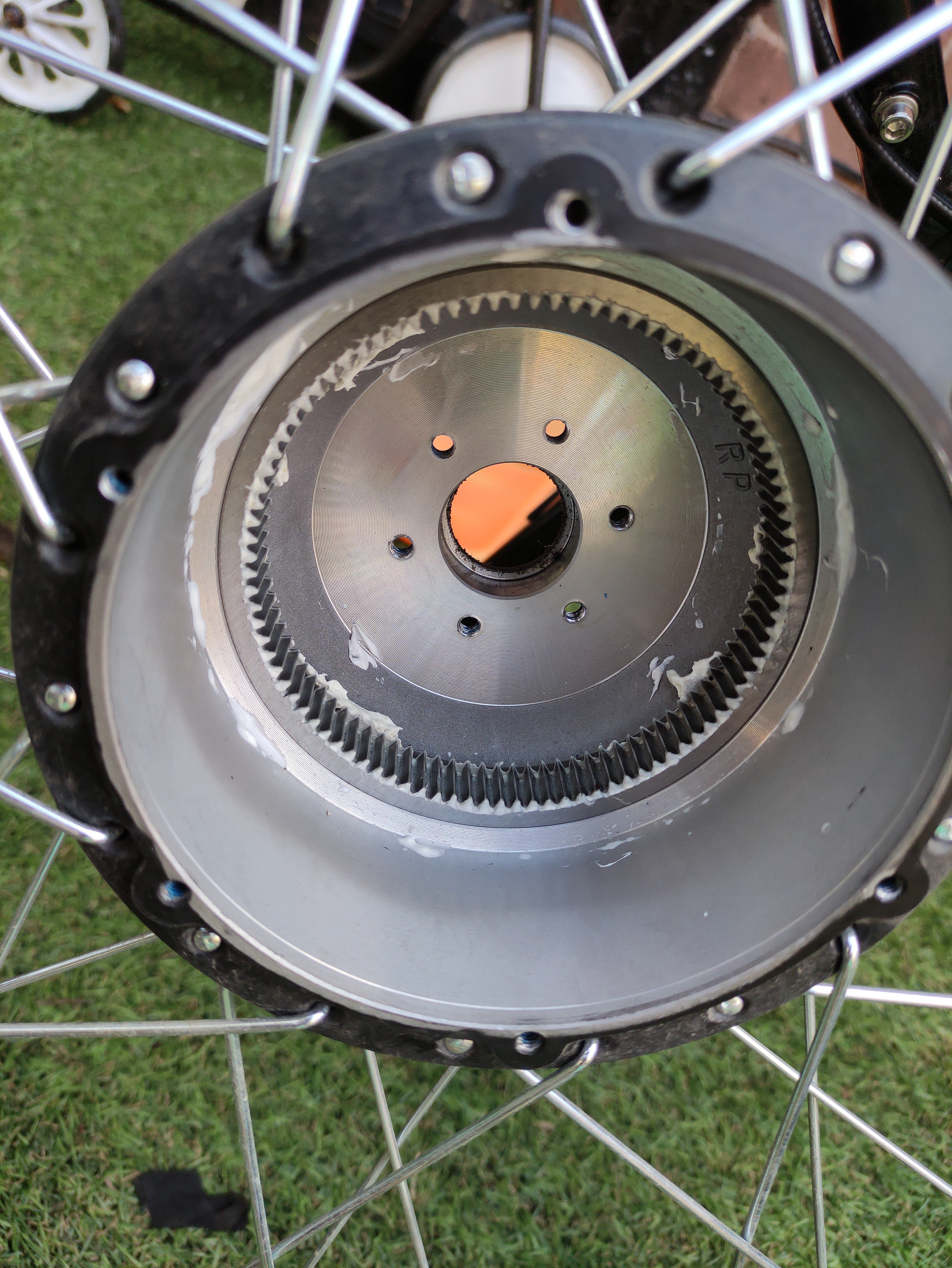

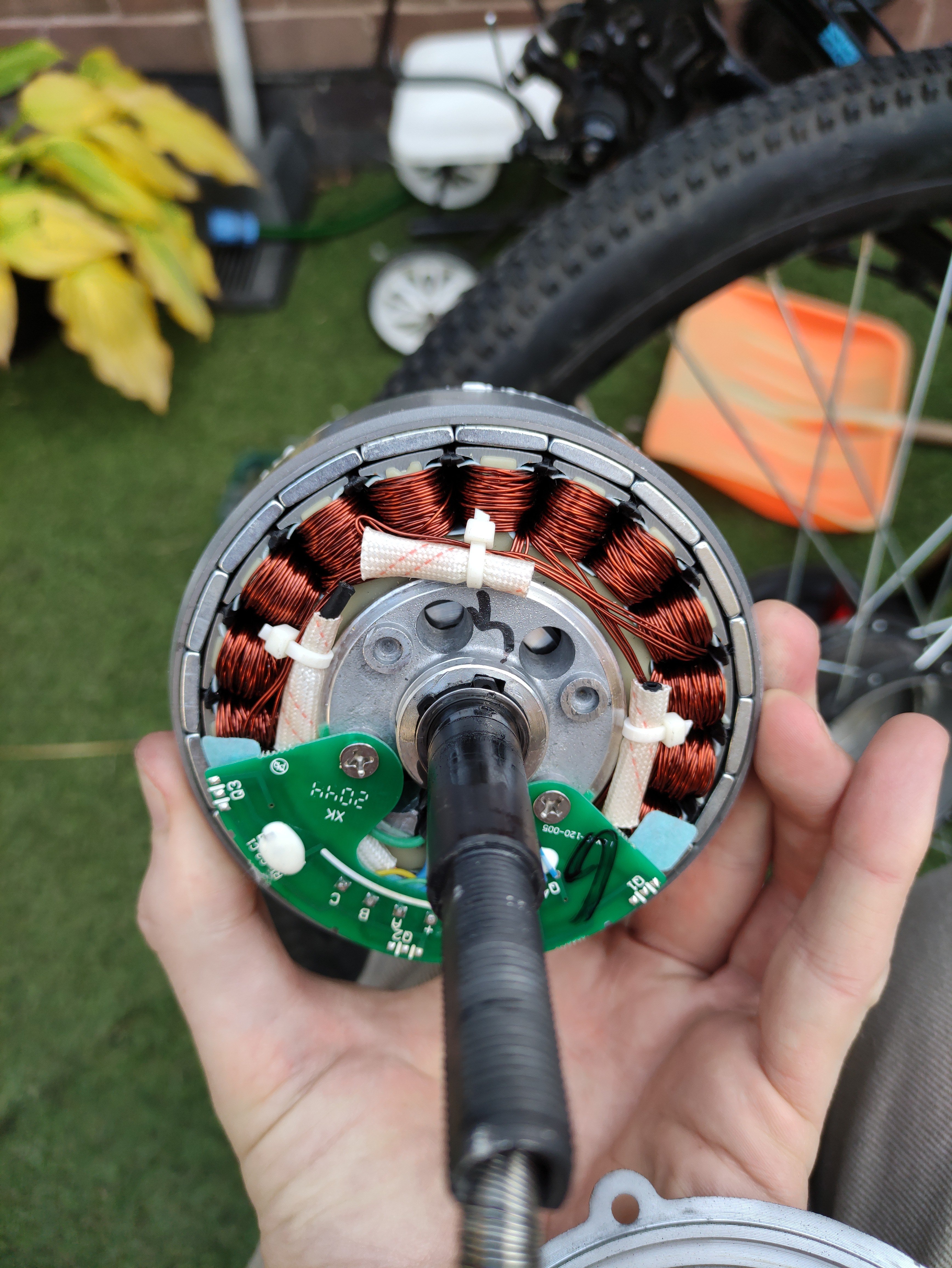

Got a sneaking suspicion they jet-washed it. Should probably open the motor and have a look in there.
  • Replies 89
  • Views 15.5k
The hub won't cause the electrical connection issue of melting contacts.
No, I didn't think it would. But based on some corrosion I'd found in the battery I suspected they'd jet washed it. In which case the motor would need inspecting. Turns out it's fine. So if they did jet wash it there was no evidence of ingress in the motor.
Grease is a bit sparse, it won't hurt to put a nice dollop in there and it will run quieter as well. Any non petroleum based one is good so as not to damage the nylon gears.
Other wise yes the motor is spick n span, I have ridden my bafang cst through water over the axle with no water ingress on a few occasion's. Being not under pressure no harm is done, though I do syringe white water resistant grease into the axle as best as I can.
