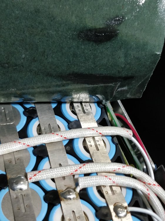

I'm startingto wonder if the stress of the battery pack bouncing about within the case, has broken down the adhesive to a liquid-like state - it might not have been heat? Those wires are on the sides after all. Liquids might be more flammable. Seems nuts that flammable paper is used... I suppose the combusting temperature of the paper must be lower than that of the battery cells?

The stains I would lift the paper insulation covering to look, does it smell of electrolyte ?

Now the paper has been lifted it looks like heat is causing the paper glue to weep through. The sense wires with heat sleeves are laying directly across the interconnectors.
Is that bad practice? Is it something which needs fixing or re-organising? I've learned to solder (a little) recently, but I don't fancy my chances at reorganising those wires!
Maybe I should add thicker heat insulating material around those wires? If so, what sort of product could be used?
Would wrapping kapton tape around those wires protect them adequately?
The paper is an insulator /protector and is quite hard wearing.
Re use the paper if poss and use a wrap or two of kapton tape to bind it again.
Once lifted it depends what the cells look like and whether leaking has occurred, leaking will show up as the cell wrap will be bubbly/rough. Electrolyte smell I can't describe but any smell is abnormal as cells don't smell.
Should I cover completely with kapton tape? Would that make the battery pack too hot?
I don't lay wires across interconnectors, I either lay them between or through the cell/gaps where I use spacers. Kapton tape to insulate against heat transfer.
The interconnector material may be heating up as it may not be capable as a very good conductor thus heat is then conducting through the wire insulator material to the paper causing the glue bleeding, that's why folks use copper now as it heat flows nicely through it being 3 or 4 x more conductive then steel/nickel.

For my batteries I use a 0.4mm fibreglass sheet top and bottom as an insulator.
Kapton one can use what ever width one wants to, I tend to use 20mm for most of my builds.
The laying of the sense wire across is a bit crap, but I suspect the interconnector material may be a bit below par and is getting quite warm with higher current.
Those interconnectors are not copper, that's for sure, bog standard nickel? Well, at least this battery has MH1 cells, hopefully not ruptured and ready to explode.

Thanks nealh. I'll order both FR4 and kapton tape, to reduce the heating of those wires. There were a lot of hot days this year, must have been toasty in there.

I'll give this battery pack a very thorough visual inspection, when the kapton tape arrives.

EM3ev: Those look like copper interconnects, less heat
I'll protect those hot wires using fr4 and kapton, add cushioning, but my next battery will be built much better than this first ebike battery that I've ever bought.
