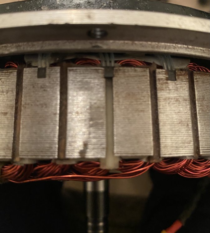

No you are right as the wires on opp side of freewheel Need to be cut. Like he does in that grin YouTube video then I can see if I can. Grip all those loose wires with a pair of pliers. And pull through freewheel side. Then thread new cable through. But only trouble is I don’t have a clue what wires to cut. Nealh was also right about that freewheel side case stays on. As in that grin video his is left on. I’m so grateful to you all for telling me this as I would have probably like you said crack casing.

are these the sensors but they seem to be on the freewheel side

I have checked behind the rivets and there isn’t anything but can see the wires now when I shine a torch behind inside case. So will case come off then if I replace freewheel then use gear puller to get case off
EDIT: Well I’ve attached the freewheel and now using gear puller and it does seem to be coming off well slowly as I can see it’s moved so will try a bit more tomoz but slowly

Well by removing case it will give me more access to the wires and where they go
well case has come off ok and now can see the sensor and phase wires

Yes may try that or like Nealh said butter from fridge lol but god knows how I’m going to thread 8 wired or 9 cable through the axle as it seems it goes through side of axle and out through top but I can see a clip at bottom of axle so maybe that will remove that end of axle not sure yet also not sure if sensors need replacing I think they ok
