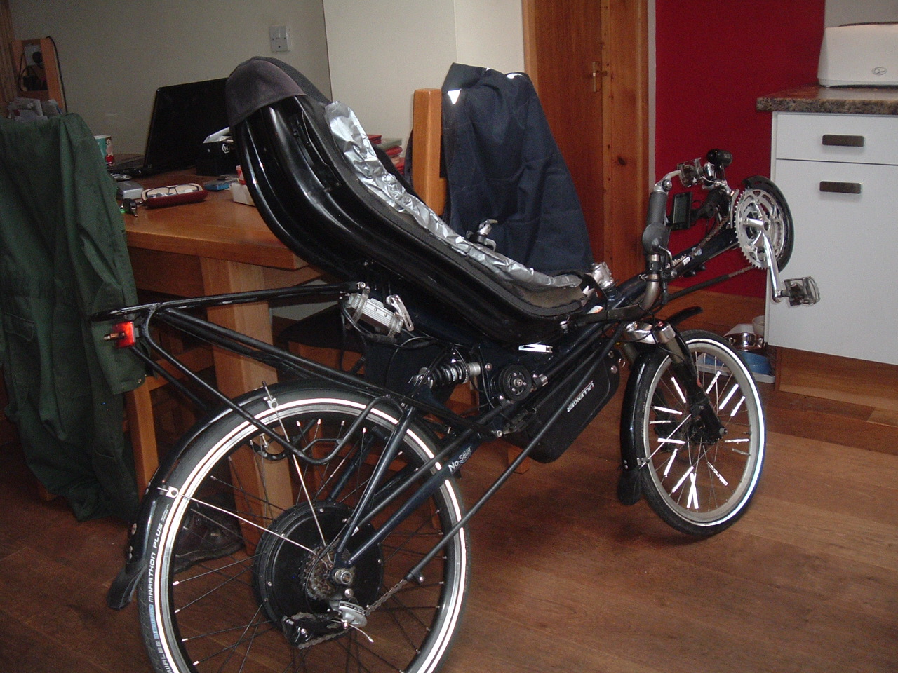

April 11, 20233 yr I've been searching for a particular bike for about 4 years. In a post around 3 weeks ago, someone mentioned a recumbent they had bought. Out of curiosity I googled it to see what it was like. Up came e-bay and lo and behold the 3rd picture along was the bike I'd been looking for. Serendipity or what? I contacted the seller, offered the asking price - less than half new price- and went to meet him at a BHP racemeet on sunday. Having been assured that I would embarass myself on first ride, I faced it with some trepidation. However I tested it with no incident and was told I'm a natural! So, here's the bike: New seat cover is on order, meanwhile there's a few things to deal with. First, I've had to shorten the boom to suite my little legs and, as you can see, I need to shorten the chain. I've found 3 speed links in the chain, 2 of them 25 links apart. Here's the type of link: So, ignoring the surface rust, can this type of link be removed without destruction, what are they called? I do have a link remover but it's many years since I used it, may need a refresher course. The chain is sitting on the middle front ring and rear 4 of 7. How many links do you think need removing? The kit is a horrible Dillenger pancake and is not going to stay. It's 48v and, I suspect, a direct drive which is probably not going to be suitable for the Welsh hills around here. There is no torque bracket and, not sure, but I don't see a torque washer. It may also not be fully seated in the dropout. Once I get further along I will be looking for a 36v rear wheel hub that's legal, high torque and preferably silver. I've tried to remove the battery from it's cradle so far with no success. Does anyone know the trick? There is a lever under the front but this just feels loose with no 'mechanical' feel to it. Lastly - this horrible little mirror. When riding it's actually very low down, probably stuck with the location. It's only about 2" across and needs to be bigger. Obviously can't use a bar end 'cos of the gear change. Found some alternatives but not sure. Any suggestions gratefully recieved.

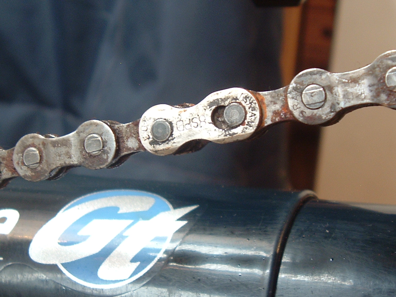

April 11, 20233 yr can this type of link be removed without destruction, what are they called? Those missing links: https://www.wiggle.co.uk/kmc-missing-link-pair-silver ...can be difficult to remove, without one of these: https://www.ebay.co.uk/itm/374451896770?hash= ...or these with longer handles: https://www.ebay.co.uk/itm/133665563537?epid= The pliers need a lot of force sometimes to close, in order to disconnect the links - I cover the handles with a towel.
April 11, 20233 yr The quick link(We call them quick links, not sure where this missing link descript came in from) and i only mention this as googling the right thing makes getting a good price a lot easier. I digress. Quick link pliers are a god send./ Spent 3 hours trying to get the link to open without a pair and had to give up until a pair of the pliers arrived in the post. Job then done is seconds, and now one of my favourite tools, given that it works and makes the job its designed for super easy.
April 11, 20233 yr I use a thin nylon cord to release them. Here are a few ways to do it without the tool.

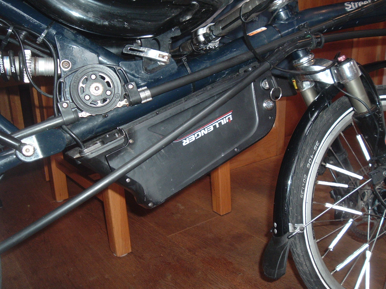

April 11, 20233 yr I've tried to remove the battery from it's cradle so far with no success. Does anyone know the trick? Doesn't the battery simply slide forward, after being unlocked? In that position, perhaps water ingress has caused the mechansm to seize up through corrosion? https://www.youtube.com/watch?v=z7wv1fsemSY:170

April 11, 20233 yr Author Thanks guys. I've ordered lucy quick link and some pliers, nicked a metal coathanger from the wife's wardrobe to make a chain hook.
April 11, 20233 yr Author On the battery, the seller tells me it was always stiff, just don't want to break it. Think I'll be getting the ptfe spray out. However it's blowin a hooly out there at the moment so I'm staying next to my mug of tea.
April 11, 20233 yr Think I'll be getting the ptfe spray out. Is that electrically conductive? https://www.pedelecs.co.uk/forum/threads/sorted.44724/ https://www.amazon.co.uk/WD-40-Specialist-400ml-Performance-Lubricant/dp/B006UCKE1M/ref=
April 11, 20233 yr Author Got the battery out but, life's a pig sometimes innit, couldn't get it back in. Quick cleanup and a bit of ptfe lube eventually sorted it. I do find that things are easier to use when you know how they're meant to work As far as I know it's not conductive, it's silicone based. However didn't go near the contacts. Must say I'm not a fan of this battery cradle. The electrical connection is a two pin plug/socket arrangement that engages as the pack slides onto the cradle. My batteries utilise anderson power poles and I like the very positive manual engagement. Also the cable going to the controller is a double insulated two core about the size of a lighting flex. Doesn't seem big enough to me.

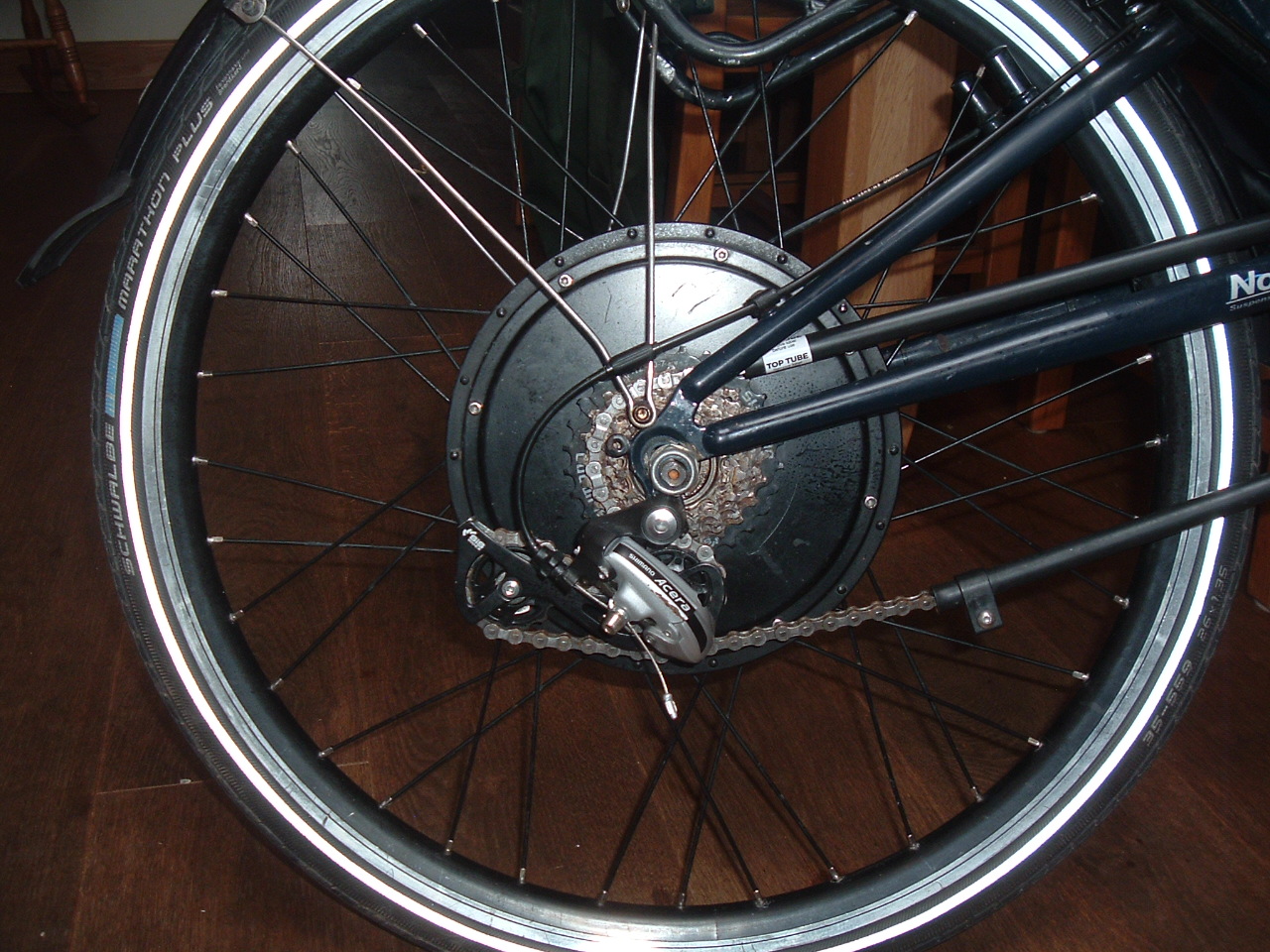

April 12, 20233 yr Author Finally got the bike on an improvised stand. Ran the motor up and found that it's registering 50kph in setting 9 Don't know how accurate that is but, even if only 10% out, that's scary. This motor has got to go. It has no markings and is a big, black 9" dinner plate, bit too obvious for me even around the back lanes. Also found the back brake was binding. So - the fun begins.
