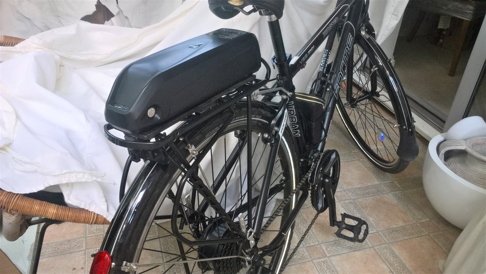

May 3, 20232 yr Author I've just ordered a Tongsheng TSDZ2B and 14.5ah battery for my wife's bike but I am still none the wiser as to what would suit mine. As for the Tongsheng, I have read numerous reports of the case screws stripping. Would it be a good idea to change them while still new to stainless hex heads for instance just to make it easier to open in future if need be? Regards, AJ
