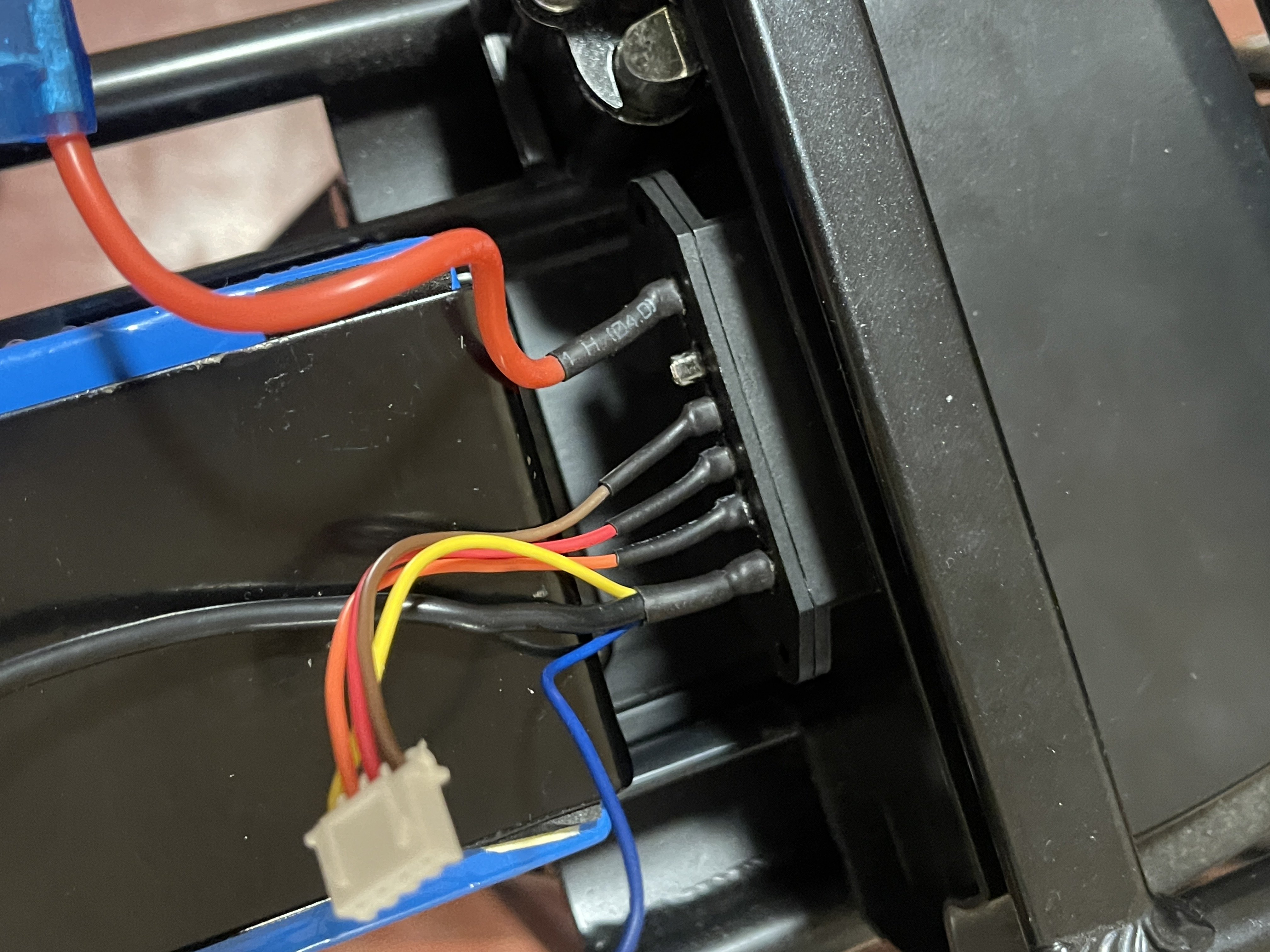

[mention=3847]saneagle[/mention] suggested that this set should be able to take any 36Vbattery so I used my sons motorbike to get the battery out to test Pendleton Somerby and everything works just fine. Took it out to test it (I have never used electric bike before) and I almost killed myself, its so slippery outside and I deduced to use front break, almost ended up being run over by a car :D
Last two things
1. I am still in pursuit of the solution for this post:
can I add a throttle to this bike without causing a surge or fire?
2. I need a new battery

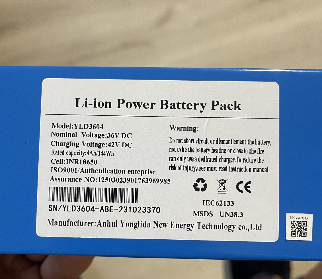

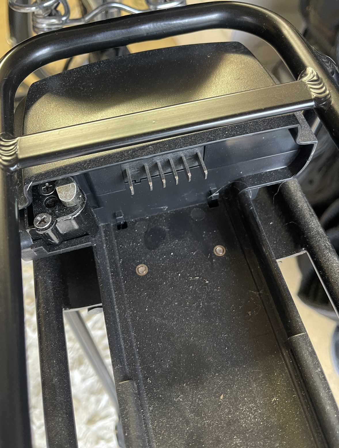

Since we know now that this controller can take any 34v battery i took the housing off the bike and I took it apart to see if someone could suggest a new better one, with a longer lifespan
I like this one quite a lot however I have no idea if the cells are good
Edited by adamsowy
Cheaper (£106 +7 delivery) for 10.4 AH below if it fits. I would prefer to buy from a known supplier than an unknown e bay supplier.
https://www.pswpower.com/products/no-tax-36v-10ah-haitian-electric-bike-battery-pack-bicycle-lithium-18a-bms-output-500w-157
wow that's the best option so far, however I am a bit worried I wont be able to fit my controller there, I was trying to find some videos or pictures of the housing being taken apart but no luck, what you think?
