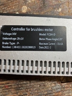

I have a problem with a Lishui controller. At least, I think it's the controller.
Your controller is YCSH (JYT) brand, not Lishui. Lishui controllers have product codes starting with LSW-something. The good thing about Lishui controllers is their firmware cope automatically with a lot of variations in motors: Hall or Hall-less, number of magnet poles in the motor, number of magnets on the PAS disc, number of assist levels etc. They are suitable for a lot of kits, simplifying support because customers don't need programming manuals and support technicians do not have to check the stored parameters. On the other hand, the KT controllers let you change stored parameters yourself.

Yes, my mistake. My controller, built in to the battery base, looked similar to a Lishui in a Woosh kit I fitted earlier for a friend, so I assumed it was the same brand. I later realised my controller is actually different and not a Lishui at all.
