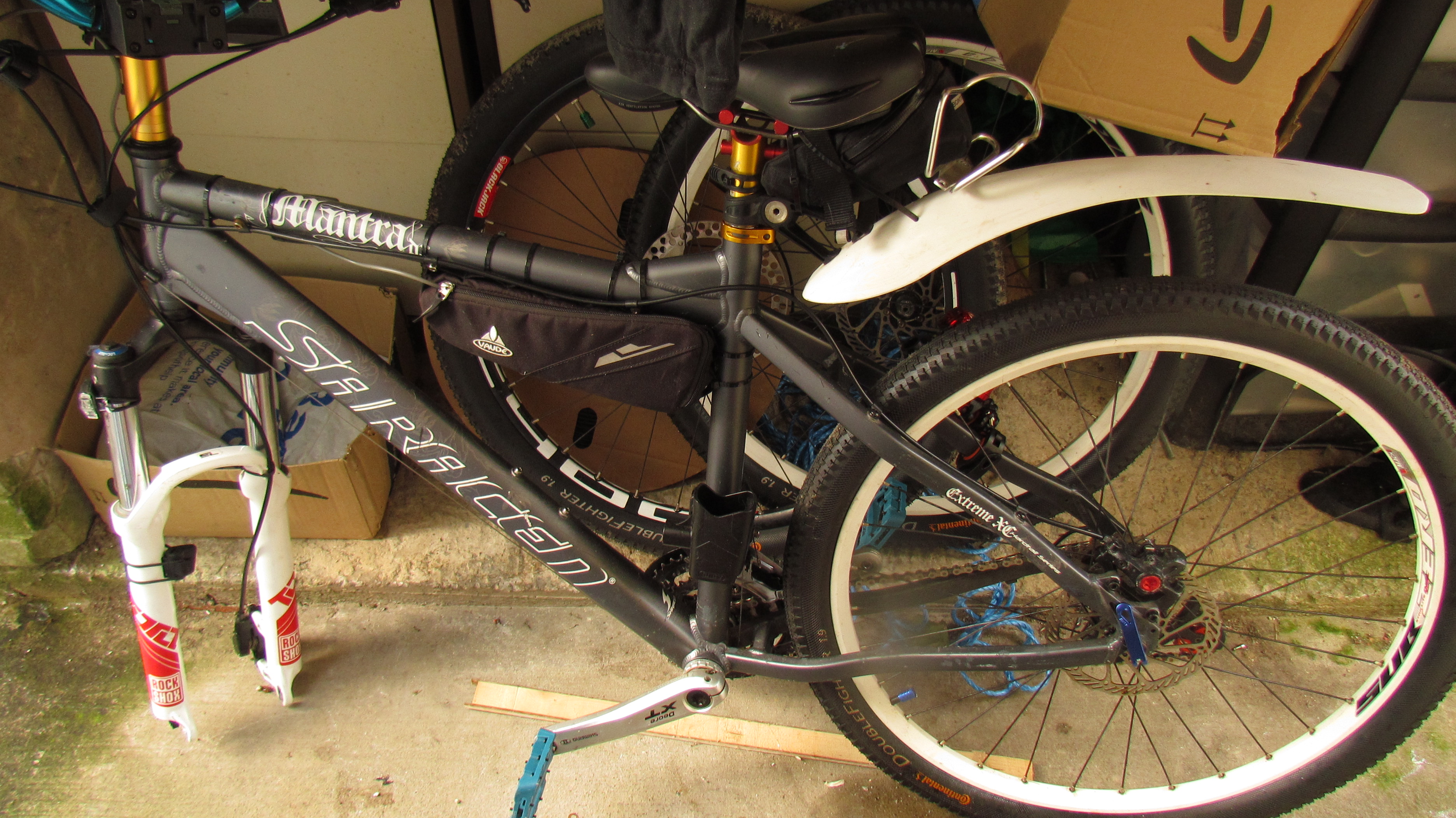

Please keep it simple, regarding what I need Thanks
My son and I are both Autistic, there is no way I can afford new electric bikes.
I have a good Saracen Mantra from 13 years back and my Sanderson life frame cruiser I built.
Both are 26, 3bys, and I would like to add a drive to them that is UK legal.
I have NO idea where to start other than here.
We ride off road, gentle, but that is not easy at 65.
ANY advice will be much appreciated
Thank you

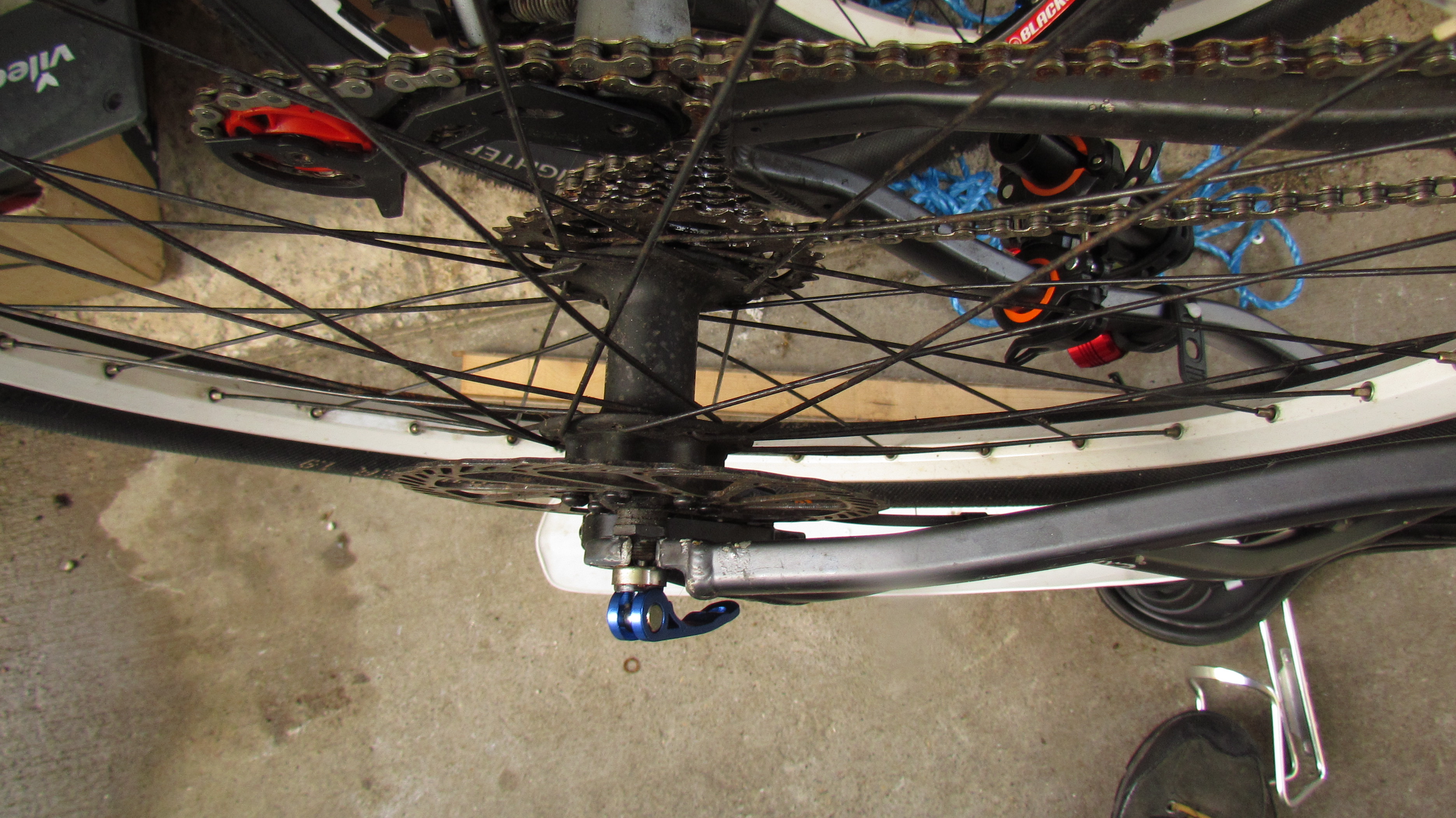

[ATTACH=full]53531[/ATTACH]

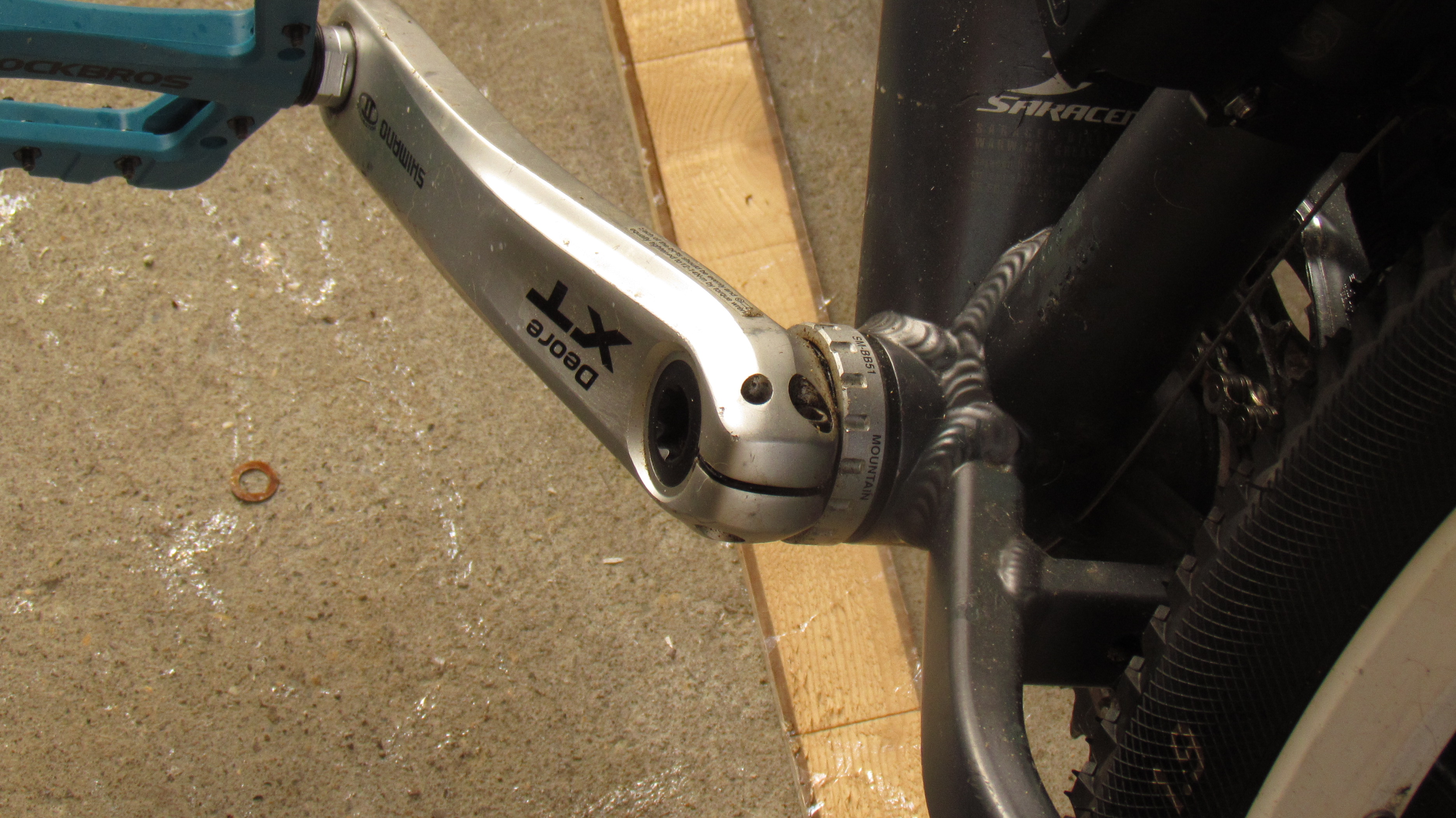

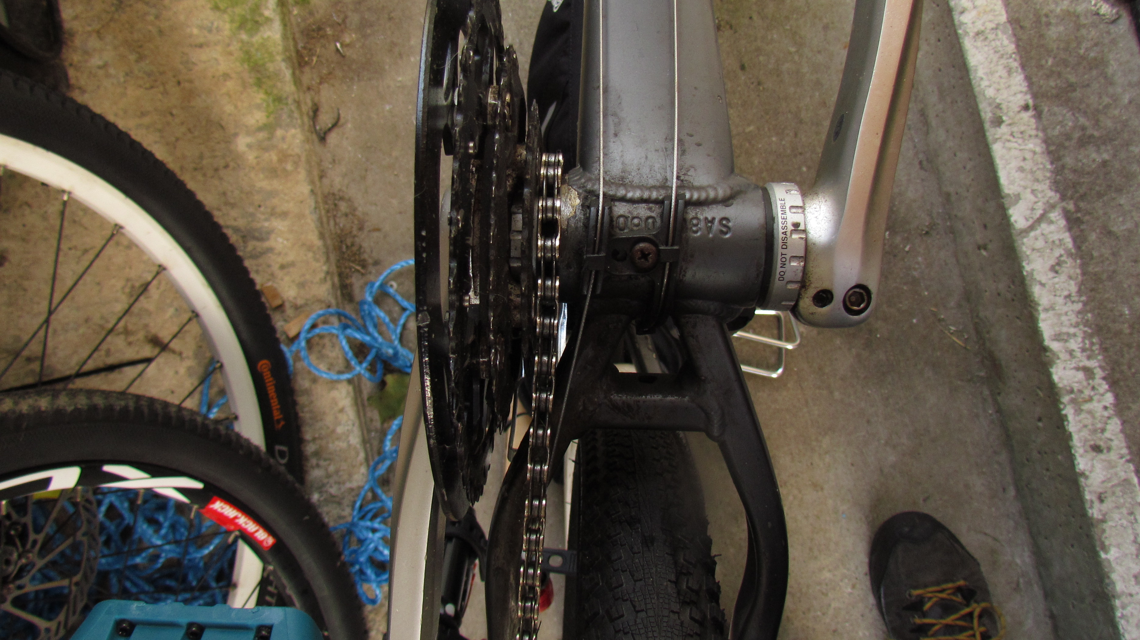

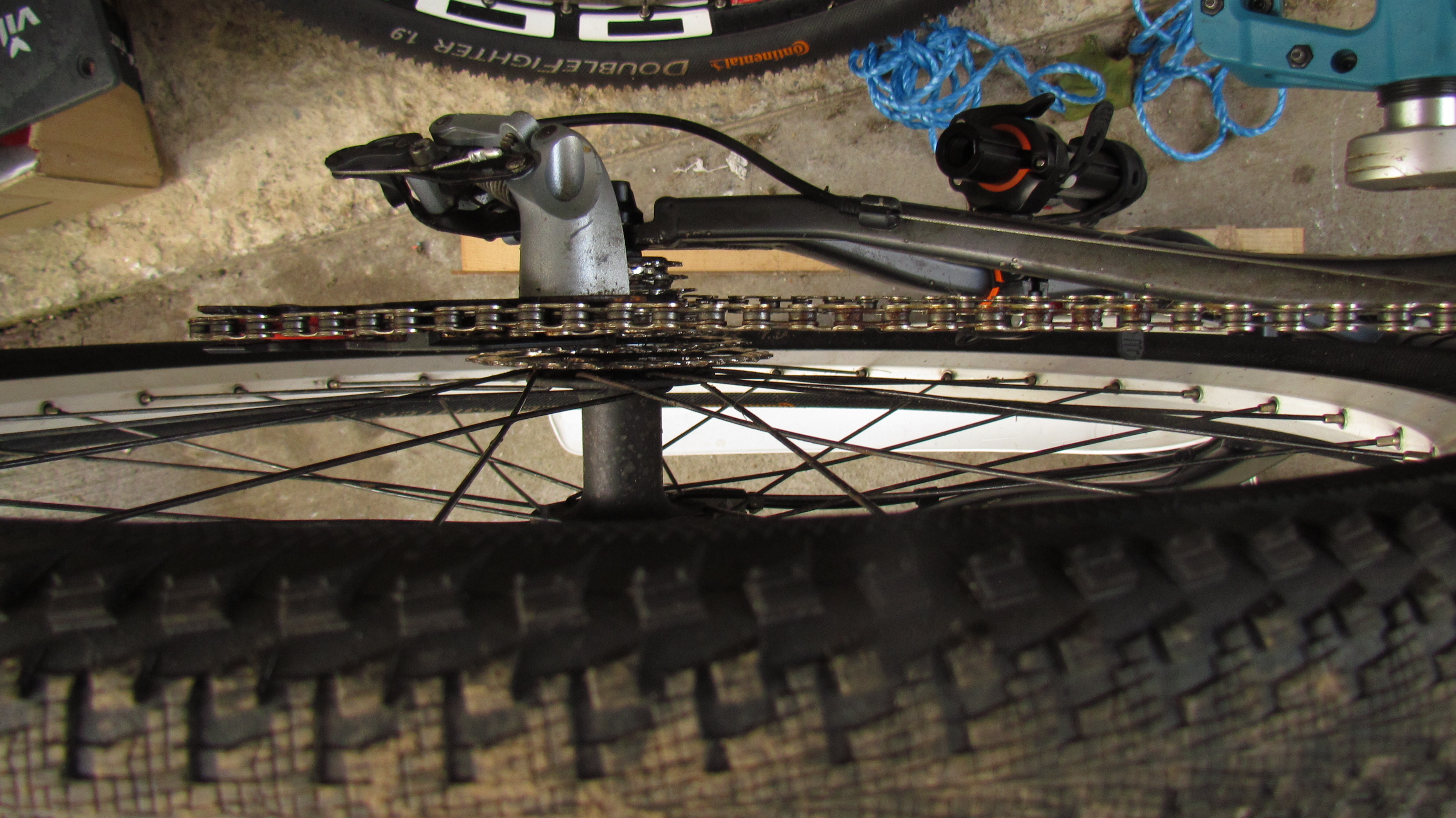

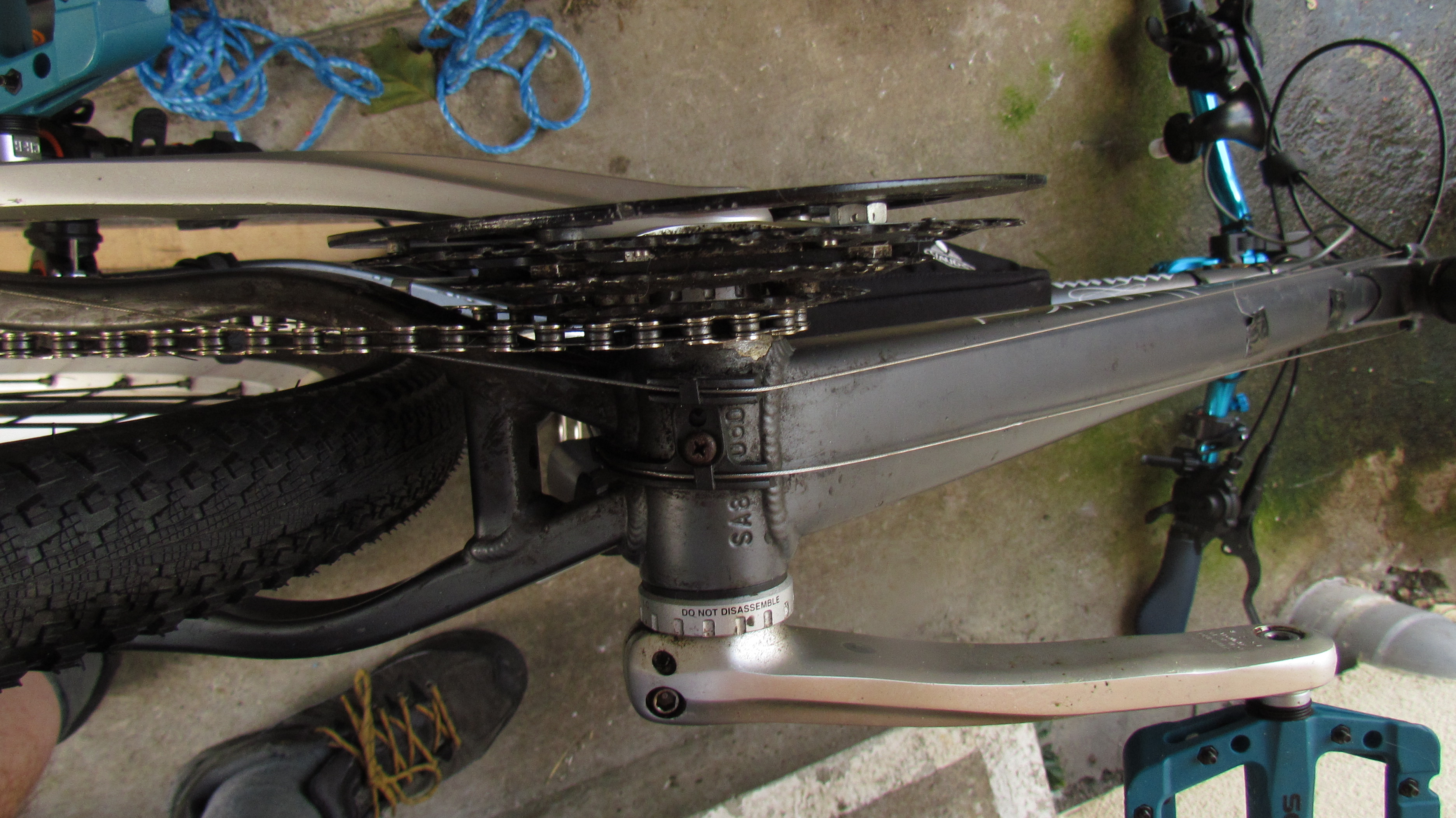

Your bike has a square taper bottom bracket. The only question is whether you have enough room for a pedal sensor. Turn the bike upside down and take a photo od the whole arrangement, like in the second photo in this thread:
https://www.pedelecs.co.uk/forum/threads/rocky-mountain-element-conversion.12481/

"Square" bottom bracket" ???
I do also have hollowtech XT cranks etc !

hollowtech cranks are actually hollow i think (i googled em before my own purchase)

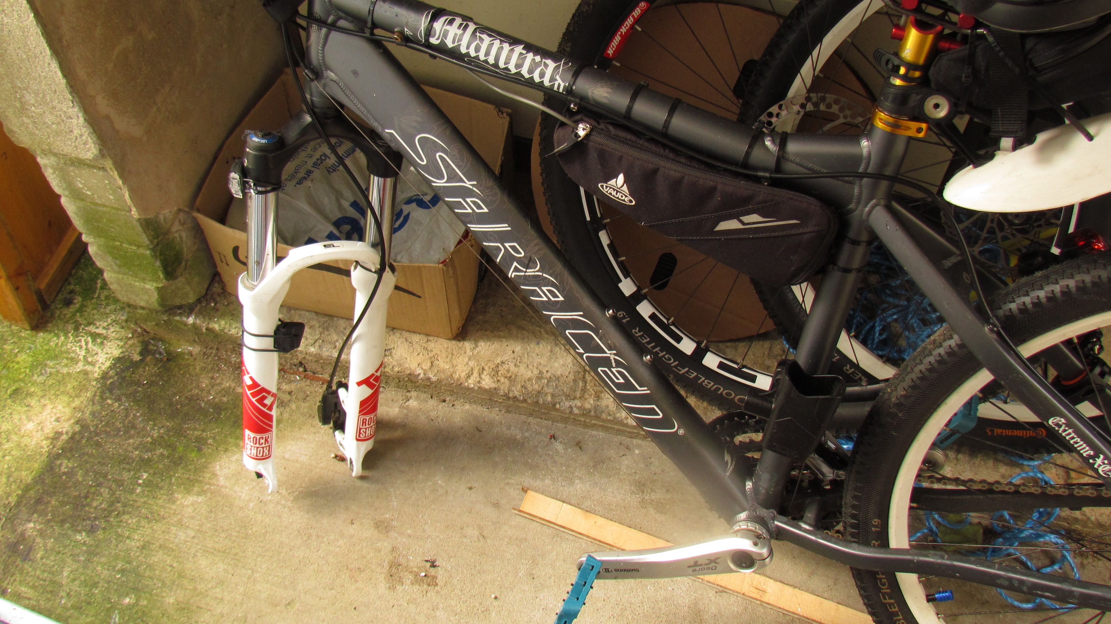

I dont think the 'standard' pas sensor will fit as your pic 1602 looks close to the red crossed crank pic from the suppliers site.
However thats not a big problem just a hiccup.
I visited the suppliers ad page and the pas sensor in their parts list
looks like it would be very easy to add to the front or rear wheel without too much difficulty.
the ring of magnets just needs to turn when you want the motor to engage if turned by the crank or the wheel isnt really important just as long as the magnets spin and the sensor is strapped to the frame close enough to register.

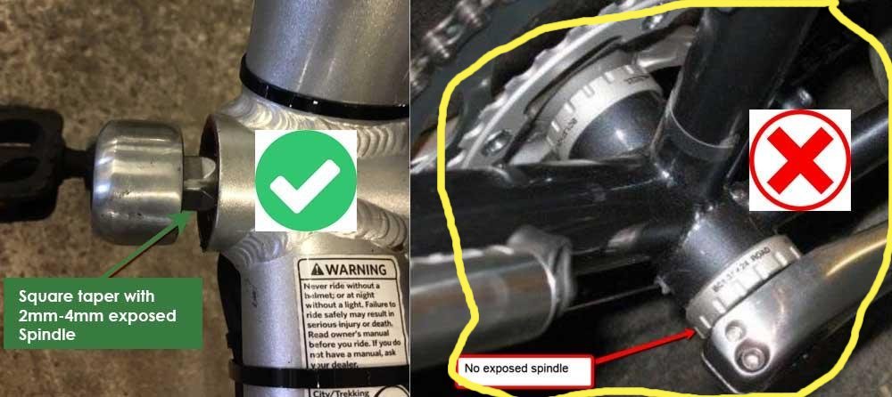

For hollowtech BB or similar you need the BZ10C PAS set up, though you will have to lose the small chain ring to fit the disc. Other wise for sq taper use a std two piece 8 pole PAS.

Your bike looks like a fine candidate for a kit imho regardless of pas sensor options. .
