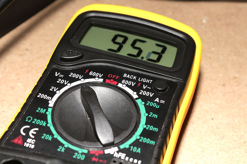

Alas my cheap XL830L is no longer reasonably accurate. This is when connected to a 42V charger. Everything I've measured on the 200V scale over 20V, is at least doubled. I've changed the battery to no avail. Measures <20V fine on the 20V scale. This multimeter was reasonably accurate, but not reasonably robust!

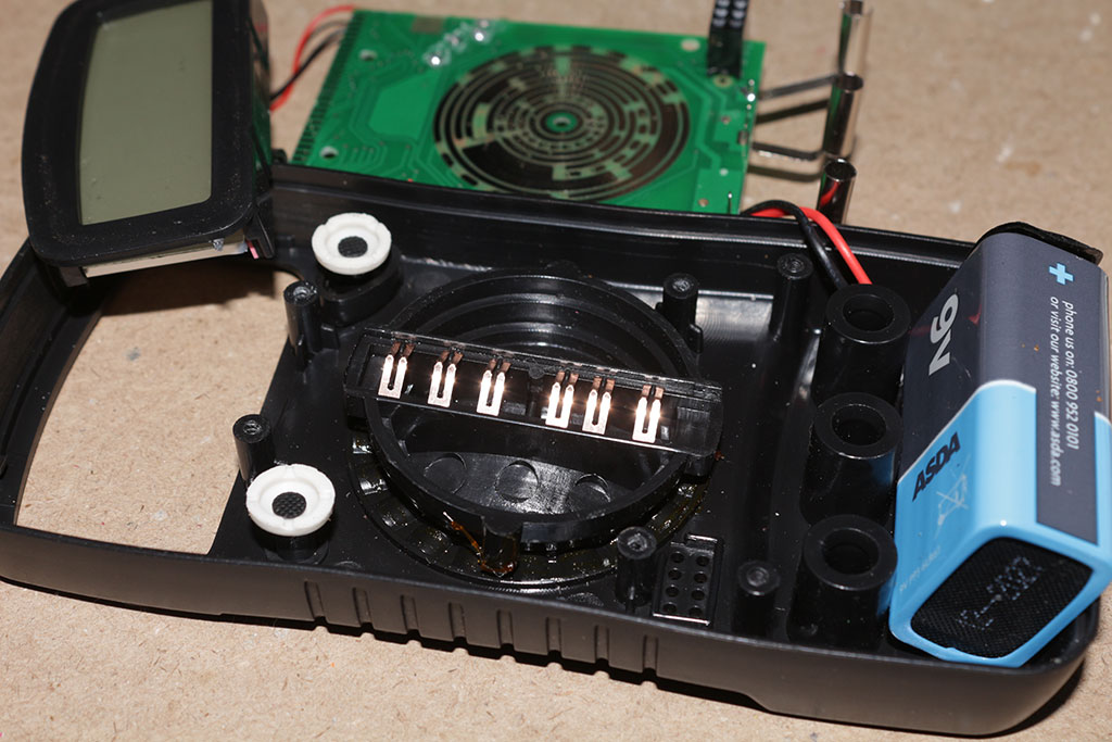

Try wiping the switch contacts with meths.
Thank you for your suggestion, I cleaned the copper contacts and wheel but it didn't work - my 36V battery measures a very impressive 82.3V. I may try again, scrubbing harder.
I'll buy another digital multimeter, because I really should own more than one.
EDIT: After another serious scrub with both isopropyl and meths, same high voltage results.

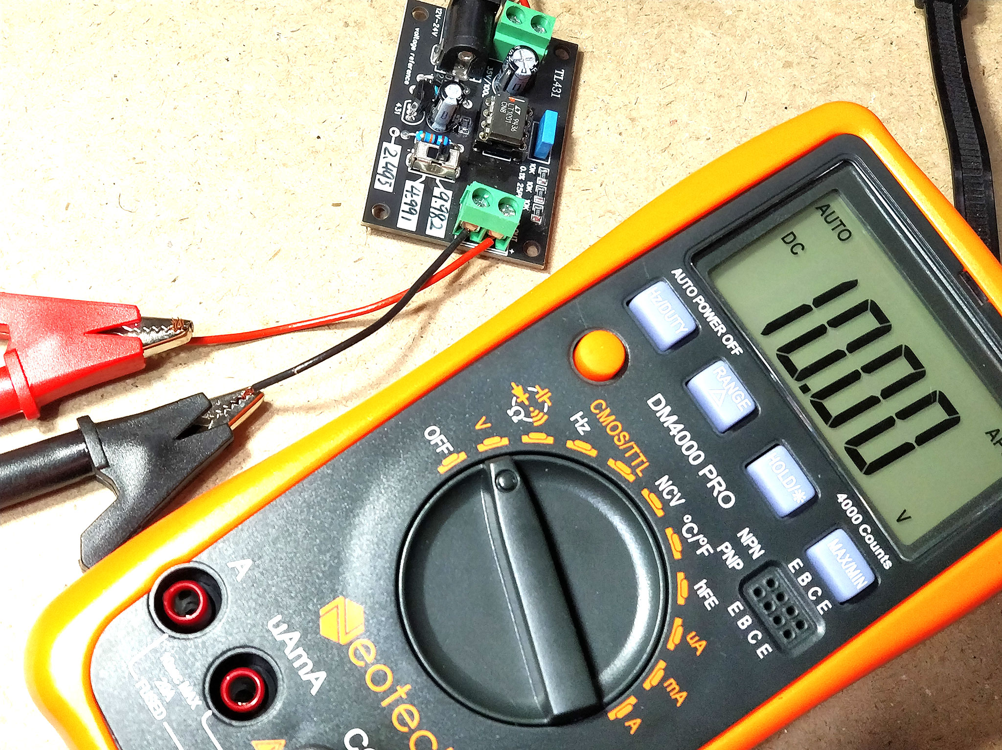

The reference board's 9.982V measured 13.8V in the 20V range... my multimeter previously known as reasonably accurate is kaput. I'm bound to break another somehow, so it's not worth spending much - as you know, I know practically nothing about electronics, and wouldn't have anything to do with multimeters if I didn't have an ebike.

EDIT: Now it's measuring 0V, no matter what o_O

EDIT: Now the reference board's 9.982V measures 11.8V in the 20V range. It's a dodo.

...tested with the reference board, it appears that this is another cheap but reasonably accurate multimeter. Your voltage may vary. Thank you [mention=35625]AntonyC[/mention] for posting a link to this multimeter.
