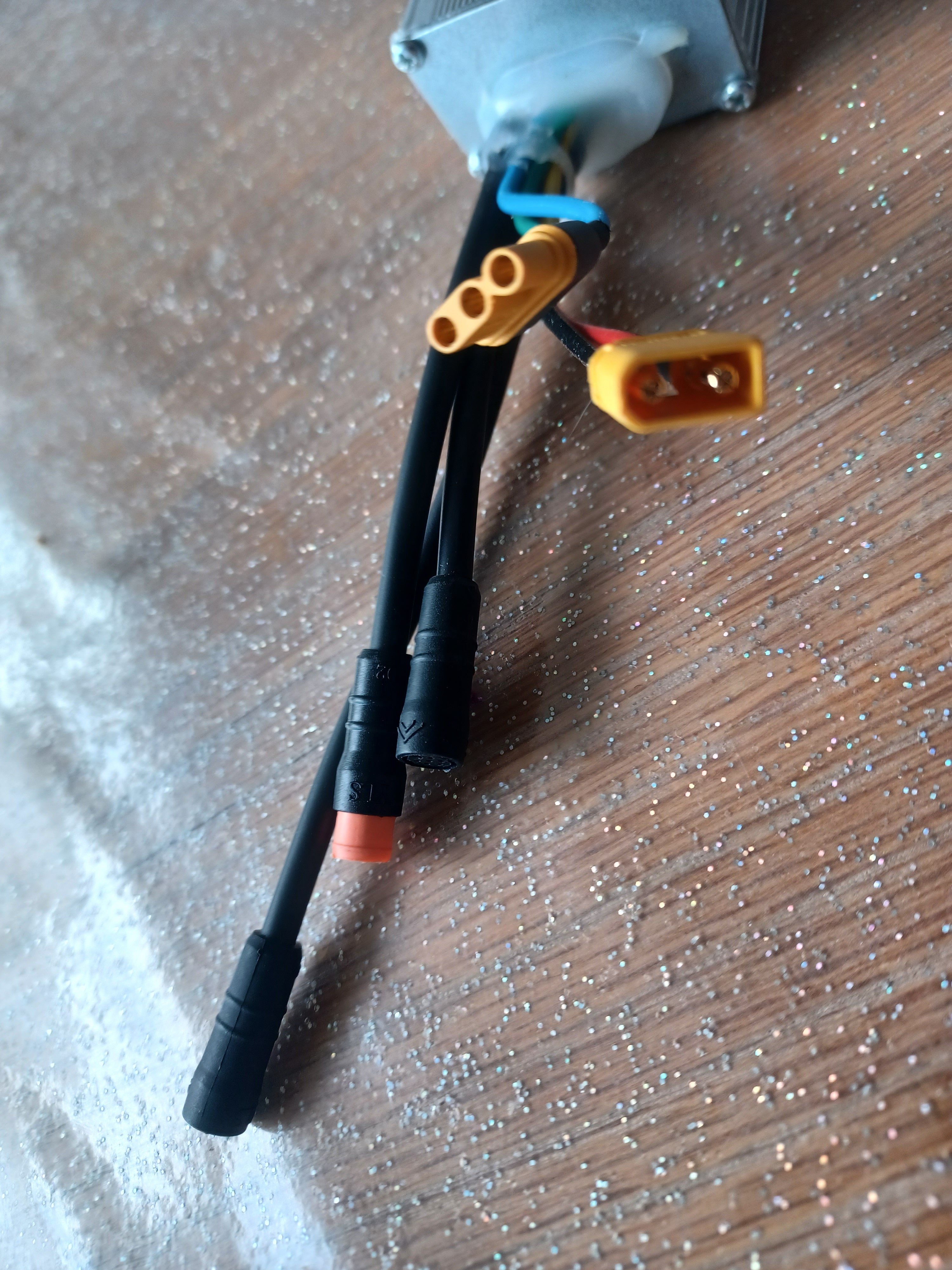

The picture is of what I believe a Gen 2 controller looks like, but I’ve not had my hands on one personally!
The controller in the Swytch pack uses YLS connectors for the display, PAS etc, these are smaller than the normal Julet type. Then a XT30 for the battery and 3 pin MR30 for the motor phases. These connectors then feed into the connector on the back of the pack.
The matching connector on the handlebars then converts these connections into the more normal Julet and motor connectors found on KT controllers etc. The exception is the brake sensors which are 4 pin blue Julet, KT setups tend to use 3 pin orange julet or two pin red Julet.
Getting Julet cables for extensions is easy enough, dont know where you get the YLS type.
