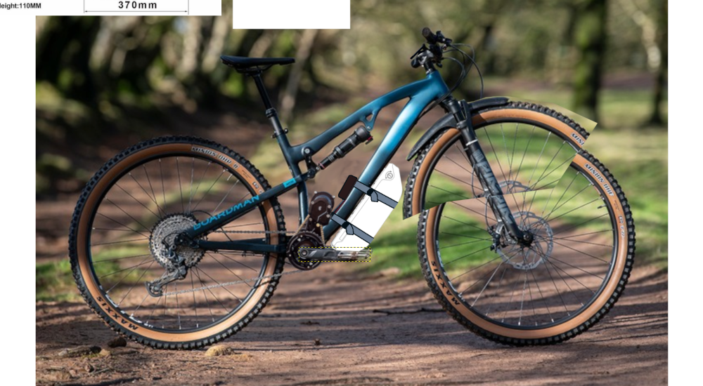

I'm planning on mounting the battery under the downtube using a hose clamp mounting bracket, I'll also use heavy duty mounting straps to keep the battery on while riding, I'm planning on making a battery protection plate out of kydex which will directly attach directly to the battery.
Below is a pretty basic plan I made
As you can see there's enough clearance for the front suspension. I never ride hard enough for the front suspension to bottom out anyways, despite the bike I don't actually ride trails that'd make the most out of this bike lol, I got a good deal on the bike a few months back and eventually decided that I'd convert it into an ebike.
[ATTACH type=full" alt="56013]56013[/ATTACH]
I don't like to be negative, but I think the project is a non-starter. If you want an electric bike for riding only on the road, get yourself a cheap used disc brake MTB for about £100 - £150 and either sell that Boardman or keep it for what it's designed for.
If you run with it, the bike itself is more of a liability than an advantage. Everything about it is working against you. There's insufficient clearance to mount the battery under the frame unless you lock the forks. The gearing won't last 5 minutes with that motor, and even if it did, it's going to be much too low for riding on the road. Finally, that motor is far from ideal for riding on the road.
If you really want an electric bike for riding on the road, figure out the points that would make it ideal, then choose a donor and motor system that give you what you want.

There's enough clearance, I already checked with extra headroom given, I regularly ride and my forks never compress to the level shown in a picture above.
I appreciate your concern but I intend to see this through, with e.g., a bafang kit or something I would still end up spending a similar amount on a quality battery + lekkie chainrings etc, and with the CYC I'm spending quite a bit more on the motor kit itself but it's a one time purchase and I don't need to think about upgrades down the line. I realistically don't intend to run it at 2.5kW constantly. Worst case if I see that this bike is causing me issues I'll fit it onto my older merida big nine mtb and swap to a strong 7 speed groupset etc. Both bikes have the same size chainrings and both have BSA bottom brackets.
I'm curious, what kind of frame would you choose for the CYC X1 PRO (I already bought the kit btw)?
