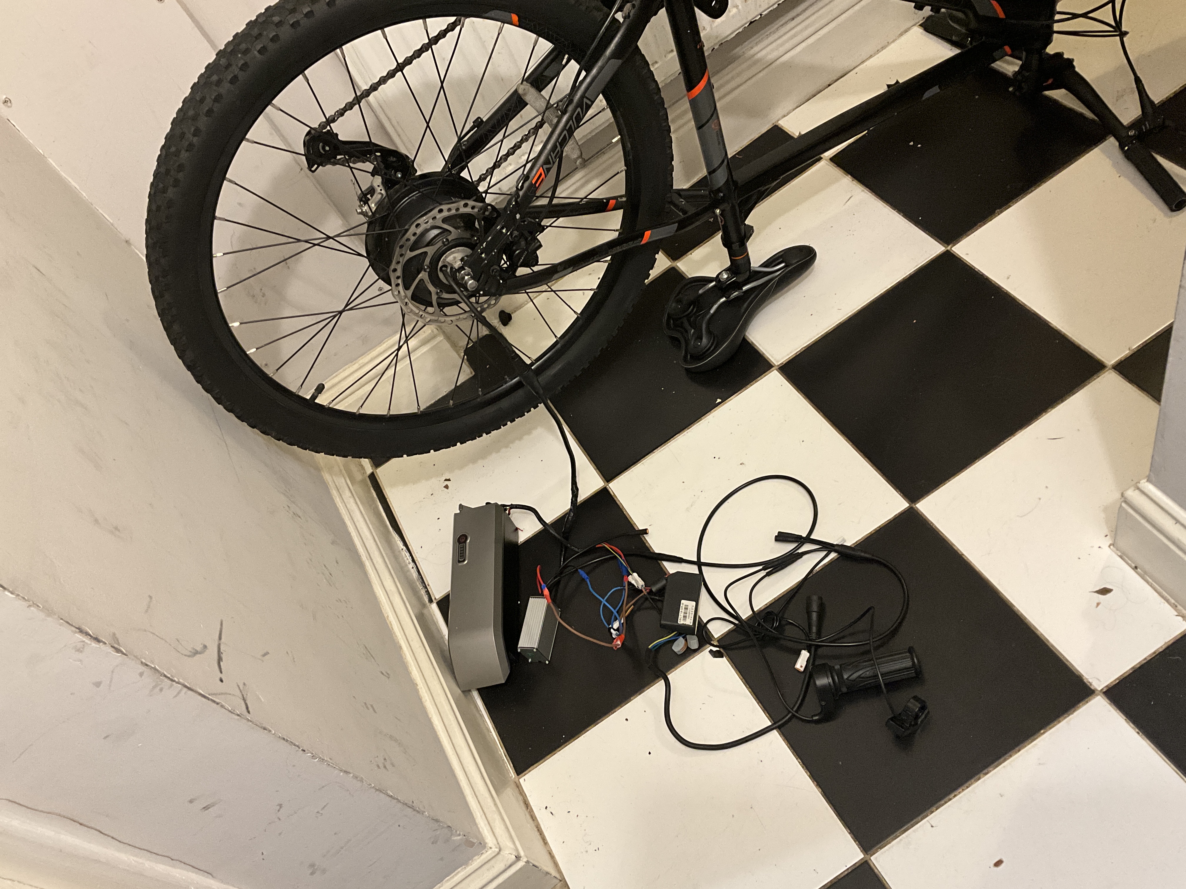

One of the other posts regarding getting round £500 quid Carrera battery handshake does work .
Attached is a motor test set using KT , Suntours combination , which I whished I had set up a few days ago .
I just had to refund a guy on e bay for for a Suntour motor and wheel which I could not test after buying a job lot of ex display bikes
this one works fine with a throttle .
but I would still like to put an after market BMS in this battery as I can no longer sell it on e bay .
