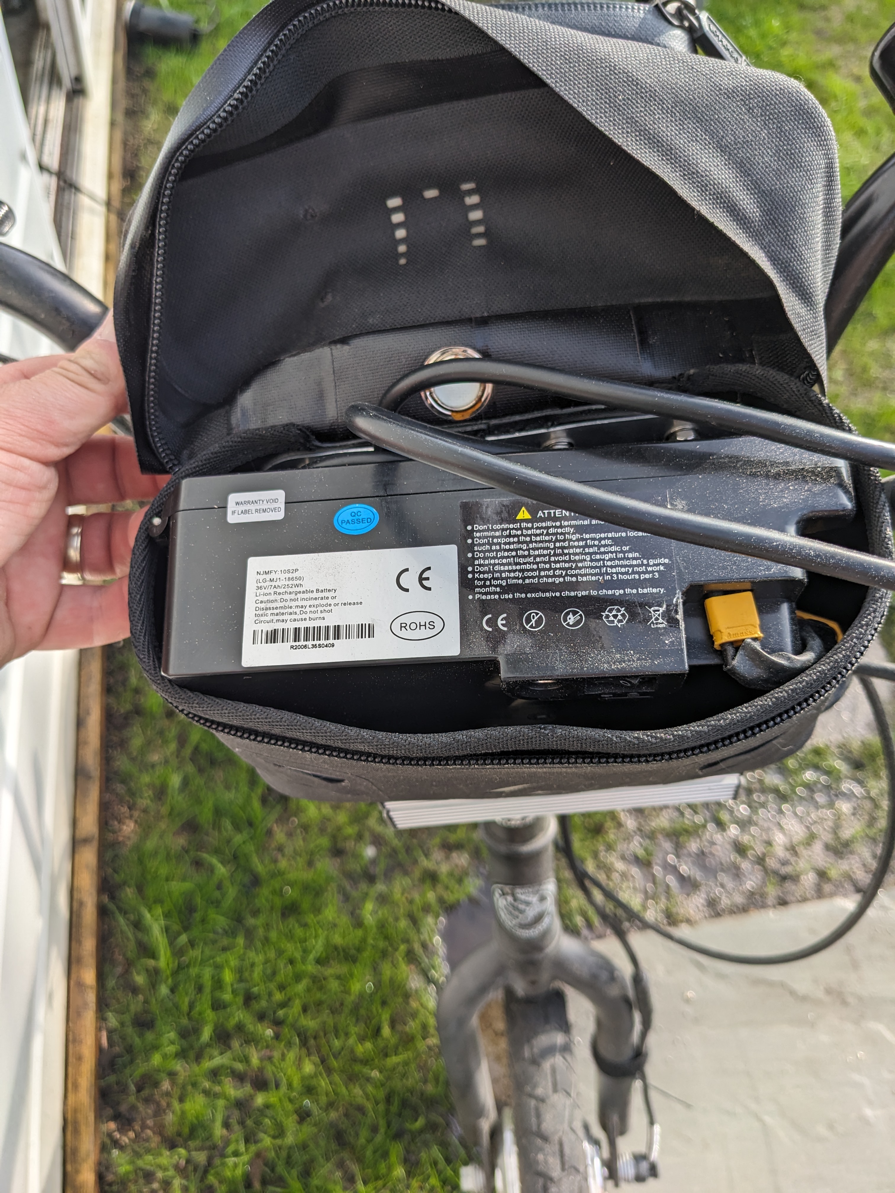

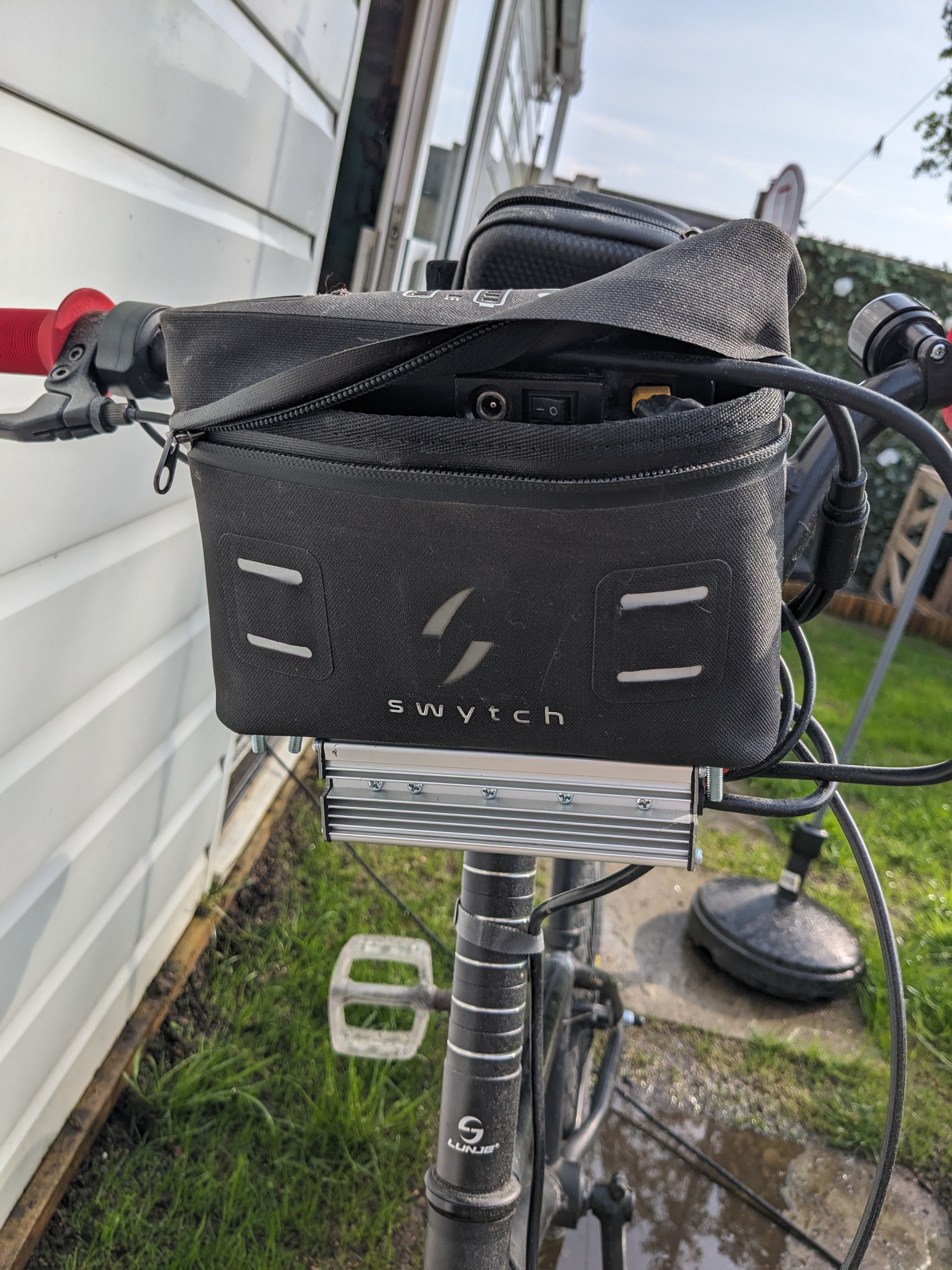

May 10, 20241 yr So I have the remains of a Swytch Kit, basically just the hub and the battery. I replaced the controller with a KT controller and all the wiring to make it work. Recently the battery isn't quite lasting long enough for my commute. I've had it for quite a few years so it's had a lot of use. What would be a good replacement for the swytch battery, preferably one that will fit in the same case? Thanks
May 10, 20241 yr Maybe provide a picture or a link to the Swytch 'case' so everyone is clear on which one you have ?
May 10, 20241 yr I have one of them, which I stopped using. The battery inside is nothing I ever saw as 'standard' although you can probably have one custom built to fit, maybe £250+ ish ........
May 10, 20241 yr Author Could you recommend anything else if I did ditch the case. I would probably need to be able to mount it on the handlebars as this is on a bmx so I have limited options to where it goes.
May 10, 20241 yr Look on ebay for 36v softpack battery, one may be able to find one that fits . You will of course make sure you measure the size correctly . You don't give us much at all to go on , no dimensions or even a pic of the battery or inside the case/bag. Edited May 10, 20241 yr by Nealh

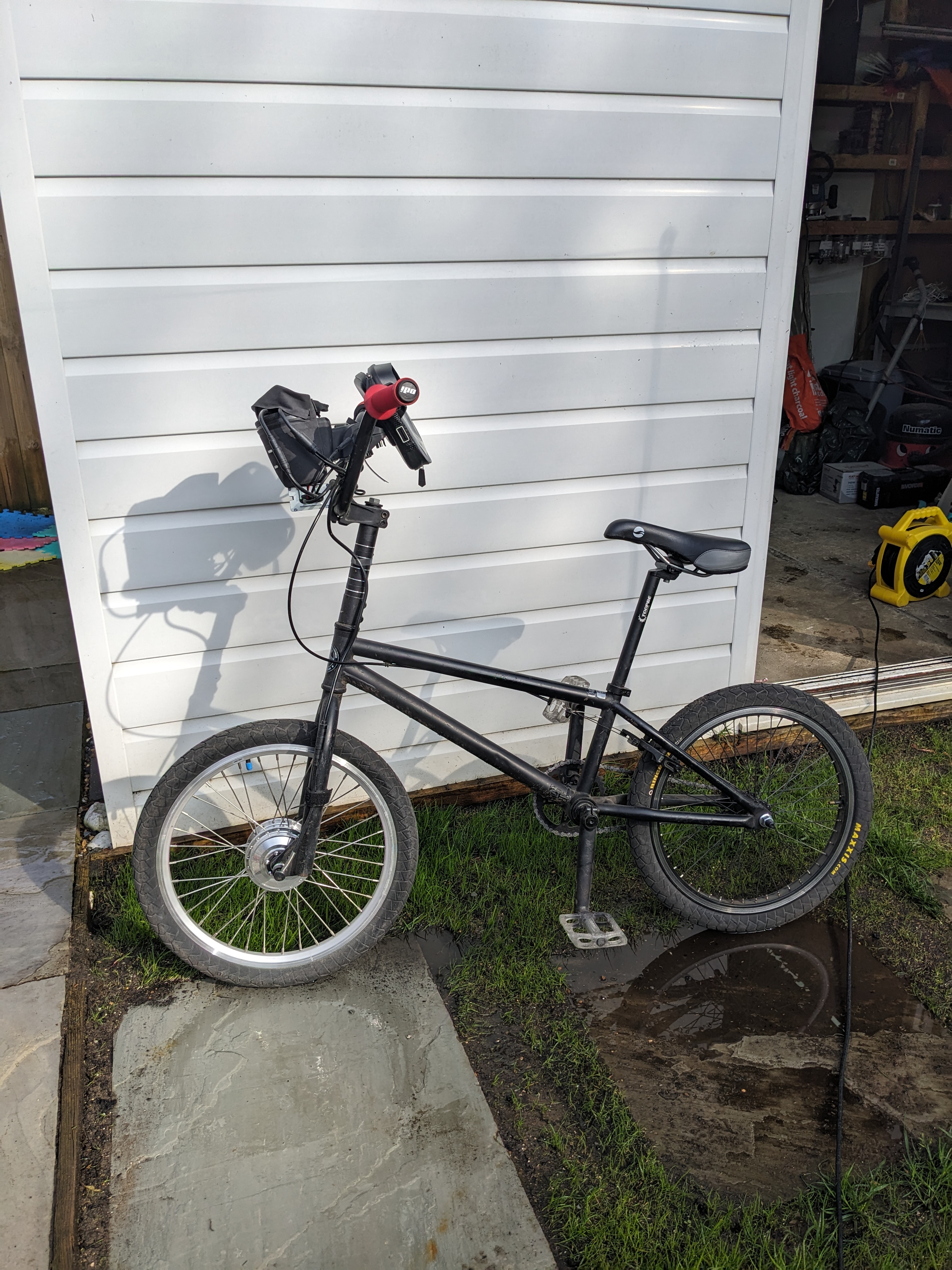

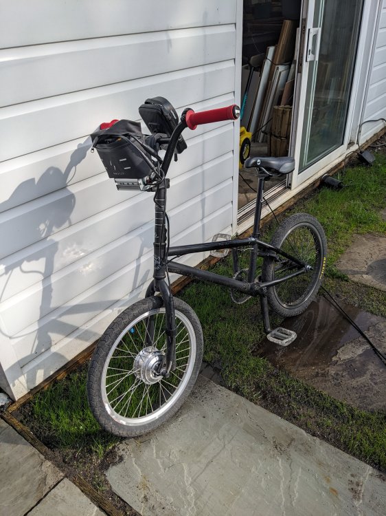

May 11, 20241 yr Author Thanks for the advice so far and apologies for the lack of photos. I will try and take some today. It's not quite a standard Bmx, I have raised the seat post and the handlebars to make it a bit more comfortable. The point of installing the kit is to make my commute a bit easier, it's quite a hilly ride. I am not doing tricks on it. It's really fun too, I love it everytime I go out on it.
May 11, 20241 yr Thanks for the advice so far and apologies for the lack of photos. I will try and take some today. It's not quite a standard Bmx, I have raised the seat post and the handlebars to make it a bit more comfortable. The point of installing the kit is to make my commute a bit easier, it's quite a hilly ride. I am not doing tricks on it. It's really fun too, I love it everytime I go out on it. That is very surprising to hear about BMX used as commuter. Simply because they are not designed for that purpose. I am looking forward to see pictures of your bike.
May 11, 20241 yr Thanks for the advice so far and apologies for the lack of photos. I will try and take some today. It's not quite a standard Bmx, I have raised the seat post and the handlebars to make it a bit more comfortable. The point of installing the kit is to make my commute a bit easier, it's quite a hilly ride. I am not doing tricks on it. It's really fun too, I love it everytime I go out on it. I've got something like that (a Mk 1 Swytch) which I modified to reduce the bag profile and relocated a battery to a rear pannier (a Yose 36V). I like it - it is a different feel from the heavier Decathlon 500s I also have. I can also use it for shorter journeys with Bosch 36V batteries. See a previous posts ( here is an example but there are pictures somewhere). Peter Edited May 11, 20241 yr by peterjd
May 11, 20241 yr So I have the remains of a Swytch Kit, basically just the hub and the battery. I replaced the controller with a KT controller and all the wiring to make it work. Recently the battery isn't quite lasting long enough for my commute. Can you stop fast enough when you need to? If not, is there any way to install a front brake? Is your commute fairly flat? You've got the wheeled advantage for climbing hills, but with limited ease for your battery and you, because of course your BMX is a fixie. I imagine steep hill climbs could be difficult.

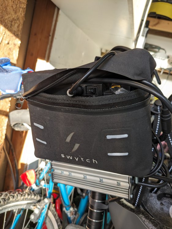

May 11, 20241 yr Here are some pictures of my bike. [ATTACH type=full" alt="57668]57668[/ATTACH][ATTACH type=full" alt="57669]57669[/ATTACH][ATTACH type=full" alt="57670]57670[/ATTACH][ATTACH type=full" alt="57671]57671[/ATTACH] The bag is too high to hold a heavy weight. You should get a downtube battery, put some rivnuts in the crossbar and mount it there, or make a rack for it and fit a battery there. Either of those two methods will make your bike handle a lot better.
