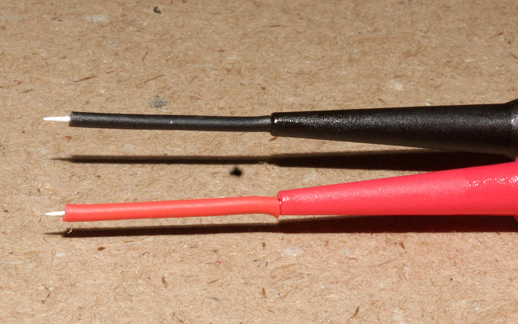

Hope that maintenance guy knows his stuff. The last time I measured cell bank voltages, unlike this dude, I measured at the tiny connector peering at needle probes through a big illuminated magnifying glass.
