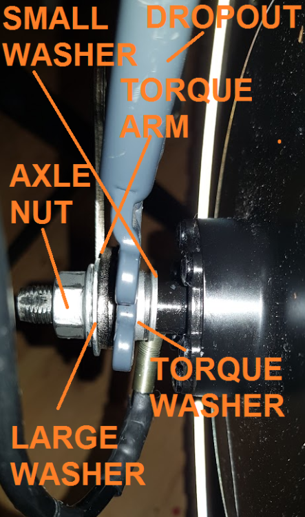

I'm not really a mechanical guy so here we go...I noticed my rear hub was starting to spin out of dropout on drive side and didn't have a spanner to tighten it back up when I was out.
This is the current setup as it came back from bike guy I just wanted to check the order of where the dropout should go and QA what I got back from shop. I have read that the Axle nut should be on outside on drive side and NOT have a washer on the outside of dropout but I think when I got bike it did have washer on with the flat cutout outside as per the pic, it cannot go in inside as it will block the torque washer and stop it sitting in the dropout?
Can anyone clarify what the order should be to maximise the 'grip' in the drop out?
What is the nut that has a corner cut off it for, is it to stop the washer hitting the silver part on left dropout, is it required?
Is this setup recommended or are there better more secure ways? I guess threadlocker will make zero difference due to the forces involved?
I am working on a 3D Tinkercad design for drive side torque arm that will use the two screws on dropout that the old derailleur guard used to screw on to to stop this happening again. It will be two 1mm thick metal plates.
Also, is this OK for non-drive side? Dropout goes between torque nut (lined up properly) and torque arm?
Thanks

The axle nuts do have the serrated inside edges for grip however the washer on drive side next to axle nut doesn't, just a plain washer, I have seen some one-sided serrated washers in that position and will look to see if I have any.
Is there any advantage to adding a second axle nut to each end of the axle if I have the space to add additional 'clamp'?

Rear wheel was secure for a good few months before I had to get bearings and cassette replaced and bike guy didn't torque up enough, partly my fault for not doing usual check and also marking nuts with sharpie straight line to monitor torque.
Dropout slop not as bad as it looks partly due to camera angle, the allen nut isn't tight so it's slipped a little.
A custom 3D printed torque arm will be going on to drive side (cannot find any arm on market that will fit on drive side), and other side upgraded to a 5mm hammer torque arm.
If there is a smarter way of setting up the bike I'm all ears/eyes etc., but not yet ready to bin this frame after time and effort put in so far.

Thanks for the detailed response, the axle is 12x10 btw.
So if I'm understanding you what I should be doing is removing the derailleur and bolt and the cut nut on other side.
Then put in the hub/axle using the full dropout width (I like that idea!)
Finally put the derailleur on tight against frame, hold i place, then a washer then the axle nut. Forget about the bolt hole on the derailleur as the axle but will keep derailleur in place?
So this is how it is now and I 'lose' half the dropout width:
And this is what you are suggesting?

Remove the bump on the derailleur hanger and remove material from the hanger if necessary to clear the raised area on the frame ( I don't think that is required as the area where the hanger sits appears to be raised anyway) . The hanger is usually aluminium so nothing more than a file is needed.
Looking at your new position pic it looks like the dropout has spread anyway so moving it further back is definitely a good idea.
Well I had a go at this tonight with just a bottle of red wine for company...funny how as the bottle drains you get more 'confident'...
The hub axle is now sat tight in the end of the dropouts, that has had a few minor side effects as the drive train is now probably 2cm longer and wheel sits 'higher'.
1. I've adjusted the brake pads down so they now hit rim and not tyre.
2. The chain seems a little tight so maybe needs an extra link or two
3. Not yet sanded down the bump on derailleur, when I tighten it all up the derailleur actually sits not too bad so sanding is not top of list but I will do it, tightish chain not helping though at moment.
4. non-drive side torque arm no longer fits in configuration used before, I think what's in pics below should work by changing orientation of one of the floating pieces as it's the bolt that holds the two pieces together that is fouling on frame as it sits higher.
5. looks like I may be able to get one of these torque arms on to drive side too as now there is now space (by a fraction), for the bolt that holds the two pieces together if I configure like in this pic.
6. will need to redo the derailleur Hi/Lo/B screws etc. to sort gear changes given it's now moved position
If this works out I will replace the torque arms with similar more heavier duty ones as long as additional width doesn't scupper anything - are there any better ways to add torque arms that the configurations I've used?
This is latest version of drive side (loose):
Spacing is:
This is latest version of non-drive side:
Spacing is:
Any comments on what I've done or should've done differently?
