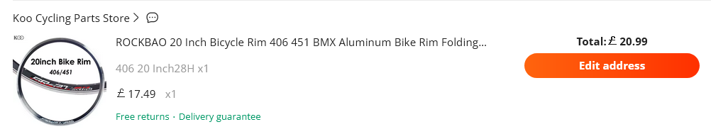

November 27, 20241 yr Author Thank you everyone for their searching of the hopelessly confounding AliExpress, and advice. Looks like I will be building my first wheels. I've merely been adjusting wheels until now, because they've been cheaper to buy than build. However, cheap new wheels are bloody rare when it becomes suddenly apparent you need new rims. While my existing front rim continues to be worn away, I can reuse my Helios's original 20H Dahon front hub... because by some miracle I found AliExpress's DeSearching Dicombombobulation Engine randomly presented me with this rim . This was so unexpected a happening, I'm still reeling from the shock. According to the listing, these Rockbao rims have 20mm inner rim width. I'll believe it when I measure it. Might even be the same width all the way around. I've never seen Rockbao branded stuff before. Wasn't on AliExpress in January, but how would I know if it was? It's AliExpress. https://vi.aliexpress.com/item/1005005929015035.html The above looks very similar in size to the original rim, and as such I'm hoping I'll be able to re-use the old spokes and nipples, but knowing my luck I'll have to buy new ones. Also bought this for the next rear wheel build, using one of the 28H hubs I already have. Bought another for spare 28H front or rear hubs. Couldn't stop myself buying this Rockbao 28H front as a spare... ...all while I look further into the viability of fitting extremely fat tyres on my Dahon Helios (there may not be clearance for wider than 2.125"), with wider mudguards to match, expanding from my present 1.75" wide tyres, as the pothole situation becomes ever more horriffyingly hairy and dicey out on them thar desolate pitiless Mad Max roads. Edited November 27, 20241 yr by guerney
November 27, 20241 yr The above looks very similar in size to the original rim, and as such I'm hoping I'll be able to re-use the old spokes and nipples, but knowing my luck I'll have to buy new ones. The rims look well and are like the newer deeper rims fitted to some of the more recent hub motor kits . You may need shorter spokes but using the existing spokes and adding one more cross to the spoke pattern can use up 5 to 7mm and this sometimes works.
November 28, 20241 yr Author The rims look well and are like the newer deeper rims fitted to some of the more recent hub motor kits . You may need shorter spokes but using the existing spokes and adding one more cross to the spoke pattern can use up 5 to 7mm and this sometimes works. Thanks, that's a good idea. According to Pythagoras, there isn't a massive difference in spoke length in 74mm axle vs 100mm axle 20" wheels, the latter are much more numerous, cheaper and available. Any time BankruptBikeParts have dual walled front 20" wheels with 74mm axles and wide rims, at their usual low low prices, they sell out extremely fast - blink and they're gorne. Never available when you need one. Pricey Dahon specialists CH White and his Son also sometimes run out of the wide rimmed ones, and have difficulty sourcing quality for restock. They never have the hub and wide rim combination with the right number of holes needed in stock. I'll build spare wheels using AliExpress sourced bits. I'll have to do some reading about lacing patterns. I'll load a book up on the eReader. Seems perfect reading material to nod off with, perhaps something will be absorbed by my brain overnight. There's also that book [mention=29547]AndyBike[/mention] talked me into buying, which neither of us has actually read. This pattern uses entire extra centimeters, but doesn't look safe: https://www.instructables.com/Twisted-Spoke-Bicycle-Wheel-Lacing---flowers!/ Edited November 28, 20241 yr by guerney
