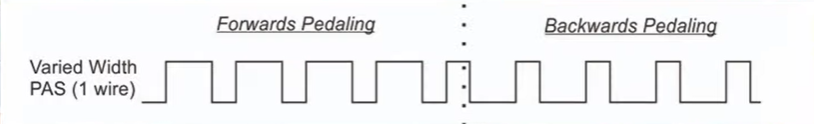

There's also a YT vid demonstrating this principle
, specifically from the 5 min point onwards and the presenter gives the waveform pattern below which supports the written description above.
[ATTACH=full]61762[/ATTACH]

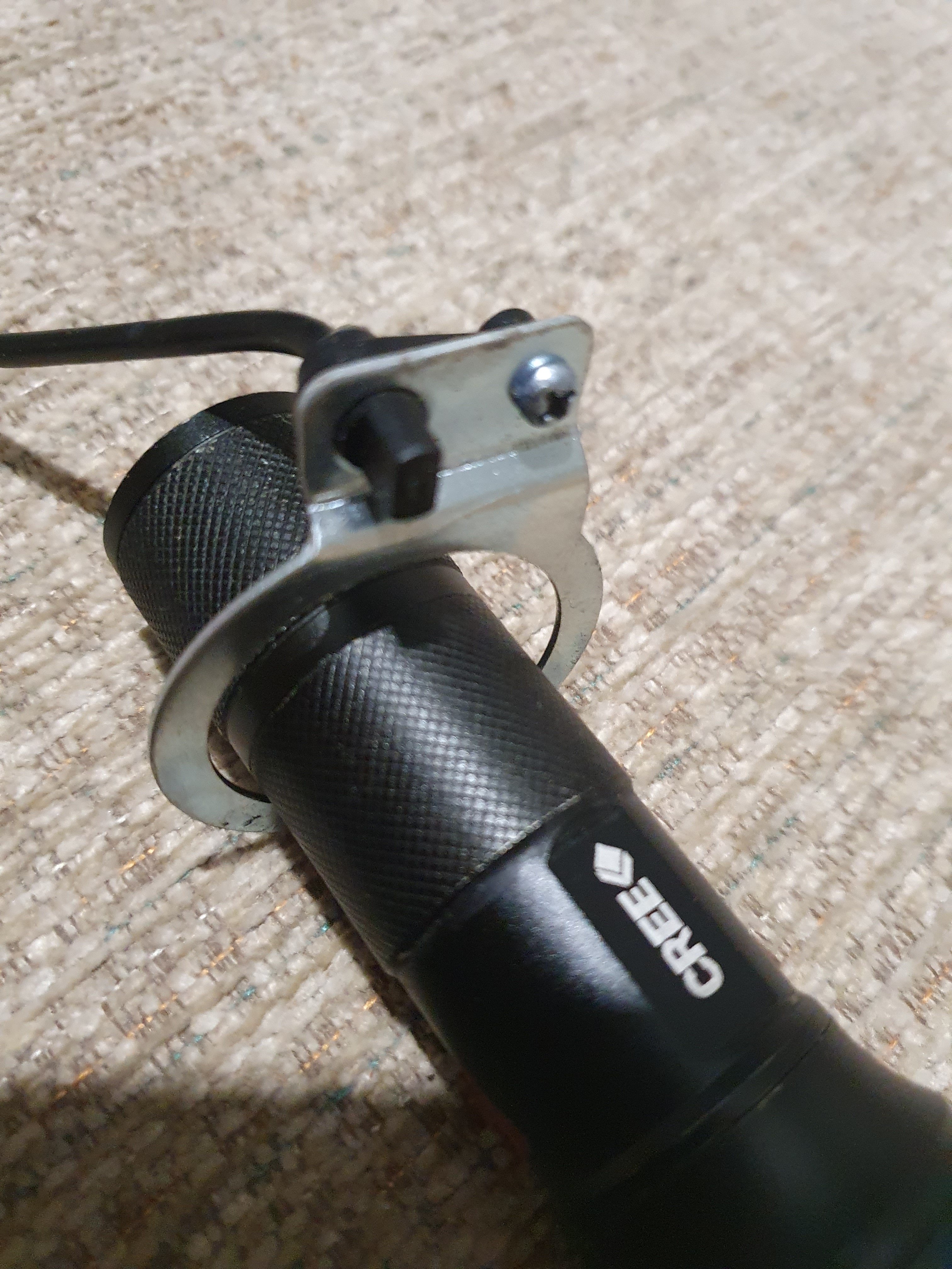

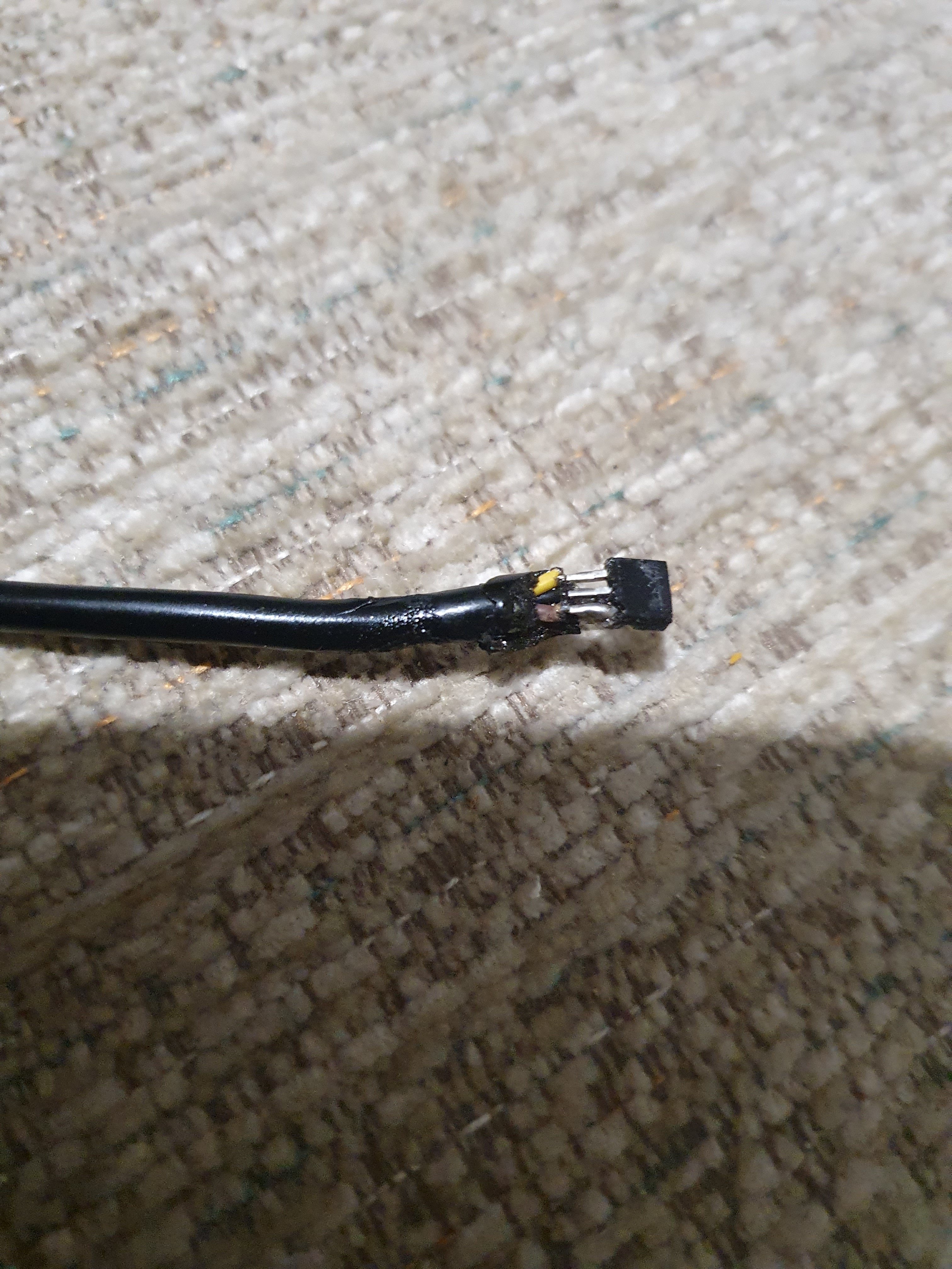

Here's the p;roof. I dismantled one. Dual halls have 4 or 6 legs. Learn from the master, not some irrelevant shite on the internet::

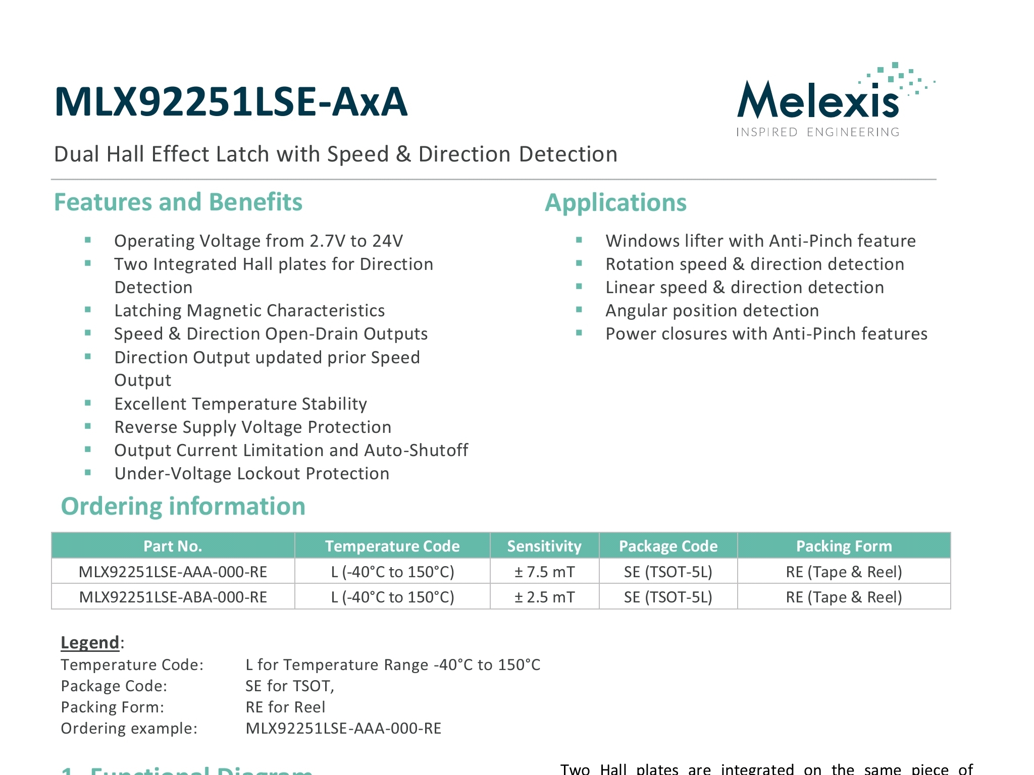

The datasheet is for a 4 pin device with separate outputs for speed and direction, and specifically mentions two hall plates.
I suspect that some of the PAS sensor chips are like this but omit the direction pin and internally decide whether to toggle the speed pin depending on the detected direction.
Screenshot_20250128-223815_AdobeAcrobat.thumb.jpg.54f5a6ae61ec99c8f9c5f05b340a73b3.jpg

Hi [mention=34503]matthewslack[/mention], looking at that data sheet was useful in helping me to understand, in principle at least, how a Hall Sensor with two Hall Plates can determine the direction of rotation of a magnetic ring like that that we see on ebikes.
In simple terms (and happy to be corrected):
  • A single Hall Plate when subjected to a magnetic field (as in the rotating PAS Sensor magnet) produces a Hall Voltage that peaks as the magnet rotates past it. The single Hall Plate working on its own cannot know the direction of the rotation.
  • However, using two Hall Plates (in the same chip) along side each other and in the same plane, (let's call them 'X' and 'Y') can determine the direction of rotation because one plate will see it's Hall Voltage peak before the other. E.g. lets say for clockwise rotation 'X' peaks before 'Y'.
  • Conversely of course for an anti-clockwise rotation 'Y' peaks before 'X'
  • The difference in time between the voltage peaks is referred to as the phase difference* and is easily detected and signal processed within the same chip and of course it is easy to generated a signal output only for when the rotation is in one particular direction.
  • So a 3-pin device, Gnd, Vcc, signal and what from a marketing perspective what might we call such a device - Dual Hall Plate Sensor, Duel Hall Sensor or just a plain old Hall Sensor? I suspect it would get called all three, depending on the audience.
* there's a nice diagram in the datasheet that illustrates this and explains the phase difference phenomenon much better than I can attempt (or understand).
[ATTACH type=full" alt="61952]61952[/ATTACH]
[ATTACH type=full" alt="61954]61954[/ATTACH]
I was never relying on some "irrelevant shite on the internet". Just on my understanding of how Hall effect devices work and 50 odd years working with electronics.
[ATTACH=full]61952[/ATTACH]
[ATTACH=full]61954[/ATTACH]
This doesn't prove anything. Only three pins are required for a direction detecting chip that internally incorporates a dual hall sensor. And that internal dual hall sensor is required for the logic inside to work so that the signal will be present only for one direction of rotation. It is not possible to do that with a single hall sensor and a magnetic ring with uniformly spaced magnets no matter what their orientations are.
