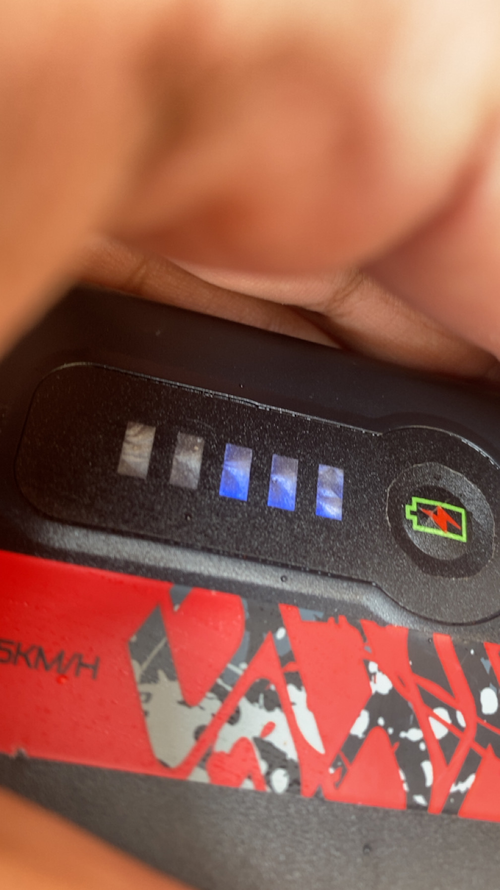

This is the button to check battery. When you hold it, it turns on the bike. I bought this bike from my friend a year or 2 ago and the screen was broken. So I’ve not used the screen since then and it’s never been a problem. I’m wondering what these 3 loght flash is, and how I can solve this.

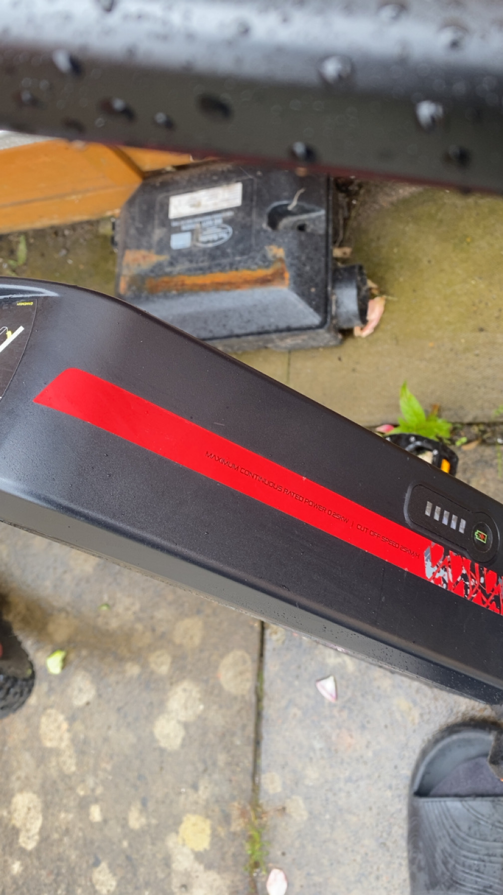

Sorry a bit new to this. These 3 lights flash for about 10 seconds and then stops [ATTACH=full]63624[/ATTACH][ATTACH=full]63625[/ATTACH]
Unfortunately, Suntour don't give out the battery error codes. All we know is that it's indicating an error, which is probably a low cell. If you know anything about electrics, you can open it up and test it.

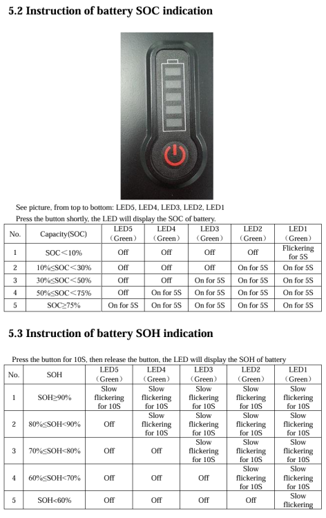

IIRC, it's either an STL battery or a Phylion. If the latter, then 3 flashing LED's only suggests it's wearing out at 70-80% of as new capacity. The fault table below shows that any error would be indicated by just 1 LED flashing at a time, not 3 together.

It's only theoretically knackered; the SOH is based on cycle count, i.e. the number of times it's been fully charged and discharged, often based on a range of between 500 and 800 times depending upon the cells used. That's expected life, not actual.
State of Health (SOH) is just an indication and not an accurate measure of actual battery condition - the BMS is just making assumptions based on count. If the battery has been well looked after (not left overcharged or over discharged for periods of time and not hammered or rinsed by excessive current demands), it may go on for a good while yet.
It might be an idea to check its voltage once it's fully charged. It should ideally be between 41.5 and 42v. Much less than that usually suggests it's near end of life. That's probably a better indication.
