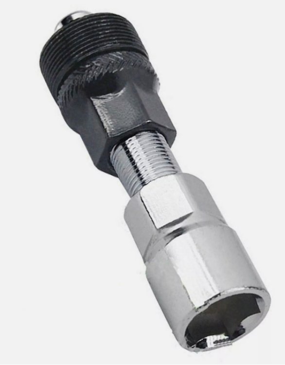

December 5, 2025Dec 5 Hi all I've damaged the thread on this tool, would it be cheaper to just buy a new one, or is there a cheap tap and die set which an make a new thread, if so what size to use
December 5, 2025Dec 5 Hi all I've damaged the thread on this tool, would it be cheaper to just buy a new one, or is there a cheap tap and die set which an make a new thread, if so what size to use https://www.amazon.co.uk/dp/B0948N6P55
December 5, 2025Dec 5 Author https://www.amazon.co.uk/dp/B0948N6P55 This one is much cheaper, only £3.49 to be honest reason why I said about making a new thread as I already have 3 of these tools all damaged so wanted to see if i can repair the threads https://ebay.us/m/XZ0k3f
December 5, 2025Dec 5 This one is much cheaper, only £3.49 to be honest reason why I said about making a new thread as I already have 3 of these tools all damaged so wanted to see if i can repair the threads https://ebay.us/m/XZ0k3f It's very important that they have good threaads. If you dtrip the thread in the pedal arm, you have a big problem to get it off. When you use the tool, you must fully unscrew the middle bit before screwing the large thread into the pedal arm.
December 5, 2025Dec 5 Author It's very important that they have good threaads. If you dtrip the thread in the pedal arm, you have a big problem to get it off. When you use the tool, you must fully unscrew the middle bit before screwing the large thread into the pedal arm. Whats dtrip mean or is that a spelling mistake, btw I always unscrew the middle bit fully but thread on outer bits are all damaged on all 3 maybe just best to buy a new 1 but thats 4 i have then lol I don't need to use the tool for a while anyway as fitted new pedal arm now which is rock solid
December 5, 2025Dec 5 Are you sure you are screwing the tool outer in as far as it will go before winding in the inner? Those threads should be enough for the job if you do.
December 5, 2025Dec 5 Whats dtrip mean or is that a spelling mistake, btw I always unscrew the middle bit fully but thread on outer bits are all damaged on all 3 maybe just best to buy a new 1 but thats 4 i have then lol I don't need to use the tool for a while anyway as fitted new pedal arm now which is rock solid Dtrip means strip, but it might be even worse. I've always used the cheapest tools, and I've used them many times on every type of pedal arm. They still work perfectly and have no damage to the threads. You must be doing something wrong. They should screw in at least half way with just your fingers. If you've had to screw one in with a spanner, you probably had it cross-threaded, which is very easy to do because it's such a fine thread.
December 5, 2025Dec 5 I've always used the cheapest tools, and I've used them many times .......................They still work perfectly and have no damage to the threads. You must be doing something wrong. +1 for that
December 5, 2025Dec 5 If you have a small triangle file (needle file) you can if you're patient clean the damaged thread up as far as it goes. There's actually a tool called a 'thread file' for the job but they're uncommon (and useful)
December 6, 2025Dec 6 It is very easy to strip the outer thread on these - done it myself. When inserting the outer I find the best way is to offer it up then slowly rotate it anti clockwise until you feel it click. Then start to turn it clockwise. This seems to locate the thread square to allow it to thread properly.
December 6, 2025Dec 6 Author Are you sure you are screwing the tool outer in as far as it will go before winding in the inner? Those threads should be enough for the job if you do. First I like to mention, That I was referring to the old crankshaft arm which was a problem removing. i got it off eventually but not using the puller as thread was damaged I have now fitted a new arm. and yes I always unscrew inner part fully . but was just asking if I ever need to remove this new one anytime, but its solid on the spindle so hopefully not.
December 6, 2025Dec 6 Author Dtrip means strip, but it might be even worse. I've always used the cheapest tools, and I've used them many times on every type of pedal arm. They still work perfectly and have no damage to the threads. You must be doing something wrong. They should screw in at least half way with just your fingers. If you've had to screw one in with a spanner, you probably had it cross-threaded, which is very easy to do because it's such a fine thread. Well I think its because old crank arm inner thread was damaged. as tried very careful to screw in the tool. but like i said above I got old arm off eventually. but not using the tool.
December 6, 2025Dec 6 I think we all agree OP must have been doing something wrong. The thing now is to find out what to help him not do it again. The only two issues I can think of have both been covered above. I'm summarizing to help OP, and also in case there is anything I have missed. 0) grease the the thread of the tool (p.s. from later post) Also grease the the thread of the tool 1) Make sure the tool is not cross-threaded 1a) Don't let it happen When inserting the outer I find the best way is to offer it up then slowly rotate it anti clockwise until you feel it click. Then start to turn it clockwise. This seems to locate the thread square to allow it to thread properly. 1b) and make sure it hasn't happened They should screw in at least half way with just your fingers. If you've had to screw one in with a spanner, you probably had it cross-threaded, which is very easy to do because it's such a fine thread. 2) Make sure it is fully wound into the crank before starting to pull. 2a) Don't let the puller prevent fully engaging the tool. When you use the tool, you must fully unscrew the middle bit before screwing the large thread into the pedal arm. 2b) When you have screwed the tool in halfway with fingers as above, you will need a spanner to screw it in all the way. 2c) Just firm. No need for it to be tight; overtightening at this point could even harm the threads. 3) When you have finished and removed the tool from the crank, unwind the centre puller. This means if you are in a hurry when you next use the tool you have already done 1a so can't forget that. Edited December 6, 2025Dec 6 by sjpt

December 6, 2025Dec 6 Author Aye, that one, a very useful tool and I'm surprised to see the price, mine's by Eclipse I think and was made redundant on the same day I was... so it will fix the thread on the crankshaft puller tool as that's a lot larger than what they showing plus it says 0.75-3mm whats size is puller thread
December 6, 2025Dec 6 so it will fix the thread on the crankshaft puller tool as that's a lot larger than what they showing plus it says 0.75-3mm whats size is puller thread The size doesn't matter. It's only the pitch that counts for the file, and that's 1mm.
December 6, 2025Dec 6 Author The size doesn't matter. It's only the pitch that counts for the file, and that's 1mm. So this thread tool will be able to clean or make new thread on the puller
December 6, 2025Dec 6 So this thread tool will be able to clean or make new thread on the puller I wouldn't waste my time on it. You can buy two new tools for the price of that file, and that file can only deal with superficial damage, like when you drop the tool and get a ding in the thread. It's not going to sort out a stripped thread.
December 6, 2025Dec 6 Author I wouldn't waste my time on it. You can buy two new tools for the price of that file, and that file can only deal with superficial damage, like when you drop the tool and get a ding in the thread. It's not going to sort out a stripped thread. Yeah I think its best to just buy a new puller as only about £4
