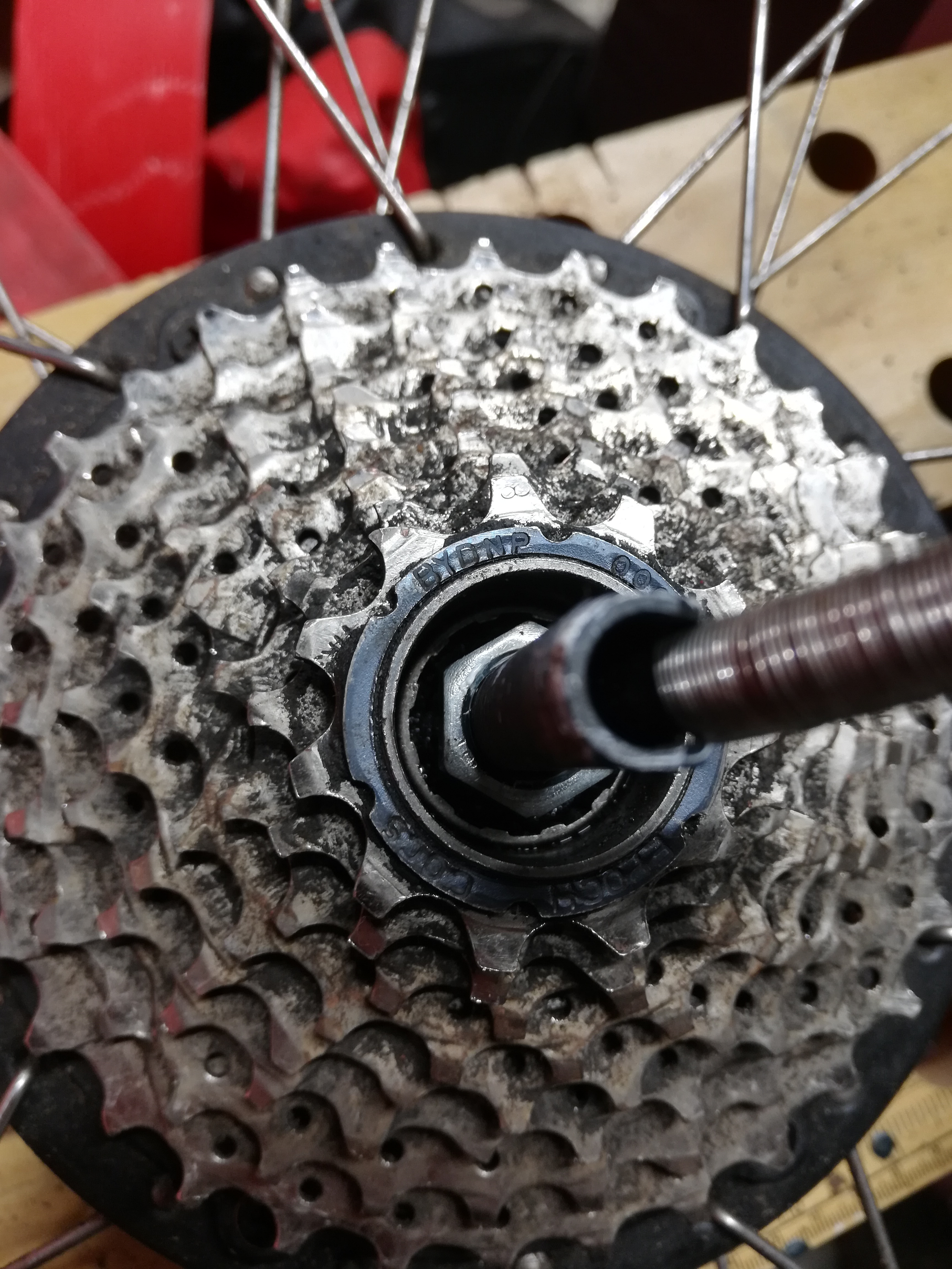

  2. I need to service the freehub on my ncm Moscow, the cassette isn't spinning freely. It spun the cranks and triggered the motor when I wasn't expecting. Bike slipped out of my hands and now I've got a bent derailleur hanger! Any, came to take it off, but the lock ring appears to be deep inside the cassette. Any advice for taking this off or is it a case of finding a tool that can fit inside? I had thought about taking the side of the motor off but I'm not sure if this is a sensible idea.
