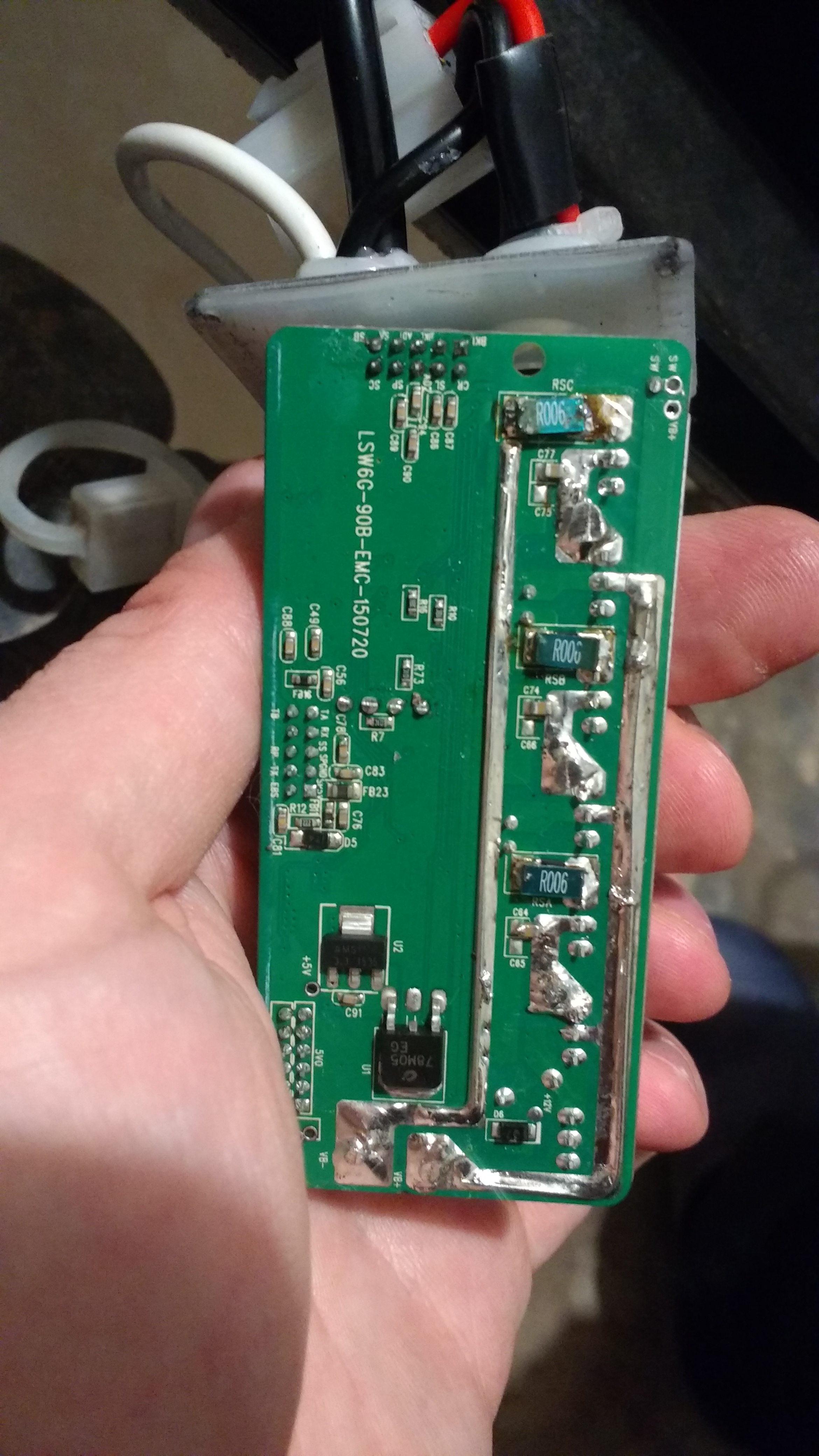

  9. Following on from this thread: http://www.pedelecs.co.uk/forum/threads/oxygen-s-cross-cb-hunt-for-the-shunt.27196/ I've done the deed. Bought 3x R006 resistors rated to 2W and 2512 in size and piggy backed these onto the three R002's on the board. It isn't my finest soldering job, but seems to be ok. Before: After: The piggy backed R006's don't protrude far at all and don't interfere with getting the PCB back into the controller housing at all: . Unfortunately, I've not been able to test it out. My wheel is away for spoke replacement (2 broke on way to work, stupid roads) and a true/tension checking. The bike does still turn on at least so that must be good sign surely?!
  10. Thanks [uSER=4366]@d8veh[/uSER] -I'll take the plunge and put my Ebay order in. Will go for the R006's - If I'm invalidating my warranty I want to do it properly [mention=6303]Woosh[/mention] -I had wondered that too. See post 3 for a pic of the PCB in the case, there is a good few mm of clearance, so hopefully it will clear it. If I find it is a bit too tight I guess I can try varnishing the inside surface of the case or use electricians tape. Hopefully that won't be needed.

  12. Thank you all for the very helpful replies. The R002's used seem on the large size so it looks like 2512 would be the closest fit. As a sanity check - The three R002's created a total resistance of 0.666' mOhm. If I piggy back R006's onto the R002's I'll reduce the total resistance (sum of all resistors in parallel) to 0.5 mOhm. If I use a 10 mOhm resistor that would reduce the total resistance to ~0.57mOhm. I'm tempted to go for the R006's (the maths was nicer!), so something like these: https://tinyurl.com/l4prkjr

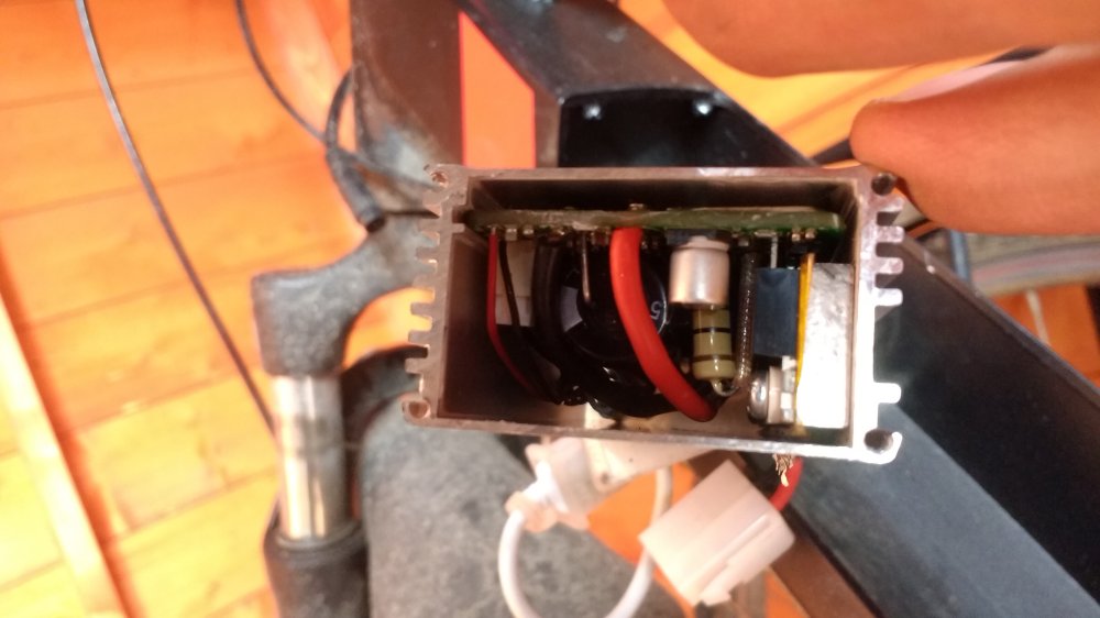

  13. [mention=6303]Woosh[/mention] they are R002 -please see slightly less rubbish photo attached. Looking at the component side of the board there doesn't seem to be anything hidden under the capacitor save for an IC of some sort.

  17. [uSER=4366]@d8veh[/uSER] - Thanks, I did take a good look around the PCB, but didn't look too closely under the capacitor. There is a rather large resistor adjacent to it (see attached rubbish photo). When I have a chance I'll take another closer look.

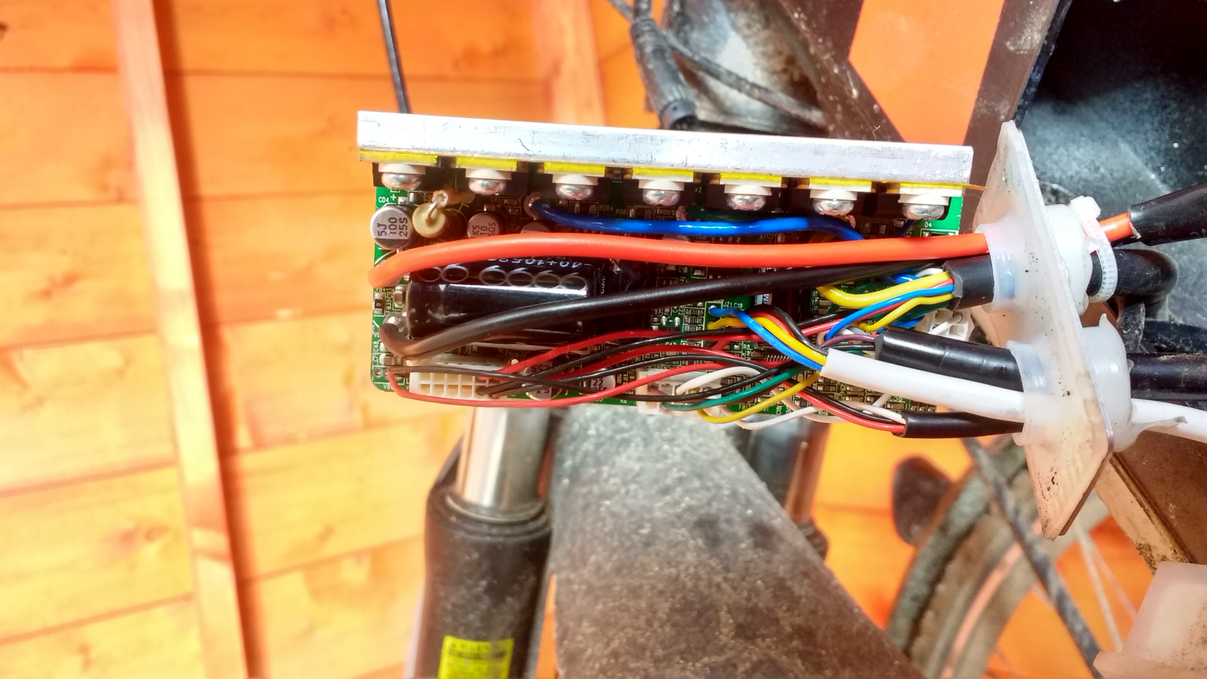

  18. I've been reading (always dangerous) about doing things to my shunt in my S-Cross CB. I found the controller and had a look, but have failed to identify anything that looks like a shunt save for some really heavy solder tracks, but guess these could be for heat dissipation. Anyone have any ideas?
