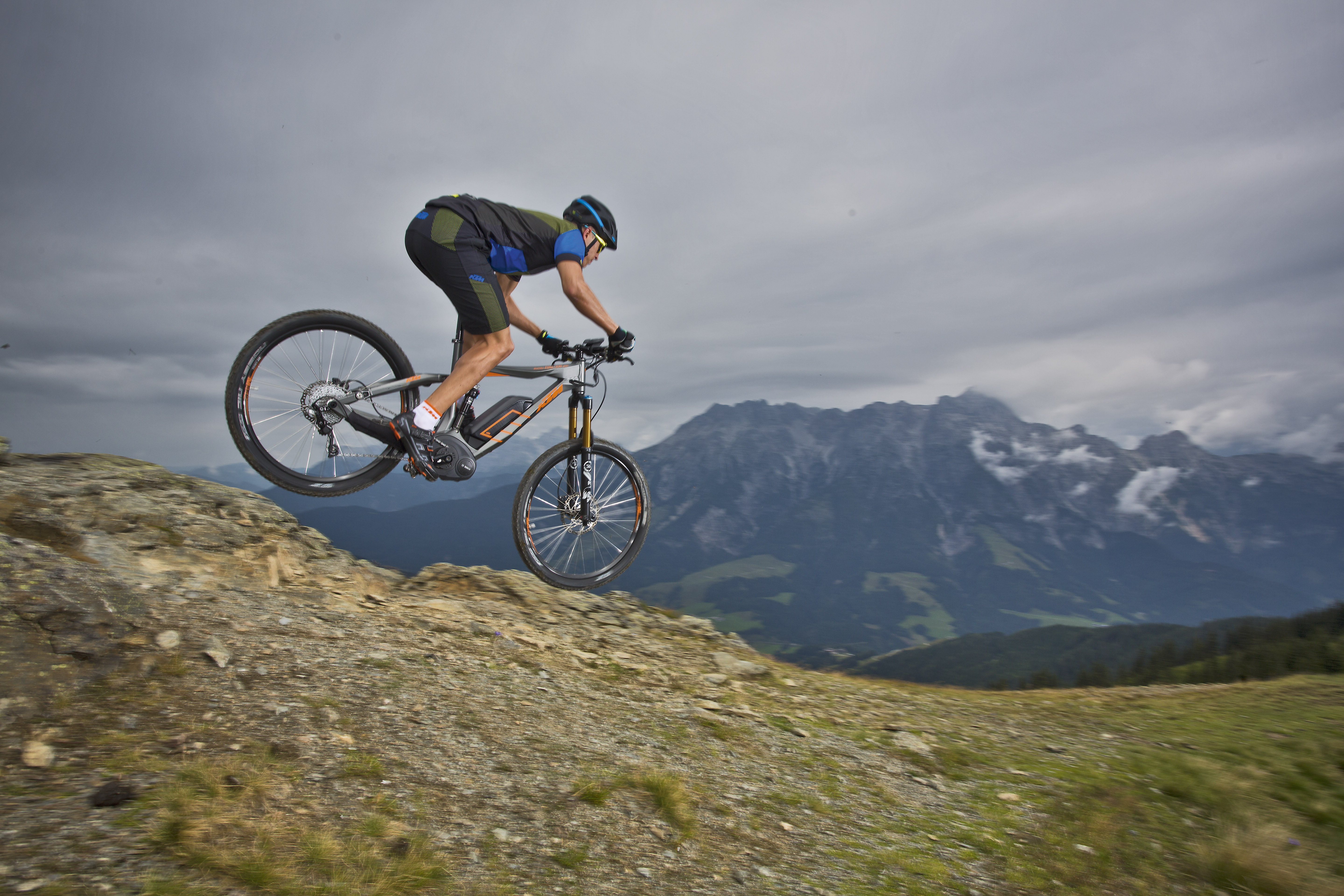

December 15, 201411 yr Haibike Carbon Ultimate. Not exactly a Road bike, but couldn't resist, considering its name! Martin
December 15, 201411 yr Haibike Carbon Ultimate. Not exactly a Road bike, but couldn't resist, considering its name! Martin But no mudguards!
December 15, 201411 yr Haibike Carbon Ultimate. Not exactly a Road bike, but couldn't resist, considering its name! Martin Certainly the ultimate price. Haibike really are taking the wotsit when you realise you can buy a full sus carbon frame for £700. A £750 crank drive kit and battery will blow the Bosch system out of the water. Another grand or so for good quality wheels, tyres, and finishing kit, £500 for forks, and a few hundred for contingency, gives a budget of about £3,250, against the Haibike at £12,000. The £3,250 bike would wipe the floor with the Habike, not least because it would have more power and a decent size battery, or there's plenty of money in the budget for a spare. You could buy a van to take the bike to the trail centre with the £8K+ saving and still have money left over. Edited December 15, 201411 yr by RobF
December 15, 201411 yr Haibike really are taking the wotsit Really, why am I selling them then? In fairness you could only just buy the wheels alone (ones fitted to the Haibike) within that budget. You are comparing a Micra to a Mercedes in respect of the quality of components / build.
December 15, 201411 yr In fairness you could only just buy the wheels alone (ones fitted to the Haibike) within that budget. You are comparing a Micra to a Mercedes in respect of the quality of components / build. Not really. A modern Micra is nicely built, and in any event that would depend on the builder. You and I both know there are people on here who can build to factory quality. As regards the components, many could be identical/superior - fork, tyres, groupset. The wheels is an interesting one, and I like the idea of five spokes if they could be made to ride OK. But a few hundred will get you a top notch wheelset, particularly if it's built by a proper wheel builder.
December 15, 201411 yr In the interests of accuracy. Looks like those trick wheels are about £2,500 to buy retail, and the electronic groupset is another £1K. Adding those to my notional ultimate kit bike would up the parts budget to nearer £5K.
