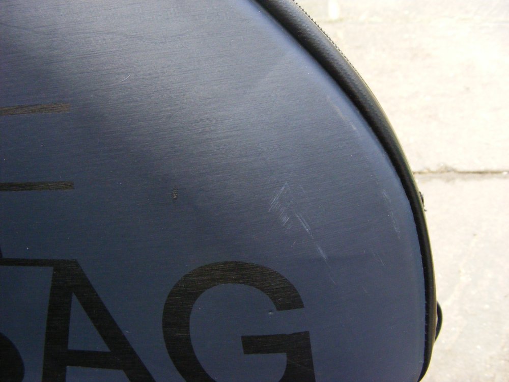

My V2 arrived yesterday, the B - wear (2nd's') had a very slight scuff mark which is barely noticeable otherwise it is brand new, I took a pic so will upload it sometime. Fitted it today and have been arranging batt's to fit, I have reconfigured the 3 x10.4 ah packs now and will use them as 2 x 15.6ah packs plus now I have also got 1 x 13.2ah pack. For now I will continue balance charging until I'm happy with there stability then will look into the possibilities of bulk charging them and see if I'm able to serial them as 12s for charging to speed things up.

Back to the V2 as promised a pic of the slight scuff mark which made this a 2nd's product.

Mine got a bigger,deeper mark than that the first time I used it when it slipped as I put it away in tne garage.
