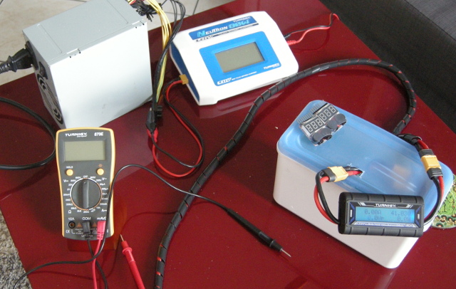

It wasn't easy... But I now have a 38.6 V battery with XT60 plugs :)
I bought the new XT60 plus plugs with integrated insulation and as the advertising says the grip does make de-connection easier. The solder cups are pretty tiny compared to the XT90 which makes them a bit more fiddly until you get the right technique AKA the fourth and final solder... The neutral wire was protected with electricians tape when soldering the + and as the black plastic insulation thingy slid over it I left it on.
Now onto the charger, power supply to finish first.
A hard days work later:
- Battery box is a Skip ultimate washing liquid/powder box which holds the batteries nice and snug and perforation proof in a pannier bag.
- long 10 AWG lead from pannier bag to controller with Watt meter
- the charger is as bad as I imagined for 30€ but managed to charge both batteries from stockage voltage to 41 V in 1 hour 50 minutes at 0.5C not very noisy is its strong point can't set charge cut off to 4.15 V per cell is the weak point or I haven't found the trick yet in the instructions
- the controller and Li-Ion bottle battery lead also go XT60 plugs so I can switch between the two batteries (cutting the soldered lead off the controller got me sparks - the condensers hold charge for over 24 hours you fool! :oops:)
I only burnt two fingers with the soldering iron! :eek: TOP TIP: I haven't soldered in a very long time and it took a while to figure that there has to be a pool of solder on the iron to heat the XT60 cups quickly. Now that I know I don't have any more to solder... I destroyed one XT60 plug with the soldering iron (out of 10) :cool:
