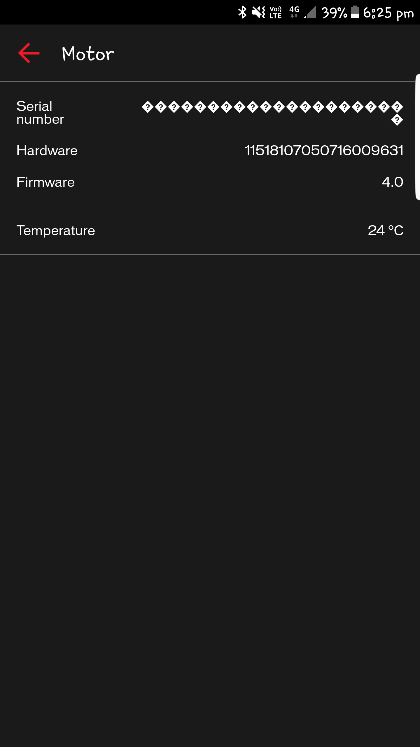

Mine did the same thing, motor cut out after 13 km from new. I unplugged the battery cable for 5 mins. plugged it back in and it all worked again, but not in mission control all my motor serial number looks like this ??????? see pic attached.

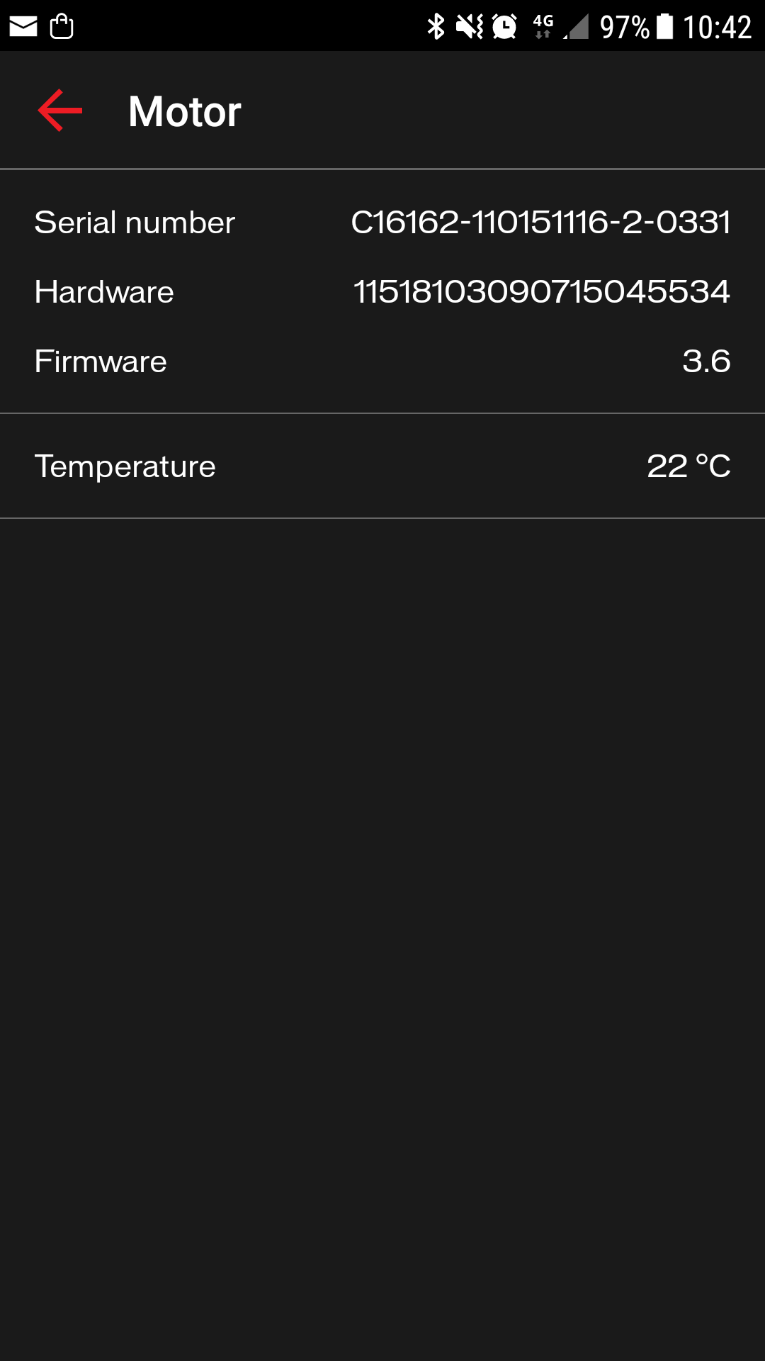

My levo turbo, build 2016 but almost unused. Just charged last night for first time after about 30kms assisted riding, and this morning no drive. Lights on, full information on android app. No assistance. Will take it to dealers today. My software version looks old, 3.x, compared to other users. Disappointed!
