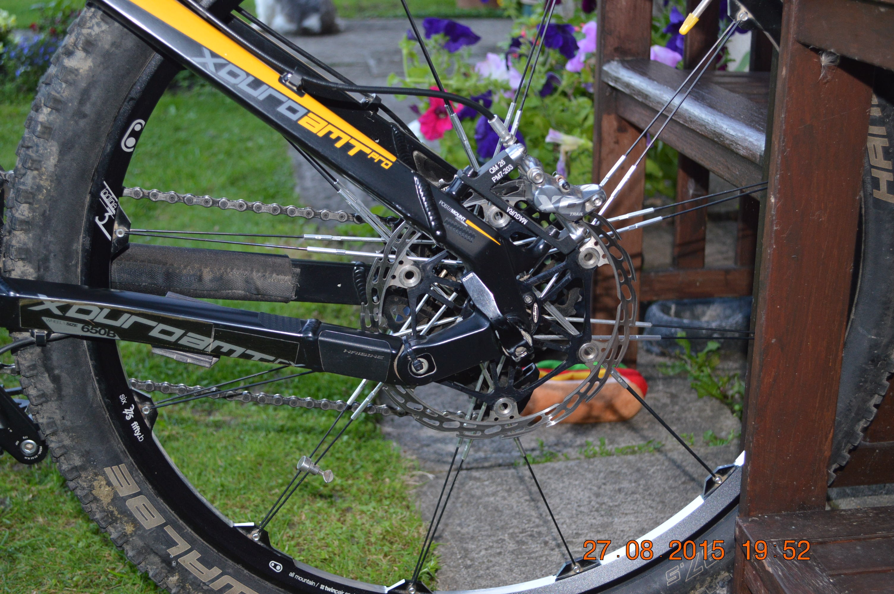

Hubs had just bought some better brakes, Zee's and I've got some sintered pads. His haven't come as yet, but my new pads are fantastic, stop really well and my the squealing has stopped. May get some floating discs next. Got them from uberbike.
