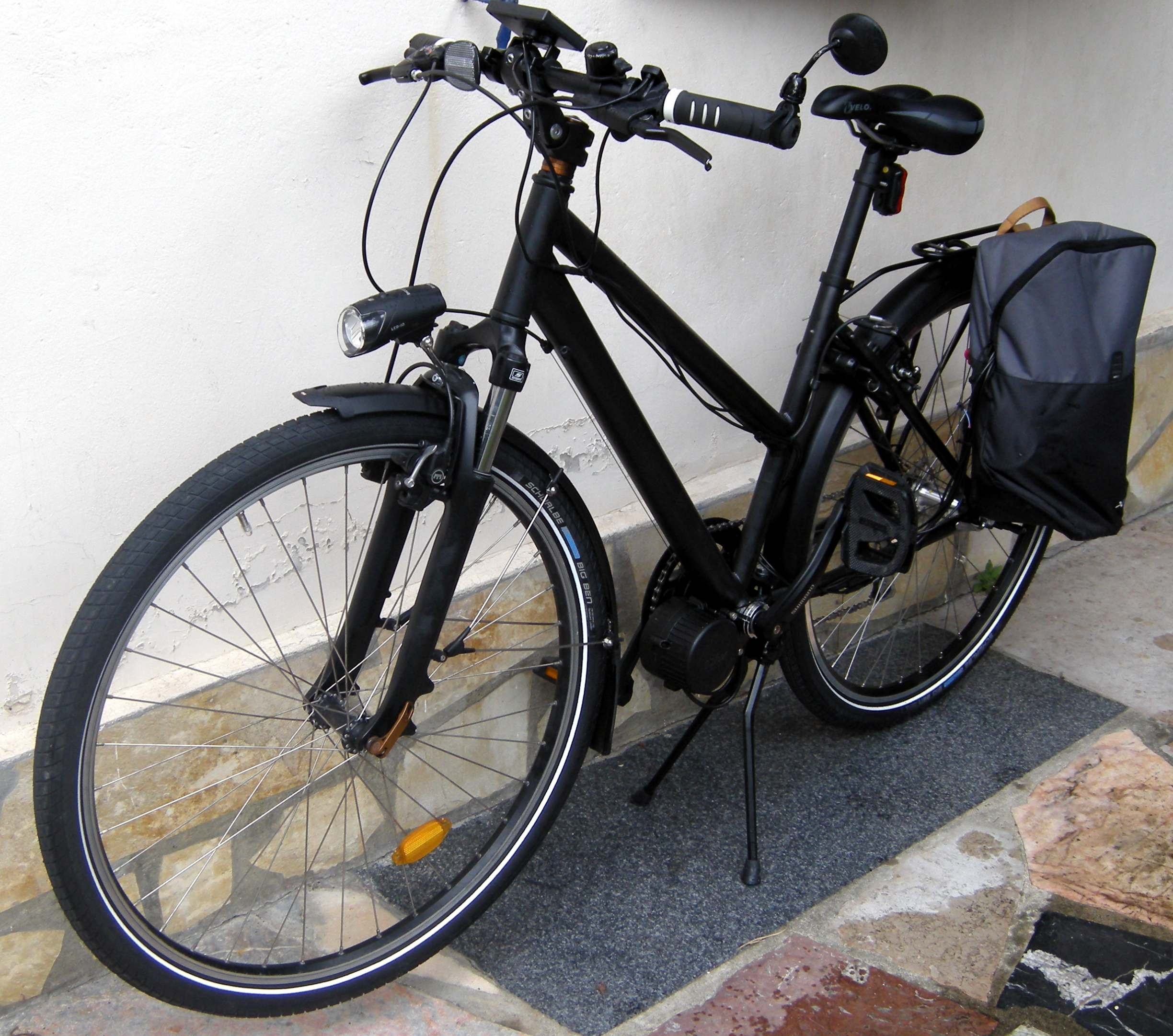

January 19, 20188 yr An attic bike (8 years unloved by previous owner), rear hub motor kit, I added tyres, mudguards, front brake, grips, seat and lock, everything else is stock. 3600km on this one in 12 months: A skip bike found by a mate on his way back from a caté at 2 a.m., mid-motor kit from Woosh, it has over 2000 km on the clock so far. The cables are tidier now and it has a suspension seat post, it was silver and fuchsia ( ) so it got a matt black spray can paint job. The frame, the front fork and the front wheel are stock, everything else is new or from the other bike:
