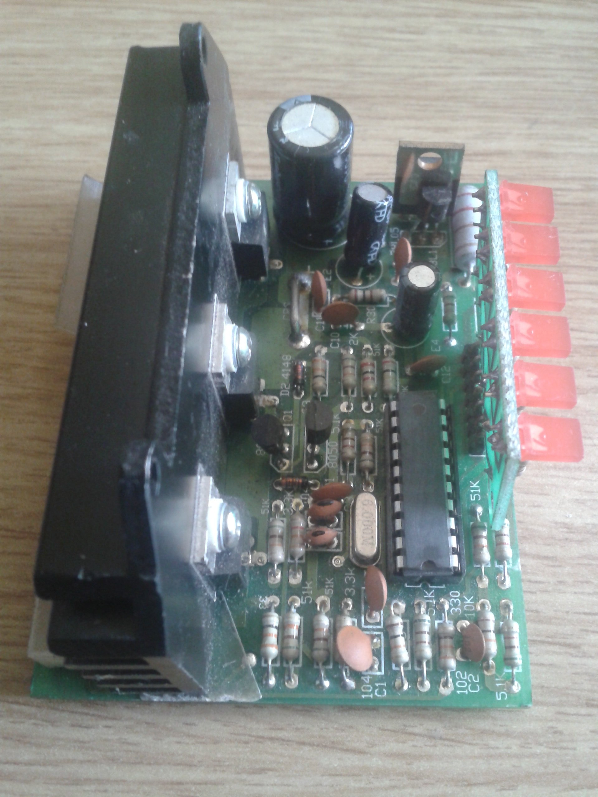

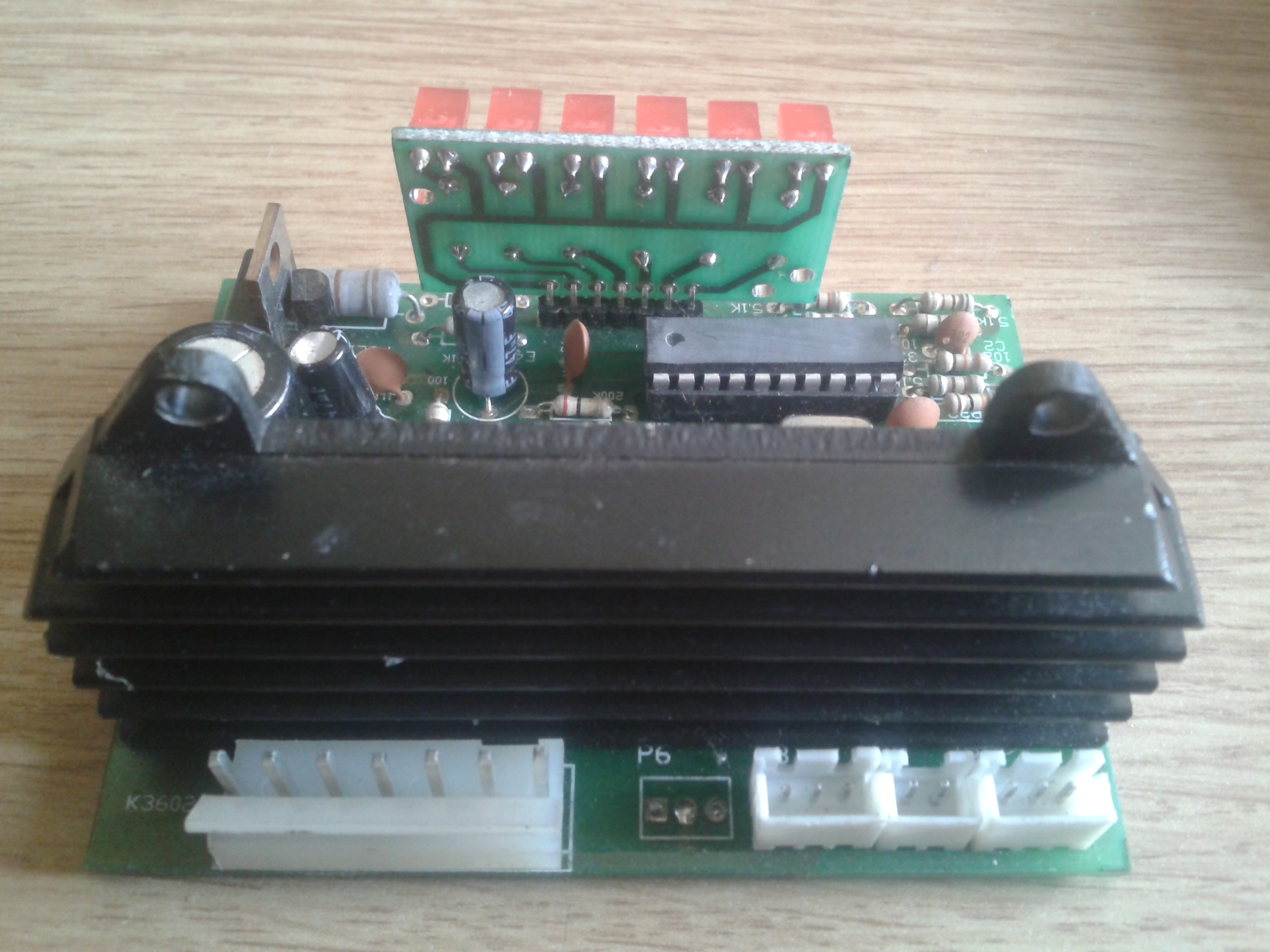

I'm learning towards it being a problem with the controller board. The PCB has the IDs TC213254 and K3603 written on the top, and the label on the controller box says it is a Wistom WST-K3603.
IMG_20180306_163113.thumb.jpg.c6ed2ad1bad49c3358a0be650c77bb97.jpg IMG_20180306_163135.thumb.jpg.47f9bf65592624ef2316db3632116f3d.jpg
I've checked the voltage regulator on the board, which drops 36v down to 15v, and that is working fine. I've checked the MOSFETS and they don't seem to have issue.
However, there are two chips on the board, both of which have helpfully (!) had any identifying details ground from the tops of them.
The main chip is a 20pin DIP which is socketed. It has a crystal oscillator between pins 3 and 4 which when checked with the scope, is not oscillating. When checking the voltage pins of this chip one of them is reporting 1V, which I believe is the power pin. When the chip is unsocketed and the circuit checked again (without the chip in place), the same pad is reporting 3V. Problem could be an internal problem with the IC?
The second chip is an 8pin DIP.
Can anyone could shed any light on the two ICs, or at least an indication of what they are? Might one be a microprocessor and the second a brushless motor driver?
I could get a cheap controller board from eBay, but one of the features of this bike is the assisted pedalling, which I am lead to believe is not available with the cheaper controllers, and which I would like to keep. Is this true? If not, it will be easier to just replace the controller.
Any thoughts or ideas welcome.
Cheers!

The two chips that you asked about are most likely a microprocessor, like a Picaxe 20M2, and a motor interface that switches the mosfets.

I think you're right about the processor/motor interface combo, with the smaller chip being the motor interface IC. I could probably get a generic motor interface IC after working out the pins.
However, I can't identify the micro-processor. PICs have power/ground on PIN1/PIN20. The 20pin chip on the board has power to PIN7 and ground is PIN13/14.

Okay,
So I believe I have managed to get this working in the end.
I had to trace out the schematic, but eventually narrowed the problem down to two things.
1) A dodgy 5V regulator - generating 1.8v. (The controller board has two regulators on board, a 15V and the 5V)
2) A broken 16MHz crystal.
Once these were fixed, I get the 3 lights when I turn the bike on (full battery), and it also passes all of the diagnostics. :)
Just got to reassemble it! It could conceivably still not work, but from testing it on the bench it all seems to be fine.
