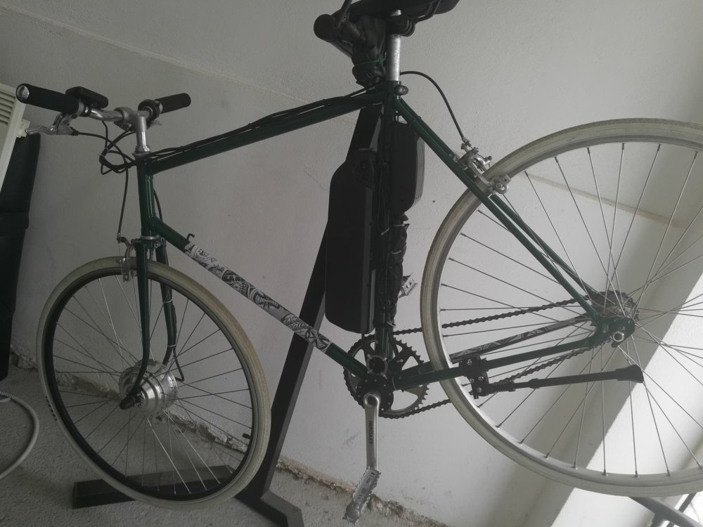

This is my ebike build.
I bought a 36v 250w geared front hub motor kit, with the 36v 10.4ah battery included.
I used a steel frame single speed, because the road bike i had wasn't suitable for the project.

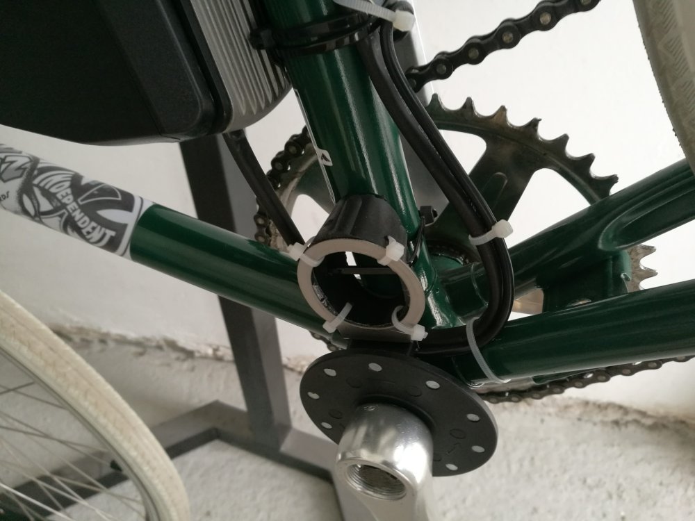

I had a little problem with the PAS ( not enough space for both magnets and sensor in the crankset), but i solved it with a small mod.
For the excess cables i used tyre tubing for protection.
I wanted to make it as clean as possible, what do you think?

Nice job as it looks quite tidy not always easy on a minimalist bike style.
Which hub and controller did you use ?
Edited by Nealh
Thanks, it was hard to hide the cables and i know it is not the best solution to have the controller in a plastic box, but i drilled holes for ventilation. I bought the kit from a local shop, but it didn't have a branding on, just some numbers. SY73626OL0517S1, that's on the motor. The controller is a generic 36v.
Forgot to mention that the bikes weight is now 17.7kg ( before was 10.5kg).
Edited by Vagos

A small suggestion, for aesthetics, remove the pedal sensor from its metal ring. I'm sure you can make or find some part to attach it to the frame and it will look a lot better.
[mention=9614]Nealh[/mention] , yeaaah, the cut out will be facing backwards, so not so much airflow, but i guess better than the closed box...
[mention=10356]anotherkiwi[/mention] , i will use some thermal sticker, but the heatsink wont stay on the controller. I may have to use zipties, or drill a small hole on the controller and bolt the heatsink on.
[mention=19583]Andy-of-Leicester[/mention] , i want to take that ugly thing of, but i have to find an alternative way to fit the sensor.
