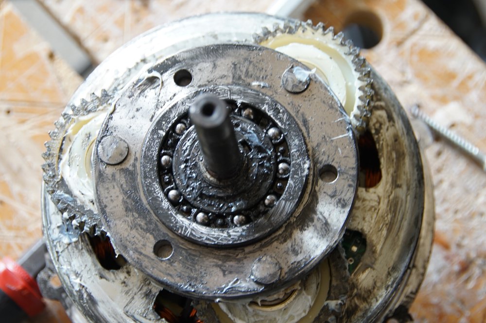

April 26, 2025Apr 26 Well the hub was opened but I couldn't get to any wires that might be loose. I know there is power going to the motor as I tested it when out of the hub. The bike was bought in 2017, question, is the motor kaput.
