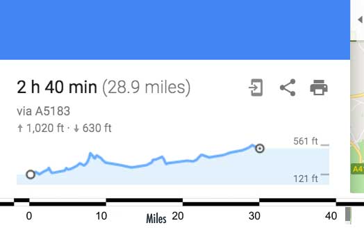

June 21, 20196 yr Hi everyone, I'm thinking of getting an ebike conversion kit for commuting and would like some advice about which one would be the right one for me. first I'll explain my current situation and what I'm hoping to achieve by building my own ebike. I have quite a long commute, 30 miles each way with a couple of steep hills but mostly flat. I currently have a 2016 Haibike Sduro (with the speed limiter removed) and a car and alternate between the two. I would like to cycle more often but find that it takes too long (1 hour 20 to 2 hours depending on conditions and how lazy / tired I am feeling). I have a 36v 14.5AH battery on it. My plan is to get a more powerful bike by adding a motor to an existing MTB and get it classified as a two wheeled vehicle so I can legally do 28mph on it (i'm based in the UK). I would like to be doing 28mph for most of the journey and get my journey time down to just over an hour each way. I'm generally drawn to the Bafang motors, either the BBSHD or BBS02(b). The BBS02 seems attractive because it's slightly lighter but would the BBSHD potentially get me there quicker? Does anyone know which one would be more efficient on that kind of journey? Would i need an enormous battery to do 30 miles in one hour? what would be the optimum sized chain ring for this kind of journey? I'm also a bit unclear about how the pedals integrate with the motor on the Bafang. I'm happy to put in a decent amount of effort with the pedals if it means a quicker journey and a smaller battery. If i was doing top speed would I struggle to pedal fast enough to keep up with the motor? If so would a larger chain ring help to solve that problem? On my Haibike I find that at around 25mph the pedals can't keep up with the motor and I can't contribute much. I'd also consider a hub motor if people thought that was more suitable for this kind of journey. I've attached a diagram showing the elevation of the route taken from google maps. Any advice would be greatly appreciated as I'm finding the whole thing a bit bewildering. Thanks!

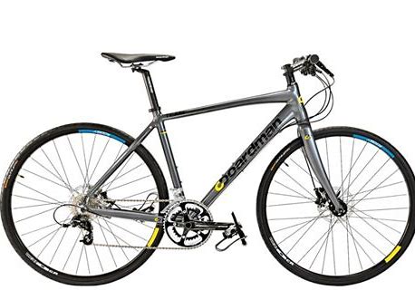

June 26, 20196 yr Wouldn’t converting a road or gravel bike make more sense if you are going all out for speed/range? It will also look less suspicious if you are doing 25mph+ on a racer.
June 26, 20196 yr Author Wouldn’t converting a road or gravel bike make more sense if you are going all out for speed/range? It will also look less suspicious if you are doing 25mph+ on a racer. Yes, I'm thinking if I get a hub motor then that would make more sense. I'm not massively keen on drop handlebars and the last bit of the ride is in the outskirts of London. I feel a lot more in control on an MTB in terms of manoeuvrability, stability and being aware of what's going on around me. It might just be what I'm used to though.. Aeorobars would be another option to improve the aerodynamics although I'm not keen on going at that speed without being in easy reach of the brakes. Edited June 26, 20196 yr by Hilly
June 26, 20196 yr Yes, I'm thinking if I get a hub motor then that would make more sense. I'm not massively keen on drop handlebars and the last bit of the ride is in the outskirts of London. I feel a lot more in control on an MTB in terms of manoeuvrability, stability and being aware of what's going on around me. It might just be what I'm used to though.. Aeorobars would be another option to improve the aerodynamics although I'm not keen on going at that speed with being in easy reach of the brakes. Before I found a used MTB to stick a rear hub in I tried a gravel bike like this: https://whyte.bike/products/glencoe It was a bit more comfortable and stable feeling than proper road bikes I’d briefly tried in the past, while being extremely quick off the mark. You could probably get a similar effect by putting an extra wide handlebar and thick tires on an old road bike. Dammit I’m giving myself ideas now!
June 26, 20196 yr Author Before I found a used MTB to stick a rear hub in I tried a gravel bike like this: https://whyte.bike/products/glencoe It was a bit more comfortable and stable feeling than proper road bikes I’d briefly tried in the past, while being extremely quick off the mark. You could probably get a similar effect by putting an extra wide handlebar and thick tires on an old road bike. Dammit I’m giving myself ideas now! Thanks, I'll look into that. The thing that puts me off is that you can't reach the brakes when your hands are on the top of the bar. I'm sure there's some kind of custom brake levers you can buy that do that.
June 26, 20196 yr Thanks, I'll look into that. The thing that puts me off is that you can't reach the brakes when your hands are on the top of the bar. I'm sure there's some kind of custom brake levers you can buy that do that. Well, that's generally advised anyway (a set of brakes connected directly to the motor to ensure that it also cuts out the motor). Your only challenge would be to how to fit them onto the straight part of the drop handlebar as it'll be wider than the brakes allow
June 26, 20196 yr Thanks, I'll look into that. The thing that puts me off is that you can't reach the brakes when your hands are on the top of the bar. I'm sure there's some kind of custom brake levers you can buy that do that. You ride with your hands on the hoods, where you can reach the brakes and shifters with your fingers. You can get cable brakes with extensions that come along the bars. I have some, but they're terrible. I think a gravel bike with a 48v 328 rpm Q128C rear motor and a 52V battery would give you an acceptable cruising speed, and with a battery with enough charge to go full power all the way (one way), it would still be lighter than your Haibike. The kit with a 52v 17.5Ah battery would weigh about 8kg. Look for a donor with hydraulic discs, which will be much more reliable for long distance commuting. They're a lot more expensive, but worth it. especially when you only have thin tyres and need to have good modulation to prevent skidding. If you go with a direct drive motor and enough current to cruise in the high 20's, you'll need a massive battery, which will push the total weight up to at least 35kg, which will be very awkward to lift up any stairs.
June 26, 20196 yr Author I find the riding position of being bent forward with my head bent up uncomfortable and would prefer to ride in a more upright position in traffic. I guess I could buy the bike and try to get used to it. if I couldn't get used to it I guess there's no reason why I couldn't put a flat bar on it. You ride with your hands on the hoods, where you can reach the brakes and shifters with your fingers. You can get cable brakes with extensions that come along the bars. I have some, but they're terrible. I think a gravel bike with a 48v 328 rpm Q128C rear motor and a 52V battery would give you an acceptable cruising speed, and with a battery with enough charge to go full power all the way (one way), it would still be lighter than your Haibike. The kit with a 52v 17.5Ah battery would weigh about 8kg. Look for a donor with hydraulic discs, which will be much more reliable for long distance commuting. They're a lot more expensive, but worth it. especially when you only have thin tyres and need to have good modulation to prevent skidding. If you go with a direct drive motor and enough current to cruise in the high 20's, you'll need a massive battery, which will push the total weight up to at least 35kg, which will be very awkward to lift up any stairs.
June 26, 20196 yr Author I had a quick google and I'm not sure you can buy those motors in the UK. Mybe they're marketed under a different name? I think a gravel bike with a 48v 328 rpm Q128C rear motor and a 52V battery would give you an acceptable cruising speed, and with a battery with enough charge to go full power all the way (one way), it would still be lighter than your Haibike. The kit with a 52v 17.5Ah battery would weigh about 8kg. Look for a donor with hydraulic discs, which will be much more reliable for long distance commuting. They're a lot more expensive, but worth it. especially when you only have thin tyres and need to have good modulation to prevent skidding.
June 26, 20196 yr Author Do you think this would be suitable? Planet X London Before I found a used MTB to stick a rear hub in I tried a gravel bike like this: https://whyte.bike/products/glencoe It was a bit more comfortable and stable feeling than proper road bikes I’d briefly tried in the past, while being extremely quick off the mark. You could probably get a similar effect by putting an extra wide handlebar and thick tires on an old road bike. Dammit I’m giving myself ideas now!
