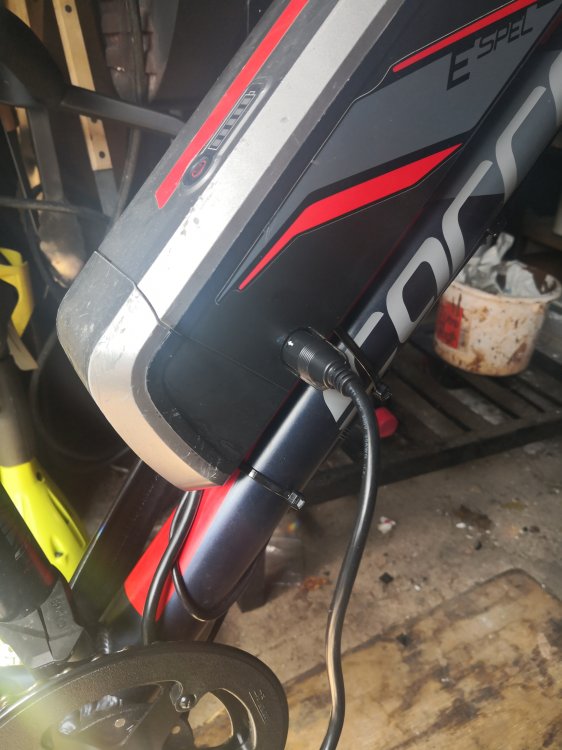

Hi got another issue with the bike i think as you can see i have 5 bars on the battery but if you look at the display i have low battery flashing red is that normal
It's possible. The smart BMS in the battery has two functions. A quick button press shows state of charge: SOC is based on voltage; 5 blue LEDS indicates the voltage is >38v (you could check this with a multimeter in the two end slots - a flat/discharged battery will measure <30v). A long button press shows state of health: SOH is based on usage over time (the BMS tracks the charge cycles/wear on the cells).
If you did a long press, 5-LED's on the battery could show it's healthy but the handle-bar display suggests it's low on charge.
Presumably you can't ride your bike again until you receive a replacement/working charger? Give the battery a full charge and see what happens.
