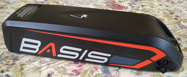

The battery is Lithium Ion 36v 14Ah. Cells listed as sourced from Samsung I haven’t cracked open the box as it’ll void the warranty.
The power button on the battery is a panel push giving remaining capacity in little green bars. The bars extinguish after turning on the pack. The 36v charger port is covered by a rubber plug with a retainer so it doesn’t get lost.
The key locks the battery to the carrier on the bike using a substantial steel peg. Not a bad quality key and comes as a pair in case one is lost.
There isnt a handle on the battery so you’ll need a bag or good grip lugging it around.
Six lugs and the lock post keep the battery on the bike. The fact everything is recessed means a little more protection from dripping water although I’d say some non-conductive grease might be a good idea in the winter to reduce corrosion.
From above the battery is pretty much out of sight because of the chunky frame/crossbar. I always worry about “klacking” my knees on this style of battery but it just sits out of the way when riding.
This battery is far better than the shocking NiMh packs of old. The weight is low when hefting but its just a pain lugging round. It can be charged on the bike. We all live in different areas so I won’t lay claim to immense mileage. Based on my commute over 6 hills daily I would tend towards belief that the flat mileage claim by the manufacturer is possible. For the big battery on my bike e-bikes direct claim 35-50 miles and the smaller 8Ah battery 25-30miles. Having had the experience of a battery wearing below my commute range on previous bikes I plumped with the larger one.
I’m not seeing any real “wear” yet. Being slightly paranoid I always keep a close eye on the charging making sure the pack is not overheating during and for a while after. The charger seems pretty smart and green lights when done. Sounds a bit pathetic but yknow I have a family in the house and 14aH is a fair bit of energy to be pushing around.
